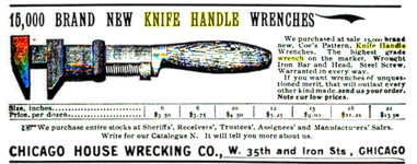

The earliest ad I've found so far on the Coes Knife Handle Wrench is from 1885 (first pic below). The second pic below seems very odd to me. It looks like the Chicago House Wrecking Company bought 15,000 Coes Knife Handle Wrenches from a Sheriff's sale as stated in this ad from 1899. I've never heard of this happening? Anyone know any details on this??

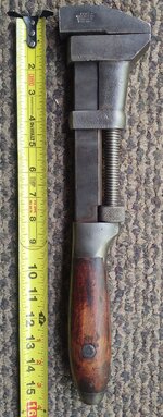

Here's my Coes' Knife Handle Wrench collection:
10" OAL. Everything moves like it should.
I'm wondering how to go about removing some of the rust without screwing up what's left of the handle slabs.

You could buy one in fine condition for less than the effort needed to redo that one.

Ah....don't let it die on rust mountain. Just clean it up at the wire wheel & scrub the heck out of the handle with 0000 steel wool & wipe it down with boiled linseed oil. Just use it as a beater around the shop. You'll be happy you did it when it's finished.

My thought is the same.

Just out of the electrolysis vat w/lye, then a short soak in dilute phos acid. Amazingly, the lye and electrolysis didn't seem to have hurt the already trashed wood flakes much if at all!
Once it cools off, I'll hit it with some 4-0 steel wool to remove the now-loosened surface rust. I think it's going to come out... well... nicer.
****, it's at least 100 years old!

Awesome! Another oldie saved from the rust pile 👍

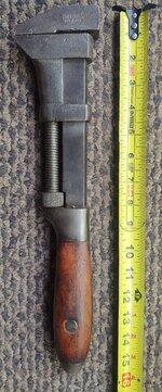

Out of the 'vat and phos bath, an absolutely onerous few minutes of steel-wooling:
The phrase "Rode hard and put up wet" was coined to describe this poor old wrench, but it still deserves some loving'.
I paid about... nothing for it. With my hard physical effort and expensive chemicals, it's now worth maybe five bucks.
When the wood is fully dry--tomorrow evening?--I'll hit it all with some BLO and call it good.
