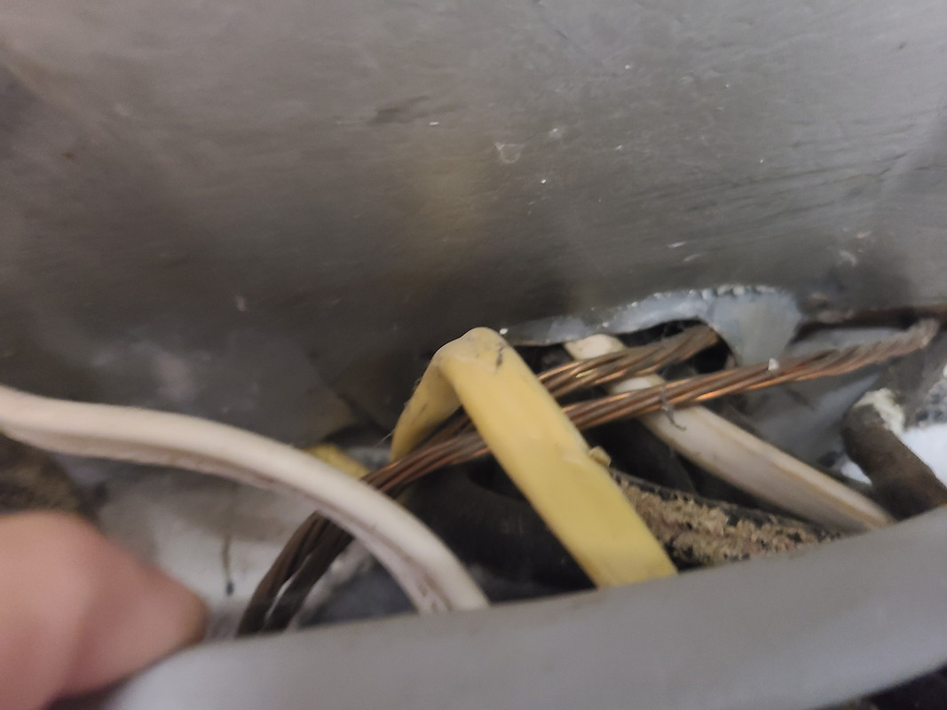

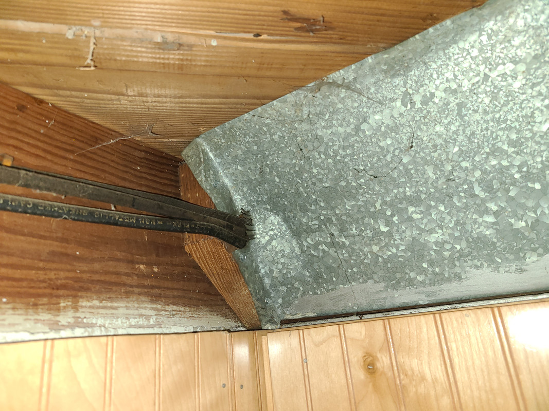

Should I be concerned about the sheet metal for my cold air ductwork being on my wire insulation. Probably been that way for 70 years but at the same time we might be selling soon and if I could replace this section of ductwork with something nonconductive to make it look less terrifying I would.

Its bad enough with the jagged edge touching those wires, But those wire should not be in the cold air return. To do it right, you would have to remove the sheet metal and box around the wires with wood, and reinstall the metal. Then the wires would be out of the cold air return. That's assuming the wires go straight up. If they are running the length of it, your looking at rewiring it. Was it like that when you bought the house or did this happen since you have been there. Possibly wait and see in anyone catches it on a inspection.

We have lived here for 11 years...I have never touched any wiring in the house. Someone upgraded the box (from fuses) and replaced some wiring but the fusebox was in the same location and the house is 72 years old. Most of the wires go straight through that return (perpendicular) coming out the joist and running to the other side of the house through joist after joist. This return ends at the midpoint of the house where it turns into normal galvanized ductwork and I can see that three ancient wires do run parallel inside it.

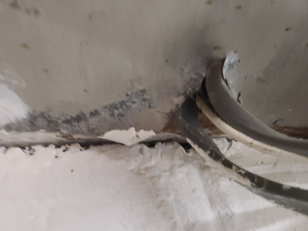

the real issue I see is that ragged metal against the wires.

I agree with Cobbler the real issue is those ragged edges against the wires. I would at at least open up those holes and put some tape on the metal to keep it from touching the wires.

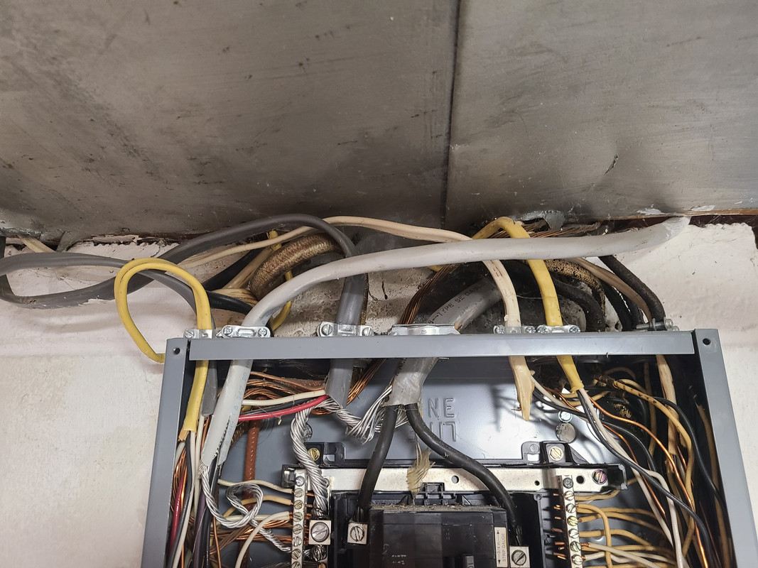

i think it would be a lot easier to change that sheeting than to change the wires. You could remove the section of sheeting in front of the electrical panel and then cap both ends of the sheeting in the joist space and then tap a 6" round jumper duct in the bottom of the two sections and run it out around the the electrical panel. that would get the majority of the wires out of the duct.

Can you post pics of the sub....or is that the main?

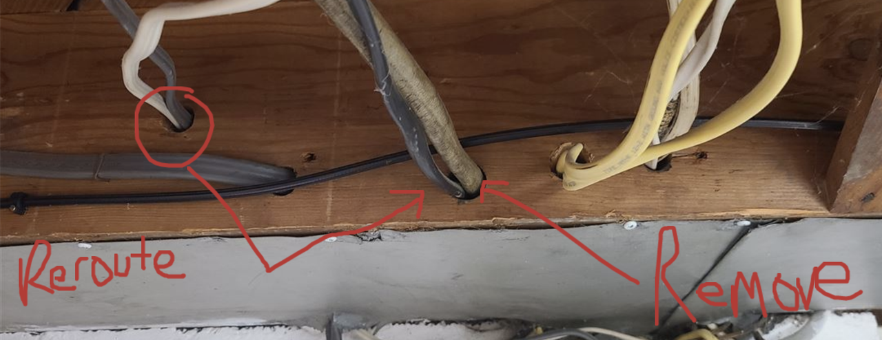

I have a 220V stove line that terminates under the kitchen (gas range) that I'm cutting out to free up box space for a generator interlock breaker. If I remove that stove wire and reroute the two wires that are high in the joist (pic) I could then run a 6" duct above all the wires. This eliminates all jagged metal to wire combinations as well as the three wires that are ran down the return....although I would need input on if I can have wires cross under the 6" duct.

Check with your local jurisdiction. some allow you to cross inside a return air and some do not. For the ones that don't let you, we put a short length of conduit on the outside bottom for a sleeve. In your case, you would have to remove the wires. 90 up from the panel with conduit and go across the bottom of the return air, put the wires back in the sleeves, after that the wires can run through the joists. I know it would be a lot of work, but really no other way

If I can get by with doing a small duct and going above the wires it might be the easiest path.
