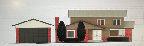

Size will be 22' wide by 44' deep (exterior dimensions) with 12' tall walls. There will be a 6"x6" curb under the 2x6 walls. A good amount of rebar specified by the engineer as well as what I told him I wanted in the rear half of the garage for the future 2-post lift. I matched the Bendpak concrete specs for the floor specs for thickness, strength, and rebar.
I plan to have 2" foam around the perimeter of the foundation that will be covered and protected. No foam under the slab. I also want to add 1" rigid foam to the exterior of the walls underneath the siding but over the OSB sheathing.
Here's the front view with an 18' x 10' garage door:
And with an 18'x9' door:
Leaning towards the 10' partially because it's bigger but mostly the space above the door doesn't look so large. The top row of the door will have obscure glass windows in it as well so not all totally black. House colors are wrong, existing house is more the white color that is on the garage.

Looks like a great design for useful space! The front of the future garage will be a little forward of the current fence?

Yes the front of the garage will be at the front of the chimney on the house. Roughly 6-8’ forward of the current fence line.

Hey there neighbor. I didn’t want to go higher so it still looks reasonable next to the house. Fair point that bigger is better!
I can see that for a rear door if I wanted to drive things through but the 6x8 door is my only normal man-entrance type door so can’t switch it to a garage door.

why 22 setbacks? even 24 i find a little narrow with 2 rucks/suvs although it is roiomy when my sons or daughters small ehicles in there.

22' wide is what fits on the side of the house while maintaining the 5' setback to the property line. HOA (and my wife) want it up next to the house and not taking up the whole backyard space. My wife will have parking in the attached garage and this one will be all mine. Truck parked in the front half and room enough for my other car and one more easy.
