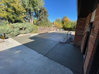

Slab pour day! Quite happy so far. It looks like they got the slope to the drain pretty well and the driveway apron is nice and gradual. The floor sloping to they drain is about 1/4” per foot. I should have about 2’ up against the walls in the front where it’s flat and not sloped.
Started at 7am, compacted, vapor barrier, rebar, and dowels done and ready to pour by 9am.
Pump and concrete showed up at 11am.
All poured by 12:30. Then a break before starting to finish. I was a high of about 53 F today late until he afternoon so nice and cool.
And done:
