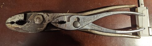

Linesman, Bernard parallel jaw, or a big @$$ pair of slip joints 10” long, depending on what I’m pulling. Most linesman pliers have a gap in the jaws the width of a fish tape, they don’t go to zero. The Bernard’s go to zero, won’t get the major grunt work. My 10” slip joint pliers have a large grip, better tug than linesman pliers. Note the handle flare
Shown here Pexto 17N Heavy Combination Slip Joint pliers compared to Diamond regular slip joint pliers

No one seems to care much for them these days but I'll vote for the 10" slip joints (from a quality manufacturer such as Wilde). I carried a pair at work for years as my personal no touch tool, hammer, and grabber of random things.

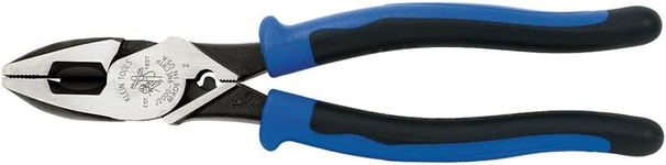

Some models of lineman pliers have a notch for clamping and pulling fish tape.
This is the answer. Everyone is talking about staples, but if the OP wants to pull cable, these are the ones to do it. Generally I push cable, with fiberglass rods, but Klein J2000-9NECRTP pliers are perfect for grabbing metal fish-tape, and cutting/bending ceiling grid suspension wire, which can slash your arms.
