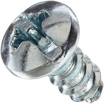

Why are these types of machine screws so relevant? It is used on so many different types of common machines, and in some cases critical torque fastening applications. The primary drive is always slotted, then followed by a headache inducing combination of Phillips, Pozidriv, square, or hex. I believe the convenience factor of being able to use two different drivers is far surpassed by the inconvenience of removing these screws when stripped.
Is there anyone on the forum that prefers these to the normal screws?

I absolutely despise those things. They generally seem to be made from cardboard, paste and just enough metal to give them a silver coloration. Every one I have ever dealt with seemed to strip out instantly.

If you use a Robertson screwdriver, it grips those screws hard, and usually without fail. These screws are extremely common with electrical (building) work.
The screws that I hate are slotted screws.

Agreed terrible. My least favorite place to find them is on circuit breakers, 1) I need to get this connection tight 2) I really really don't want to strip it out, especially when it's bolt in breakers.

Breakers, especially SquareD Homeline, are usually slotted/robertson only. I lost count how many people used a phillips and stripped out the lug..

Biggest problem most people have is using a Square screwdriver bit in a Robertson. Robertson's have a taper that the squares don't.

A lot of different screw heads over the years have been developed primarily to make the assembly process, where they use dedicated power heads attached to robots, go faster and more reliably. That "combo" design is going to tend to locate the driver exactly where it needs to go...AND give an edge for the "flat" part of the driver to bite into for easier torque application.
They aren't really as worried about the guy who has to take it apart later. Also...I'd point out that cheap screws come in all flavors. I've had MANY phillips screws packaged with household goods over the years that I had to replace in order to put up the shelf or vinyl shutter or whatever, because they were Grade 2 or worse.
On the pro vs con on slotted screws...If you think about taking out a slotted screw with a standard flat bladed screw driver...there is no problem whatsoever. If you think about taking one out with a drill/driver with a flat bladed tip...they are a complete PIA because it's hard to keep the bit centered in the slot. That's the perfect example of what I'm talking about with automated assembly. A robot would **** at driving a slotted screw...or at least it would be much harder to design and build one to drive them reliably.

My experience is that the screw pictured in post #1 is not how a breaker lug works. I use a square drive on newer breakers and pretty much a phillips on the other. the thing is, the phillips must be the right size and new, not worn. For torquing I use a flat screw driver.

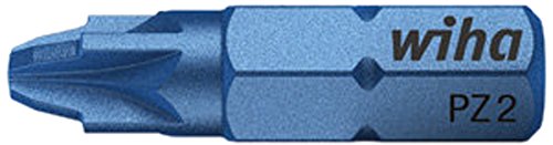

Recently I went looking for the bits pictured for screws that you will find on devices like switches, etc. HD didn't seem to have any but I should have looked more closely in the elec tool cabinet.

I've been dealing with equipment that uses Pozi-slotted (made in Europe), and had to buy a Pozi screwdriver for the job, because the Philips was making a mess of things.

I discovered that Ikea uses Posi screws and bought a set of bits. It made the installation of several cabinet sets much easier. I had been trying to use Phillips bits, and stripping out the heads.
By reading posts here on GJ, I found out that Japanese "Phillips" bits don't come to a sharp point like real Phillips bits. Now I grind the tip off my Phillips bits and they work on both American and Oriental screws. I don't believe that I am sacrificing any torque capacity, as the part removed is at the center of the screw, and can't contribute much torque. Another advantage is a little dirt in the bottom of the recess no longer keeps the driver from fully engaging the driving slots.

Yes, IKEA is pozi.
A blunted Philips fits in a JIS screw better than a regular Philips, but a real JIS is much better.

I hate combination screws much less since I bought a pair of Klein combination screwdrivers at Home Depot. They really work very well on receptical, panel, conduit and lug screws. They fit tighter than a new girlfriend and flat out work.

The one I can't stand is whatever those Chinese wood screw makers put in place of about 1/3 of the screws in a box... you're going along, and here comes this semi-phillips, semi-robertson, semi square screw head that is not only GUARANTEED to wallow out, it ruins the #2 bit you're using.
I went through a box of deck screws (long, boring process!) and pulled out these manufactured defects (probably closer to half the box)... and didn't ruin another #2 bit from that box. Now I check them before I use them (another f***ing waste of time) and throw out the ones that are fubar. Again, it's like I get 2/3 of a box, but my driver bits went from being POS's to relatively durable.
THAT'S what I miss about made in the USA. NEVER used to have issues like this. People think the "Oriental imported" stuff is cheaper, but when you only use the usable stuff (which is usually barely that) it's more expensive.

I dont see what the big deal is. Combination screws exist for mass assembly, when assembled horizontally they help the driver bit grip the screw a bit better. Most folks otherwise would never get the real benefit of that extra 10% of screw-bit retension, but the guy trying to poke 10k of them in the appropriate holes sure does, it prevents him from dropping ** screws/shift. Realistically, for most folks theres no need for special drivers, I use a standard Robertson bit when working on electrical enclosures where these are popular. As mentioned, just be sure you dont use a Phillips bc that will NOT work too well.

I buy the combination Robertson (square) and Phillips at any local hardware store ONLY because they're easier to find than dedicated square. I ONLY use the square and the screws seem fine. IOW square does not seem to suffer from adding Phillips, but I imagine the Phillips suffers from the big square hole in the center.
