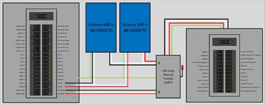

This Pic from a user on diysolar shows what I'm thinking, I'm just planning on a single inverter and 120v

If you're sure how many circuits you want to back up (don't want to add any in the future), these units from Reliance Controls perform that function all-in-one. Unless you don't want to individually switch each load. Just connect the inverter via the generator connection. Integrates the function of the transfer switch and subpanel.
https://www.reliancecontrols.com/products/category/pro-tran-transfer-switches/8
No, that won't work. The inverters cut over automatically when power is lost, so tying it into the generator input will make it a manual cutover
The circuits in the Pro/Tran transfer box would normally be set to generator(inverter) feed. Analogous to the "A" position the 100 Amp Manual Transfer Switch in your diagram.
Ah, I got you now, my bad. Yes, that's a good idea..
I was planning to use a homeline sub so I can reuse all the breakers in my current panels. I'll have to see how it all compares on cost and sizing. One panel would be great

Mike - I thought I saw that some of the Victron units have generator input in addition to grid input along with battery. It’s smarts then select the input to use. 🤷‍♂️.
Yes, they do. The goal with this transfer switch is to be able to take the victron out of the system entirely. Thinking about a failure on the inverter or something needs to be worked on, and I don't want to take the critical circuits down
