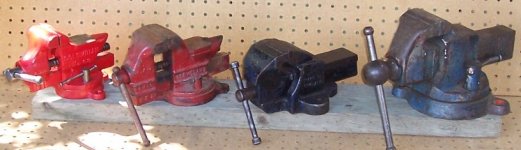

I have a decent selection of different levels of 3" vises, and thought this would be a good way to show the differences between the homeowner/mechanic level vise and higher end machinist's vises. (The question comes up often enough)
The candidates for this were:
Columbian No. 63 Red Arrow - 10 lbs (Swivel base)
Columbian No C43 - 13.5 lbs (Swivel base)
Woden (England) 186-b/1 - 14 lbs (Fixed base)
Rock Island No, 571 - 29 Lbs (Swivel base), 23 lbs (W/O the Swivel base)
The real noticeable differences are in weight, but the visible differences are also very noticeable when placed side by side.
The small difference in weight is very noticeable from the No. 63 and the C43 Columbians, only 3.5 lbs, but that is also 35% more steel available:
I would rate these as light duty and med/light duty, suitable for mounting on a roller tool box or work station but should only be used for light stuff on a bench. (The No 63 is the "Zombie Vise" :D I documented the repair of in the Vises thread. It had been broken, brazed, then broken again, before being left to rust in a shed...)
The Machinist vises I would rate as medium and medium heavy duty vises; to get into the heavy duty class I think you need a minimum of a 4" machinist, and better if it is even bigger for real heavy work. (If you want to be pounding on it to say, bend metal, get a blacksmith post vise...) But I think either of these would do the average Joe life long bench service if not abused past their considerable capacity.
I would have liked to have done this at 4" or even 4-1/2" jaw widths, but I don't have that wide a selection of that size of vises, but I think this 3" selection is still very illustrative.

You know, there are a few different things that never get talked about when considering vises.
One thing is the beefiness and size of the jaws themselves. Of jaw widths the same, some jaws are twice or more as thick as others. I presume that this could be accounted for if you took weight into the "desirability" of a vise.
Another thing is the profile height of a vise. The 3.5" Wilton bullet I have sits with a low working height. I can get over the top of the vise a easier than a few other I have. It simply takes up less real estate and can be worked around easier.
The shape of the top of the jaws also mades a difference in how it's used. Ive got a Craftsman columbian clone, and when the jaws are together, it's pretty flat on top, making it amenable to some hammering - while the Parker vise is angled.
Lastly, I do prefer rectangular slide vises with covered screws the most. Sometimes, its just nice to have a flat surface to rest things on.

All true and worthy of consideration; a look at some of the patternmaker/sheetmetal vises, and gunsmith vises just to name two, shows how use affects vise design/construction.
I noticed the Wodem has a Wilton bullet-like profile for height, if not shape. even if you added a swivel base, unless you got crazy with it, it would be very low profile.
Also, as was noted, the design of the jaw to slide interface gives the Woden vise great strength in that area. To stress risers in the design, and a lot of beef up to near where the slide enter the static base.
Compare that to the tow smaller vises and the pressed interface between the slide and the Jaw proper. which is exactly where the smallest Columbian I repaired failed, twice!
