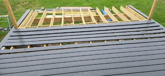

I am attempting to frame a timbertech composite deck. I am trying to design the frame so that it will support the picture framed boards along the perimeter.
All the instructions and videos I have seen show the picture frame boards being mitered and installed first, and then the infill boards being installed one at a time and then ‘magically’ the last infill board fits perfectly without having to rip it to width.
How to I design the width of my deck so that last board will fit perfectly within the gap in the picture frame? Are these composite boards so perfect that I can measure to a specific width and know that the last board will just fit without having to rip it to width?

It isn't 'magic'. It's usually a lot of pre-planning. Say your deck boards are 5.5"W + 1/8" gap, so your spacing of your "picture frame" (facias) is some multiple of 5-5/8" plus an additional 1/8". No "magic" to it.
Presuming you have gaps between the deck boards and you've sized your picture frame span correctly to accommodate those gaps, if it then still didn't work our you would need to fudge the spacing a little bit to make it work out. Before fixing the deck boards in place.
Similar with masonry / brick / tile laying or any other repeating pattern effort, you plan your dimensioning beforehand. And you dry fit before you commit, to make sure things will work out.

maybe pictures will help. i built this long skinny deck and two very small ones last summer for a good clients son. i build a few for his other son a few years ago. i am a commercial carpentry contractor but sometimes take on other projects to change it up a little and also to stay working in town.
ripping composite decking will not look good. first step is to decide your overhang, i use one inch. that being said a set of double joists will need to be added at the ends. you will never catch both edge board and field boards on a single because a spacer screw clip is needed in between. the clip does not hold the end of the field boards so one side is cut off. tin snips will work. cut and miter your picture frame boards first and hand tack them with regular finish nails for now, screw the outside edges off later on. you then work back toward the house. full board on the outside. your framing must be figured out ahead of time. or you can leave the joists long, tack your end deck boards, run 3/4 of the field decking, then finish your framing.
few tips.
its easier to grow your courses than to shrink them.
check your courses in a several places every few boards.
check your courses from where your going not where you came from.
its easier to install your posts before decking-you can get in there easier.
one sided planks are available but i never saw them at any big box stores.

First, definitely design/plan out your deck so everything fits the way it should, with the proper gapping in between boards. For your last board, plan out how much overhang you want to have on the last board. I think I did something like 1/2" or 1" as mentioned above.
Then when building, I put in the first two boards which were part of the mitered picture frame, and then installed every successive board in the middle, making sure that your end cuts (length cuts) are square to where they need to be, and obviously the right length.
What I found out is that no matter how tight you try to place all the boards and clips (so they meet exactly the 1/8" gap or whatever your clip may be), sometimes you might be off just a hair, say like 1/32". Sometimes it's human error on installing the clip or screw, or sometimes it's just how the wood reacts (for example, if you suddenly hit a small knot and your screw deviates just slightly). Well, when you add up all those deviations, you realize that your deck doesn't exactly fit your frame exactly to the T as you designed it. This is where having a little bit of hidden flexibility in the overhang of your last board is where you can hide the excess.
Note, because of these slight deviations, you want to make sure that you don't go too far off linear and you suddenly have a bunch of curved boards, and it gets much worse (much more curved) the more boards you put down. Make sure you keep everything aligned and straight...
So when I got to the end, I put in my last two 45 deg mitered boards and whatever excess deviation on the last board was just now part of the overhang on the frame. Now that all the parallel boards are in, measure for your mitered side boards and install.
Remember that by building from one side to the other and then building out the sides of the picture frame, you can maximize the usage of the clips (which are pretty much hidden) and minimize the use of screws on the face of the board. Make sure you purchase a bag of plugs for all of the screws you do end up needing to use on the face. TAKE THE TIME to sort out every single plug into groups - I separated them into no grain line, 1 grain line, and 2 grain lines. Then when installing the plugs into the boards, try to match not only the direction of the grain but the number of grain lines in that area. If you take the extra 10 seconds, you can really do a good job of hiding all of the face-screws.
