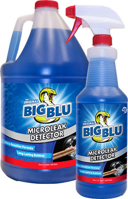

I just found out about this stuff and gave it a try. It works much better than soap and water. It's slightly viscous and a bit slimy which creates a nice film over whatever your checking for leaks instead of quickly running off like soap and water tends to do.
Big Blu leak detector
Megabubble is good stuff too
