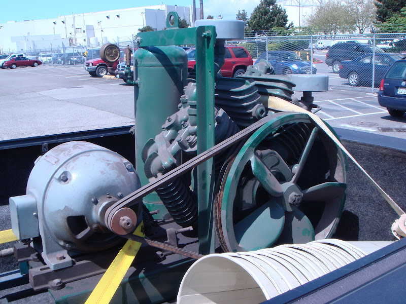

Here's my latest accquisition -- a Wayne 6550, with a 7.5hp 3-phase motor. Not quite sure what I will do with it yet...

Nope. I may try to run it from my 5hp single phase farm duty motor at a reduced speed, but have been unable to find a minimum RPM spec (or any specs, for that matter). It will likely collect dust until I find a bigger motor. But the price was right...
