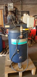

Picked this up for $150 today. 5HP, 230 Volts single phase, AMP compressor. Got to fire it up...couldn't plug it in but it was in really good shape. I figured I can't go too wrong here but I am optimistic it will work fine.
