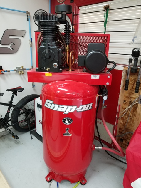

Does anyone have any information on this compressor? It says Air Source/Snap-On model S340V. Tank manufactured in 1991. I contacted Snap-On and they said it was manufactured by Dee-Blast and discontinued in 1998, but that was the only information they had on it. I'm mostly looking for pump info (CFM, oil capacity, model so I can find parts if needed).
Dee Blast is still doing business and have a website...did you check with them?

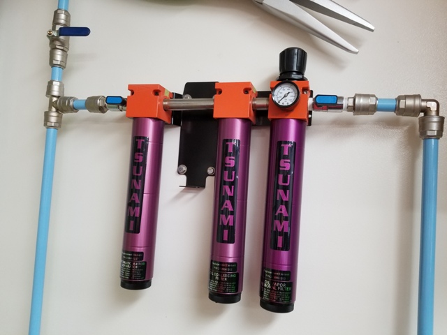

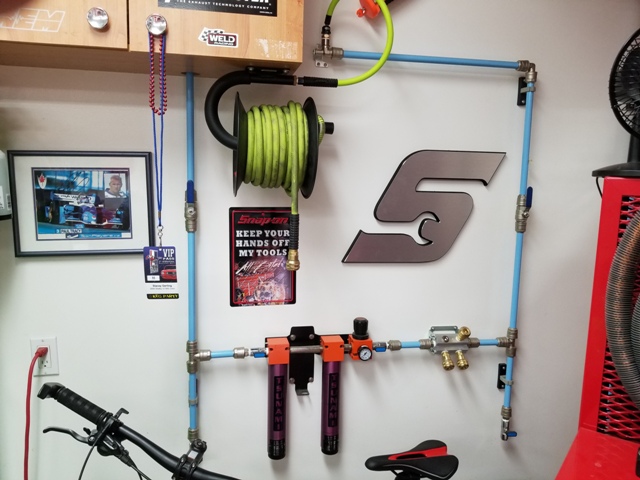

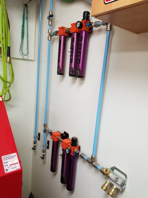

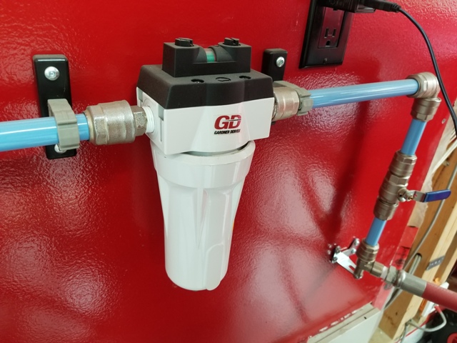

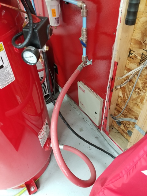

I have had my system set up for awhile now, and it's working out good... Went with Infinity 3/4 aluminum pipe and fittings...
There is a main shut off at the beginning of the system,
Pre filter,

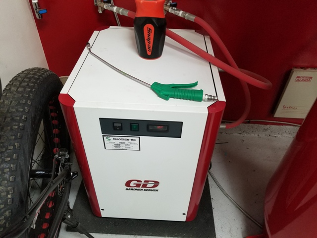

From the pre filter to an air dryer,

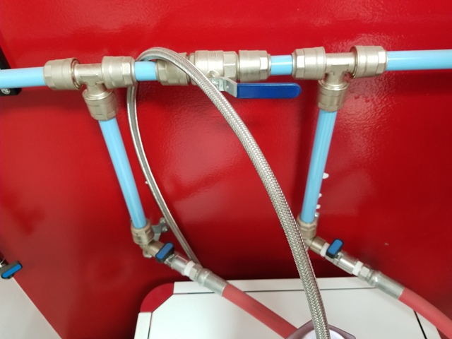

I plumbed the dryer with a direct bypass,
The first drop comes thru the cupboard!! I use it for air tools, and the blow gun...

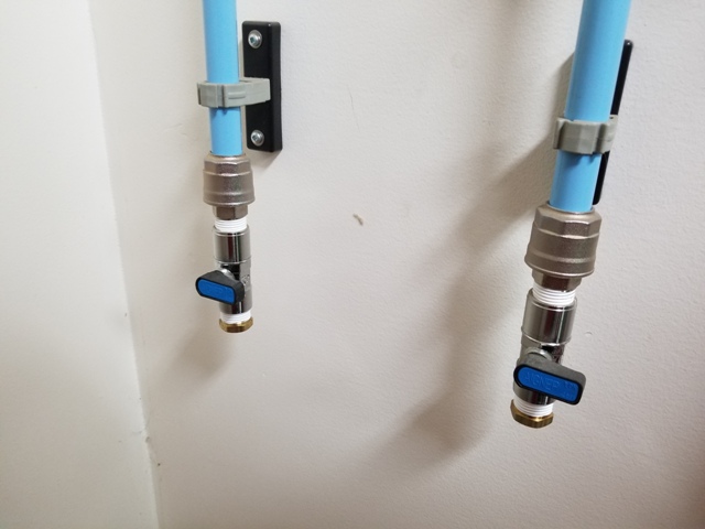

Second drop... I was originally going to do three drops, but only really needed two in the end, so I decided to build a redundant system!! Ok, my buddy suggested it...
This drop is for sandblasting and painting,
Filter system is rated Grade D breathable air, maybe a little over kill for a home garage... Kidding, no such thing!!

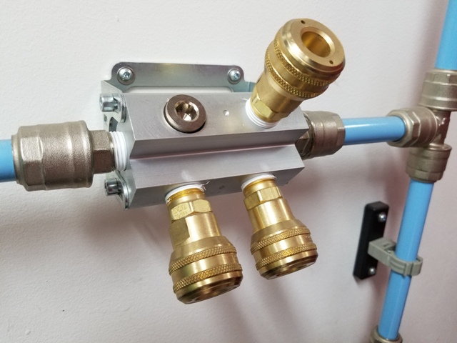

Manifolds, with Eaton 3/8 couplers,
Drain legs on every drop,
Schulz pump maybe?
I think Air Source is no longer in business but they used primarily Schulz pumps. The physical appearance of the pump in the pic looks like a Schulz. Schulz pumps are made in Brazil and they have a US sales office in the Atlanta area. Their web site has a bunch of various downloads available for different pumps showing parts breakdowns. You might have to contact them to find out which pump you have in order to get the right parts info.
The Schulz pump is likely far superior to any of the far east imports on the compressors Snap On is peddling today.
Thanks. I contacted Schulz, and it looks like it may be a MSV10SA. I discovered that the tank had a pinhole in the bottom, so I just transferred the pump to an older 60 gallon CH tank.

any info on the eaton couplers? part # specs., where purchased?
thanks
