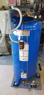

I am nearly complete with the build of my new shop. Today I finished moving my Quincy compressor from it's temporary spot into the new "compressor closet" which is shared with a blast cabinet and my parts washer. I also finished installing the regulators and hose reel today. I have separate regulators for the main outlet, the blast cabinet, the plasma cutter, and one by the front shop door. All have easy to read 4" gauges and Wilkerson regulators. Also put in an outside port for the aftercooler and automatic bottom tank drain so condensate drains outside.

Lu-Max looks great. It's a nice clean install. I wonder where you found the 4" gauges. I've been looking, but haven't found any that big.

The 4" glycerin filled gauges I used are 3 Winters model number PFQ742, and 1 Valley Industries 4240GXB160 (Northern Tool 53751). I scrounged and found good deals on all of them. Also, they all come with big air bubbles, I topped off the glycerin using a small funnel and a bottle of glycerin.
Lu-Max -
What AKG aftercooler did you use? Pictures of how you mounted and plumbed it?
What Tsunami auto separator did you use? Looks like a 21999-0390 but that only has 1/4" ports? https://www.filters.com/product-cat...r-systems/tsunami-automatic-water-separators/
Is that the Tsunami pneumatic moisture minder auto drain?

I am very happy with everything at this point.
Lu-Max -
https://www.lubeminder.com/our-bran.../drains/moisture-minder-pneumatic-drain-valve
I was going to point you to posts I made in this thread years ago, but I was using Photobucket then and those photos are no longer available. I am super-busy atm, I can possibly find this info later today or tomorrow but I have some priority items to take care of now. Thanks.
Lu-Max
Jan 8, 2014
745
Here are the parts list for my Quincy QT-54
Magnetic Motor Starter = Eaton B27CGF30B040 5HP 1 Phase 208-230V 30A
After-cooler = AKG C-3560BG
Fan = EBM Papst W2E200-HH86-01
Tank drain (bottom) = Moisture Minder Pneumatic Drain Valve 152-0000
After-cooler automatic drain = Tsunami Water Separator 21999-0390
Hour meter = Trumeter 722-0004
Intake muffler = Solberg SLCR100
I mounted the after-cooler and fan to the compressor safety cage with bolts making certain they did not interfere with the compressor pulley or belt. I added rubber sheeting pieces between the safety cage and tank, and all of the safety cage connecting points to eliminate vibration and rattling sounds. I bent up a fan shroud out of galvanized sheet metal so 100% of the fan air flows through the after-cooler. I tried riveting it together, but taping it with aluminum duct tape worked much better. This fan air also blows across the cylinder heads. I made my own bracket for the Tsunami 21999-0390. I replaced the 1/2" copper 2nd stage to tank pipe with 1/2" copper from the 2nd stage outlet to the top of the after-cooler, and from the after-cooler to the auto-drain, and from there to the top of the tank. This auto drain does a great job, it is also at the lowest point to make it more efficient. The Moisture Minder tank drain which activates automatically (pneumatically) when the motor shuts off does a great job of purging water from the bottom of the tank. My Compressor is the older design, newer models have the pressure switch at the top of the tank. Anti-vibration pads are installed between the 3 tank feet and the double-layered plywood base. Also there are 4 more anti-vibration pads glued to the underside of the compressor platform. Finally a Solberg SLCR100 (painted black) muffler quiets down the intake, mounted using painted rigid pipe to the 1st stage inlet.

Very nice work, Lumax!. There's no way to say it without sounding negative, but I think the fan on the motor is a tad overkill. :lol:

I use my compressor in the fall to blow the leaves off of my roof. Each time I've done it I have tripped the motor temp button and I always have to wait for a reset. After I added the front fan it stopped tripping. Might be overkill, but if it works it ain't stupid.
