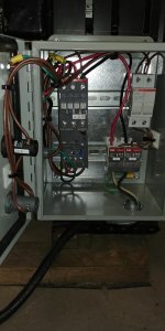

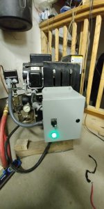

It's a little bit hacked together, but this is my $300 compressor I got on local classifieds. It's a 5HP motor, with a Powerex SLAE05E oil-less scroll compressor. Not as much CFM as piston compressors, but a lot quieter (70dBm standing beside it).
I built a custom magnetic stater/overload for it since I didn't like leaving the compressor on all the time, or using a disconnect as an on/off switch.
Also replaced the small screw in intake filter with a big one on a "custom" stand from a spare housing my brother in law saved from the scrap pile. The foam was stuffed in the intake to break up the acoustic pulses.
Still need to add an after cooler to help remove moisture, and add a fan to the installed pre-cooler so it works better. Love look of the B&M 70274 cooler though...
