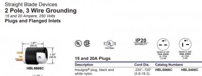

How do you determine HP rating of outlets?
Online listings for big box stores don't mention that.
Bill
mm08822
Jan 13, 2012
6,308
Bill
A lot of times the product details are incorrect, full of many typos or still doing the marketing campaign on the big box websites. 2 items I checked from big box didn't even list hp whatsoever. Always go to the mfr. See below.......
