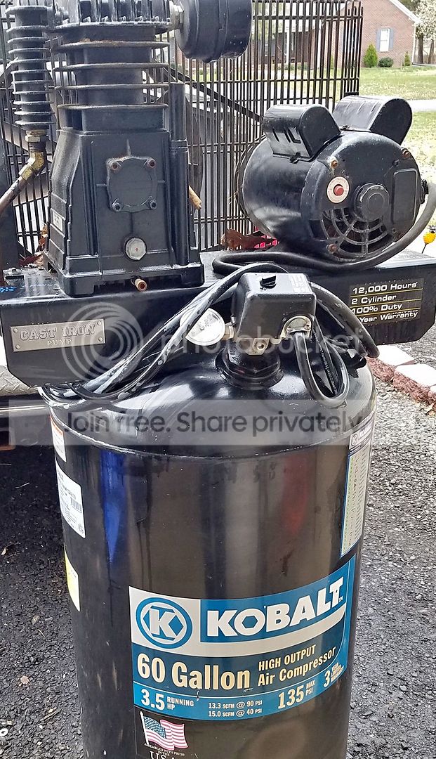

I saw this for sale locally, I don’t have the model number but do the pressure ratings listed on the unit seem strong for the size of this compressor?
60 gallon - 3.5 hp - 135 PSI - 13.3 @ 90
Overated?

My thought is it is a 2 parallel cylinder instead of the 2-compounded/2-stage cylinder that could reach 175psi.
A single or two parallel should be able to hit 90psi no sweat.

The only rating that is subjective is hp.
Psi & cfm are not.
Cfm is the most important, & those numbers are pretty good for a single stage compressor.

Seems legit. 4cfm per hp, roughly. 135psi is certainly not outrageous for a single stage compressor. A single stage compressor moves more air than a 2 stage at moderate pressure.
