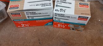

I'm installing somee headers on my porch addition and am using Simpson concealed beam hangers. (Concealed have flanges turn in rather than to sides if you didn't know.) Mine are triple 2x6.
Using the recommended screw, I measure I have to cut header 3/26" short of post to post clear. In fact I plan to leave the center of the 3 full length - no screws or flange obstructing.
Does this make sense?

Do they call out a screw?
I just used the 2x version, IIRC the instructions called for nails only, but one of the marketing pics showed the screws.
Of course I got home and realized it called for the longer nails (all I had was short) so I used GRK construction screws and was able to dimple the hole slightly to almost be flush. My application wasn't very critical, normally I would follow the instructions to a T.

I feel like a little extra room will be welcome when hoisting a triple 2x6 in place. I'd make all three the same length and add at least an 1/8" room. Does Simpson's install instructions specify anything?

I did find a Simpson chart that said I could use their 2 1/2 no 10 screw in place of the 16d nail. I also filled the triangles.
I've been comptemplating putting on 2x6 at a time in hangers. It's a tight squeeze as it is under existing roof overhang. Didn't seem too hard to nail or screw together in place. And with these on both ends not easy to wedge it in.
First project.using hangers - I'm old school - so learning they're not always easy, especially when there are existing instructions over them.

My condition is all about deflection, not bending. It carries the side of a hip roof - 7x7 triangle - half of which is carried by hip rafter. I think I would have been fine toe nailing the header. And as I said Simpson chart provided derating factors.

It's these screws:
I know...(See comments above)

When I used this type of hanger, I only used the nails; I didn't think screws were allowed on the inside due to the head size. I thought their simpson screws could only be used on the outside faces
