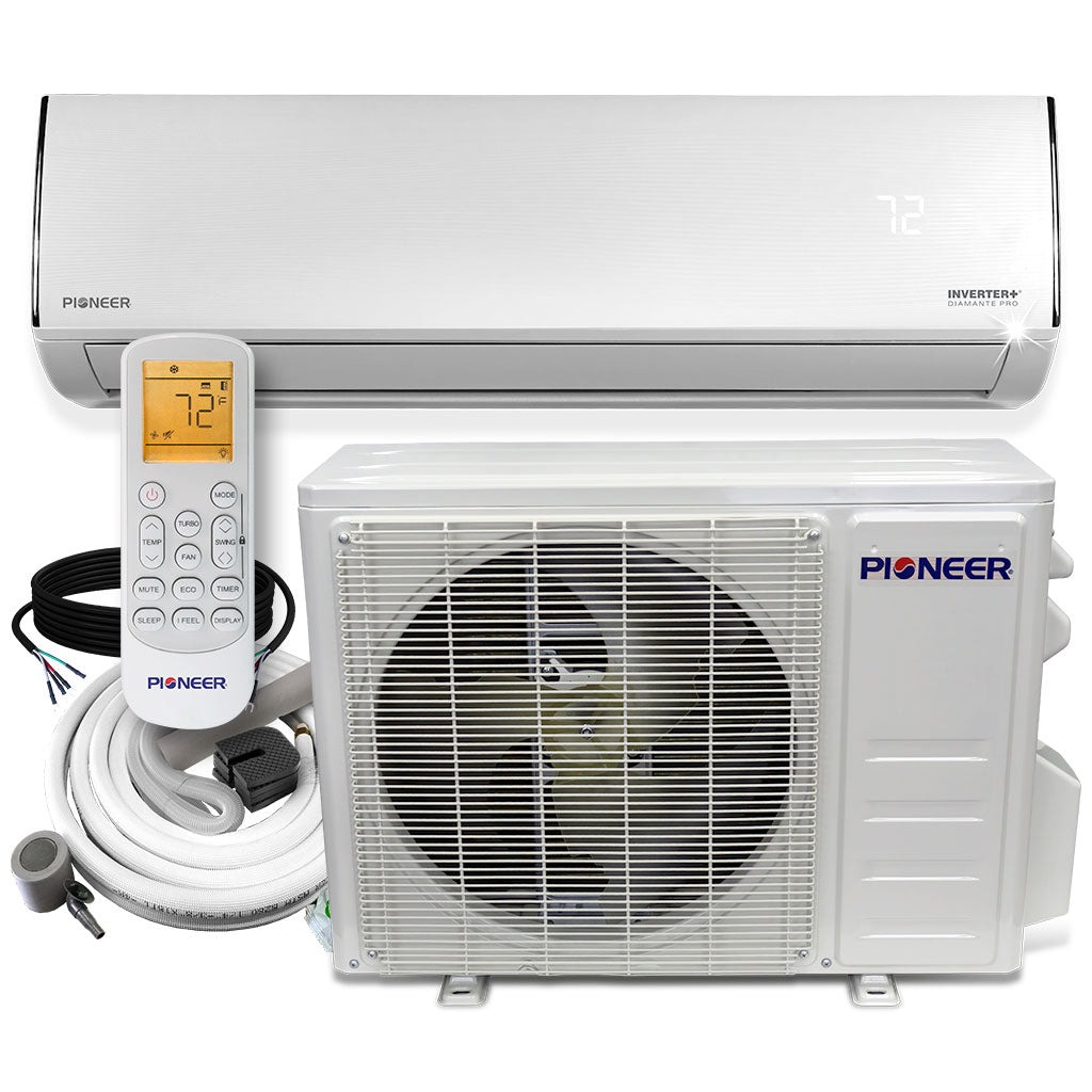

Here's a 36K Pioneer - 2 of them come in cheaper than that questionable unit you are looking at.
Firebrick43
May 12, 2015
14,524
West central Indiana
And gives some capacity if one breaks down to boot!
This advertises to -13, the other says to -22. Seems about the same price, but more work.
