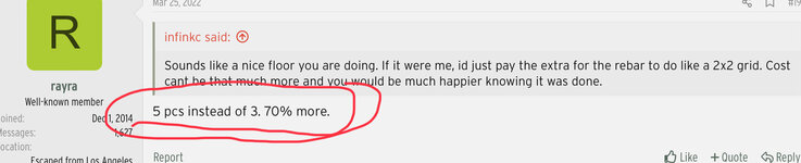

Wait … you need to buy 5 pcs of rebar instead of 3 pieces? Yes it’s 70% more, but in real dollars it’s pennies.
You bought any rebar lately? Building metals are all well into inflationary pricing.
Rebar, simpson brackets, wire reinforcement panels, it's all up 200-500% over the last 10yrs.

You missed the point. Yes rebar price is up. Yes you are buying 70% more rebar. But you’re buying TWO additional pieces of rebar. The additional cost will be minimal … and the cost to redo the slab from not having TWO more pieces of rebar could be excessive. A whole new thread.
Just for fun ... what is the total cost of the slab … round numbers. And how much more is TWO pieces of rebar?
I'm sure YOU missed the point, not I. It's two more RUNS of rebar per 10' of span. IN both axes. 70% more for the whole project. I'm not sure where you get that silly '2 additional pieces' garbage from.
