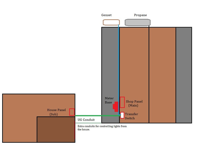

The conduit placement is my concern, not the size.
The feed from the meter at the shop.
I was initially going to also bury another 2" to get back to the shop from the genset, but really have no good reason to need to power the entire shop panel during an outage.
I figure I'll run a circuit or two from my house panel in an 1 1/4 back to the shop to feed a couple lights and a refrigerator.
Here's a drawing.

Question is concerning the 2" feed out the meter base to the house.
I'm thinking I need to route that 2" run towards a spot on the (not yet built) house to where I think the transfer switch box for the generator will be located.
Yes. Electrical service and the generator will both feed into an ATS (Automatic Transfer Switch)... Output of that ATS will go to your load center
Note, there are two types of ATS - "Service Entrance Rated" and not. If you're coming right out of the meter, you'll need a service rated ATS. Everything downstream is considered a sub-panel.
Also note, depending on type of signal wire for the genset, you may or may not be able to run it in the same conduit as generator power.
Roughly:
Meter------------>S.E. ATS-----------> Load Center
Generator feeds the ATS also (ATS takes input from generator and meter, one output)
How you gonna get from the ATS to the load center?

The main feed does not "need to contact the generator", it connects to the transfer switch. Transfer switches are very rarely located in the same spot as the generator and they arent mounted on the generator so...
Here's a drawing.
This will create some issues for you. Code does not permit multiple feeds to a building.

If youre doing a service rated ATS right off the meter, then yes every panel after that is considered a subpanel by code. This means the shop panel and house panel are both subpanels. not sure why you would think thats not right but it is. you cannot have 2 or more main service panels (which have the bonded neutral) on the same service.
yes, it involves isolating the neutral bar(s) and making sure the EGcs are on their own bar(s).
57 ground rods eh? you mean 2? :headscrat :dunno: Ive never seen a service with 57 ground rods and Ive done rods for microwave towers. no where near 57 rods....
ATS to load panel? Yes, that's how I understand them to be wired.
I seen an old co-workers setup last week. Same deal. 200A feed thru panel on a xfmr pole, UG to the genset "box", out that box to his main panel in the house.
No mention of any "sub panel" thing.
But, he did his after the house was built so outside by the genset the conduit is somewhat of a **** mess. I don't like a **** mess, that's why I'm asking about all this prior to the concrete trucks rollin down my road.
Seriously doubt I'd go through the exterior wall unless I got extremely lucky and they were perfectly back to back.
That feed thru panel would be the main service panel with a bonded neutral. again, you can't have the neutral bonded in 2 or more places on the same service. If you did, you would have neutral return current flowing on pathways you dont want it flowing on. this is what youre having a hard time understanding.
IF your coworkers setup instead had just a meter pan and then the gen transfer switch, the transfer switch would be the main service panel, with a bonded neutral, since it would have a disconnect in it.
Remember, neutral is bonded at the first means of disconnect on a service, then it is isolated in every panel after that.
so what you want to do, requires the house and shop panels to be subpanels. there is no way around this no matter how much you think otherwise.
Also, keep in mind that with an ATS, the generator must be sized to handle the entire connected load, or you need to utilize load shedding capabilities... this adds more cost and complexity...

Do you really need it to be automatic transfer?
If not, you could do interlocks in both panels, keeping them main service panels and avoiding all the mess you have envisioned.

Thanks Wylie.
Believe me, I'm not trying to out think anyone here. I am not an electrician. I wouldn't be asking these questions if I thought I was.
My nearly 40 yr career involved 12-138kv work.
Yes, the service entrance/meter being at the Shop first has created visions of confusion for me..
First, when I said 57 grounds rods, I was joking.
Second, When I said contact the generator first, I meant the xfer switch for the generator. Service to genset(whatever contraption of a box that's needed for the throwover) to load panel.
Really not sure how they work in regards to disconnecting from the utility source in order to throwover and feed the house, and the shop(if desired). So,,,,
After pondering it more, I decided I don't need to feed the shop with the genset.
What's the reason for not being able to run two ckts out my house panel to feed a refrigerator and light in my shop, other than code? This will be inspected by no one.
And yes, I am thoroughly confused on the matter of not being able to land neutrals and grounds on the same bus.
The ground is the ground is the ground, right?
The panels will all be grounded via a ground rod.
Bonding, unbonding??
I really want to understand it in order to do it right, as well as why was the 3 wire feeder ok until 2008?
I know I found a couple youtube videos about it when I first heard of it, but I don't believe everthing I see on youtube.
I need to go back and study more I reckon.
Appreciate y'alls help

Yea, this issue was confusing to me too. I can't tell you why it suddenly became "wrong" via NEC, but I can tell you when I was a kid that I felt current through residential plumbing systems on homes built in the 1980s.
You should look up "service entrance vs sub-panel ground wiring"
Basically only ONE panel gets to have a ground and neutral on a common bus, and that's the first panel - main panel - everything downstream has separate neutral and ground. I think the second place it can be bonded may be in the meter box - but Wylie can be more helpful than I can.
Here's a decent discussion:
https://www.garagejournal.com/forum/showthread.php?t=291565
I really like the ATS system for generators - they're $500-$850 options. They turn on the power for you, can be used to monitor your generator, the ATS I just bought also has a function that helps sort out what is pulling power in your home. In my case, the ATS is necessary as I have load shed modules that need control by an ATS.
Note, if you have a generac, the "service rated" ATS can also be wired as a sub-panel (you can unbond the neutral). However SOME electrical panels do not swap roles as service-entrance and sub-panel as the neutral cannot unbond.

The "contraption" is called a transfer switch. the automatic flavor has a motorized disconnect that automatically switches the feed connection from the utility to the generator feed.
Safety. having 2 sources of power from 2 different panels creates the potential for shock hazard.
If you want to make this way easier, put the transfer switch on the shop or house, and do a branch feeder to the other building from the subpanel in the building with the transfer switch. this way the generator will power one panel which will in turn power the other one through the feeder. eg. put transfer switch on shop, feed subpanel in shop from transfer switch, then feed house off of shop subpanel.
EDIT: Just because its not being inspected doesnt mean it shouldnt be wired correctly. the lack of an inspection is not a green light to do shoddy wiring.

since you worked in utility power which has no EGCs, i can see why you would be confused.
on the load side of the meter, neutrals aka the grounded conductor and EGCs/equipment grounding conductors aka grounding conductors ARE NOT ONE IN THE SAME. this is where your confusion comes in. The EGC is for providing a low impedance pathway for fault current to flow to enable the breakers to clear (open the circuit) the fault. under normal operation, no current flows on an EGC and thus an EGC can be uninsulated.
The neutral, on the other hand, is for neutral return current. under normal operation current does flow on this wire and thus it must be insulated.

There's a couple of different ways to do what you want... Wylie is trying to help you do them right. The guy knows his stuff.
You mentioned that you are building the shop and that the meter will be located there. My question is, what size is the service going to be? I ask because a typical 200A service meter only has one set of lugs for conductors. That's fine if the panel in the shop has a set of feed through lugs that you intend on sending over to the house, just understand that if you need to shut off the shop panel for any reason, you are also dropping the house. Not a big deal, just be aware of that.
Another option would be to ask the POCO to install 320A or 400A service. Typically, a service meter of that size has two sets of lugs, so you could run one set to the shop and the other set to the house. You would likely have two disconnects located right there at the meter, one for each feeder. That way you could kill power in the shop without any impact to the house. Just something to think about.
Now, if you are set on the idea of feeding the house panel from the shop panel, that's totally fine. You could run the feeder from the shop to the house and into an Automatic Transfer Switch (ATS) that hangs on the side of the house. (3R rated enclosure.) The feed could come straight up into the bottom into the ATS, and the feed from the generator could also come in from the bottom. If you wanted to, you could likely have the feed from the ATS to the house come out of the bottom, too. I just checked the dimensions on a Kohler single-phase ATS, and it's 24.5" tall, 13.2" wide, and 7.1" deep. (The Service Entrance rated ATS with a breaker is slightly bigger at 28.9" tall, 16.4" wide, and 6.9" deep.) So imagine three, 2" conduits running in parallel from the ground up into the ATS in a straight line.
http://www.kohlerpower.com/home/home-generators/products?prodNum=RXT-JFNC-0200A-QS7
A typical 20kW residential generator is good for about 80-85A. (Technically 83.33A) If you have done a load study and know that your house loads will be under 80A, then you're good. If not, then you need an ATS that has an automatic load shed function that can shed certain loads under higher load demands. Typically, the load shed function has a set of current transformers (CT's) that monitor the load on the system, and has load shed relays that can dump big current draw items such as your HVAC, or electric Oven. The Kohler ATS I linked to above has the option for load shedding if you wanted/needed it. (Kohler refers to it as a "Power Relay Module." You can connect up to four of them to the ATS )
The concern about sending a couple of circuits from the house back to the shop for a light or a fridge has to do with safety. The concern is that someone would come into the shop, trip the breakers in the breaker panel except for the main, and assume that everything in the shop is dead. If they didn't know/realize that the main panel had feed through lugs, and the house still had power, and that those two circuits from the house to the shop still had power... they would be in for one hell of a surprise. (Which could be deadly.)
It doesn't really matter where your generator is located in reference to the ATS. Personally, I wouldn't want my generator right next to my house due to the noise... but that's just my opinion. My in-laws didn't have much choice, being in town on a small lot. I installed their 20kW generator 5' from the house and poured a concrete pad for it, with an extension/dog leg that extended to the house. That way, I had a solid foundation from the generator to the house for mounting the conduits and fuel line. (One 2" conduit for power, and a 3/4" for control circuits. Pic attached during installation for reference.) It's setup to do a test run once a week, every Saturday at noon. They can hear it, but it's next to the garage vs. a bedroom, so it's not that bad.
For a propane unit, I'd likely want my generator closer to the tank. The drawing that Noltz did is kinda like I would be thinking. Not only is it close to the tank, but it's all hidden behind the shop. Out of sight, out of mind... especially when it comes to thieves.
A residential propane unit will likely be a vapor withdraw system, so you'll need a decent sized fuel line from the tank to the generator. Looking at the Kohler spec sheet for a 20RESCL and it's saying you'll want a 3/4" line up to 25 ft. from the tank, 50-100 ft. requires a 1" line, and 100-200 ft. needs 1 1/4" line for LP.
So if this were my project to design/build, the first thing I'd be asking the home owner is what they want... do you want it to be as least expensive as possible? If so, then you will likely be giving up some aesthetics. (It might not look pretty.) If you don't mind that the generator and LP tank is right next to the house, then we can hang the ATS on the side of the house with a short run from the generator to the ATS.
To me, I like the thought of the tank and generator behind the shop. I'd mount the ATS right next to the power panel in the shop and stub into it there, and run a set of conduits from the generator to the ATS, then run a conduit from the ATS directly to the panel in the house. (Two conduits if you needed to use the load shed function at the house, or wanted remote monitoring of the ATS and generator in the house.)
Hope this helps.
200A service. The Co-op will not let me do the 400A with two 200A disconnects. Their reason is that they will only run one 200A service.
I still can't figure out their reasoning.
They did approve a Meter base like this
>>https://www.homedepot.com/p/Milbank...Socket-Load-Center-R5168-XTL-200-KK/202504170
Ok, I agree that makes perfect sense. But,,(not to be a smartass)too bad for the dead man. Never assume anything is dead.
Proper labeling would be in place for that circuit, and in the Shop Bkr panel.
The one "get ya" even if only the receptacle was labeled would be someone performing service to whatever is plugged in, like the poor Appliance man.
I'd have no worries as long as I lived there, but I can see how it could sure be a liability for the next feller.
Hope this helps.

Thank you very much Mark. Well explained.
I had a suggestion from someone else about locating the ATS at the Shop.
That would be a ~60' run from that ATS to the Genset if it were behind the shop.
And then I'd have to get someone to plumb the propane line.
Not having the equipment in place, or the house, makes this more of a challenge that I hoped for.
