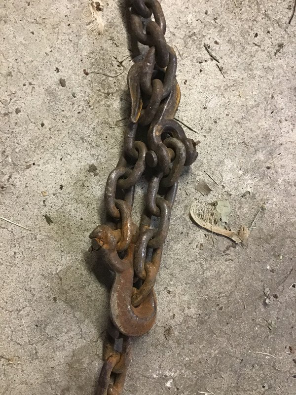

I'm a little confused about whether it's okay or not to hook up the chains this way:
Yes that is how they are intended to be hooked. If both chains have grab hooks then hook them a nikerret shows, one chain will take the load as they are slightly different lengths most likely but this is how it should be done.
rlitman
Oct 18, 2010
24,796
Long Island
Basically, yes. Grab hooks are designed to connect chains in a straight line only. If you want to connect two chains, each with grab hooks, then there's no harm in connecting the second hook, like nikerret shows, but really, only one will be doing all the work.
Higher up, seber raised an important point. Grab hooks are ONLY for connecting two chains in a straight line. They are not made to connect one chain to a loop of chain. Used in that way (sideways), the chain's strength is compromised.
