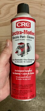

I've used this to clean out electric motors that were gunked up...
Designed for and works while the motor is up and running...
Would think it might be a good consideration for your situation...
That stuff will absolutely destroy many plastics! I used some to try and clean out a dirty USB charging port on an MP3 player and the case crumbled afterwards.
CRC makes an Electrical Contact Cleaner that is plastic-safe.

I will try that this weekend, unintentionally booked for the next 3 evenings. I did notice the screws on the bottom of the battery thanks for the video.
