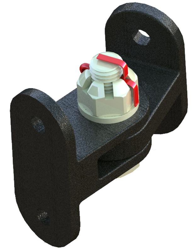

And be sure to install the new one like this for more shear strength. Install it the typical way(horizontal) and put a big enough wrench on it and it's much easier to shear both ends of the pin off vs's trying to power through it with it being like in this image:
