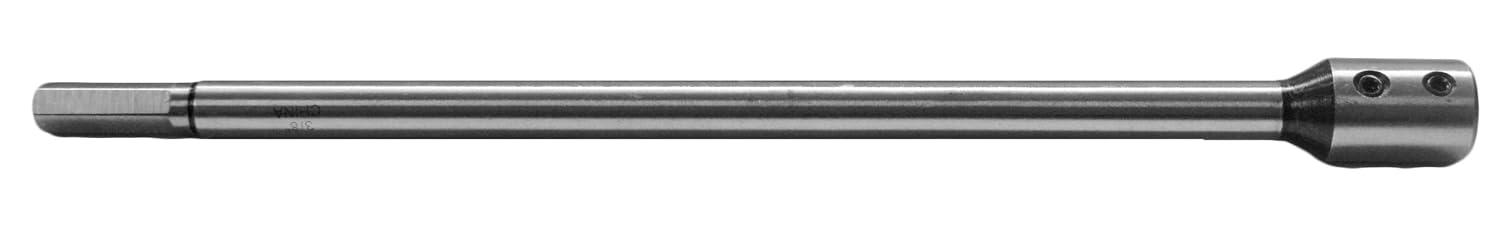

For that bracket I'd be tempted to use a series of wire wheels
along with my Irwin (88601) 12 inch extension. I use the
extension whenever it need to clean out a pipe in the wall.
Sorry about the giant image.
