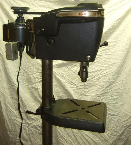

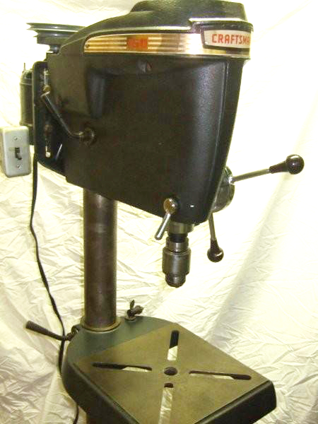

Hi all,
First time poster here. Was referred to this post from a thread on Woodnet.
I've got a Craftsman 150 DP that I bought off of CL a couple of years back. It's in great shape, virtually unused in no need of rehab.:rocker:

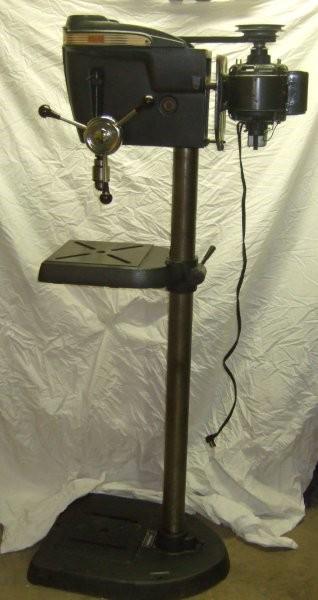

This is what it looked like when I bought it:

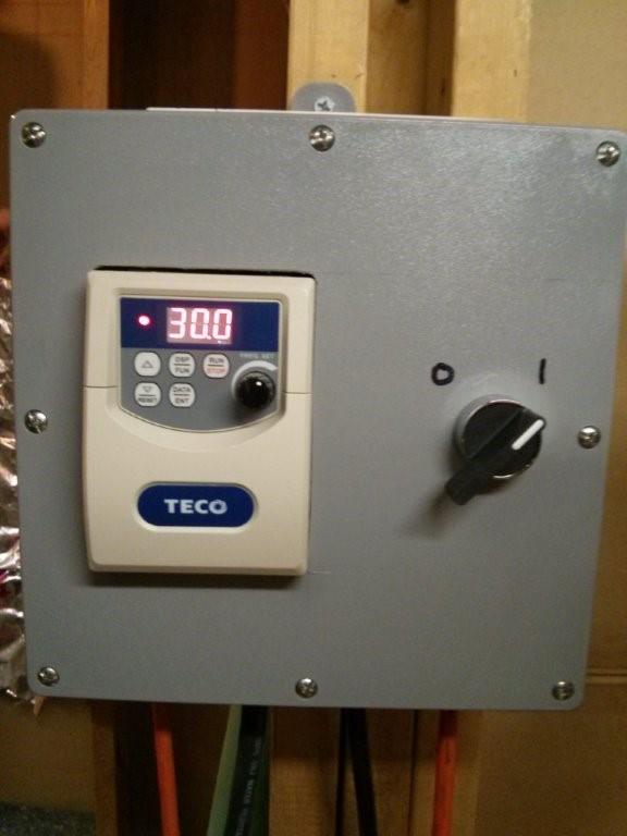

Some time back, I replaced the 1/2 horse single phase motor with a 3/4 horse 3 phase motor driven by a Teco TENV VFD. The motor was a 1200 rpm so it was already slow(ish) speed and I used the old multistep pulley so I could get good low speed torque.

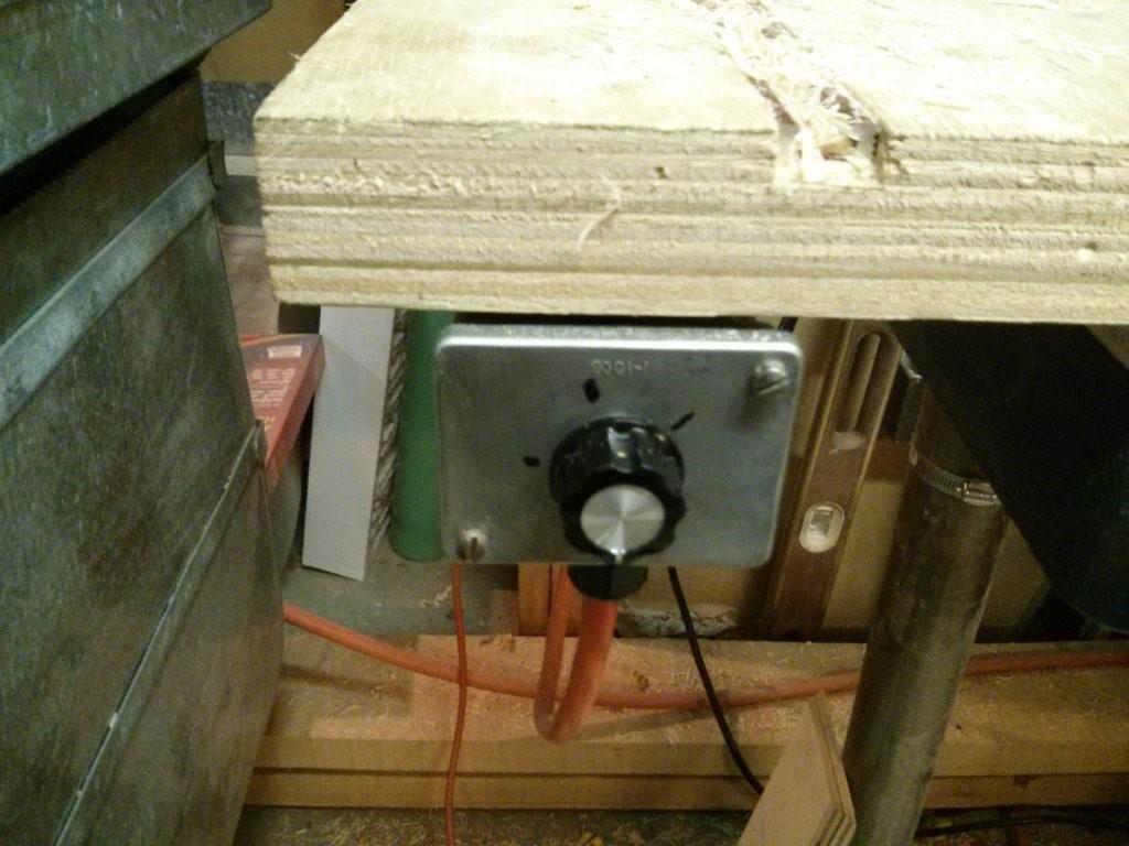

I bought a cast iron motor mount from an older DP as I thought the formed sheetmetal plate on mine wasn't up to the task. I mounted the VFD in a plastic box from the Borg with a power switch. I bought a pot for remote speed control and toggle everything from a footswitch I bought off of E-Bay eons ago.
I don't have any photos of the DP (I'm not at home), but this is the VFD and the controls
My next task is to add a counterweight to the table on this DP. The table has always been a pain, but I've developed some lower back issues and lifting this table would only exacerbate those.
Anyway, I've bought some old window sash weights off of e-bay to use as counterweights. They are small enough to go inside the center column to be out of the way. I will use those, some cable and a pulley to offset the weight of the table.
I'll post photos of the exploits as they develop.

Yes, the VFD is 120VAC input. It works great. I was really surprised how much slow speed torque it has. I chucked up the largest Forstner bit that I have (2"?) set the VFD for 30 hz and it just cut right on through without a care.
