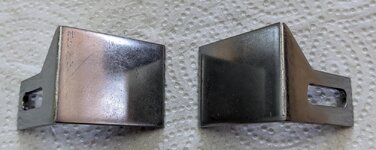

I am restoring a Crafstman 397.19580 1/3 hp grinder that I found on ebay. It came without both tool rests. I haven't been able to find any originals so I thought I would make some replacements. If anyone has this grinder I could use some dimensions so I can get closer than I would by just looking at pictures. Thanks.

I made larger than oe rests with 2" sections of 3x3 angle iron for my cast iron grinder. I actually replaced the originals with these.

That's a good looking grinder and nice tool rests. Thanks for the angle iron idea. I could make something like that work.

Did you grind yours flat and square first, or just cut and go?

I honestly can't remember. I bought them cut. The guy at the steel supplier used a 12" cut-off saw for each piece.

So I found a single original used tool rest on ebay. I wasn't about to pay 30 bucks for just one but I used the ebay pictures, parts diagram pictures and other pictures I found here on GJ and created these from 1.5" lengths of 2" steel angle:
Here's a picture of the bench grinder before restoration:
And after:

Nice job!
Looks just like the ones in this thread.
Post up some dimensions and a sketch for the next guy.

That may have been the thread that sent me on a search for my own candidate for restoration. I wish I could find the original lamp to add to mine. Here are the dimensions of the tool rests I created:
