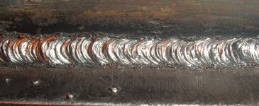

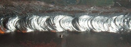

Forney makes an inverter for around 100 on line, I tried it for giggles, it worked ok with 6011 3/32, bigger tripped the breaker where my Max will run it fine. Its a toss at 100$ but so is that little ******. I gave one away and regret it just so I could test it. ha To get a small job done could use the forney.
The middle is the small rd and I am not used to it, likely this was all after a dozen cups of coffee anyway but the 1/8 11 and the 3/32 18's would trip the breaker about 3/4 the way thru. If it was on a 30A it would probably work ok for a rod here or there, I had intended to see how long it would take to burn up, should have hooked it to my chop saw circuit and seen?
It was really a test to see if a guy could find a 100$ machine,,, I suspect if a guy went to 150 with the Longevity might be able to so it,, another one would be that green thing, forget what they are but they make a 120 inverter. I would have liked another 5A behind all of these.
