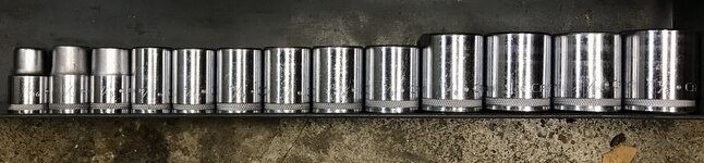

Looks like I found the right thread for these drive tools I picked yesterday. Wondering if the cad finish is indicative of "wartime" finish? Or just an industrial purpose for the "sans chrome"? CircleU2.jpg
