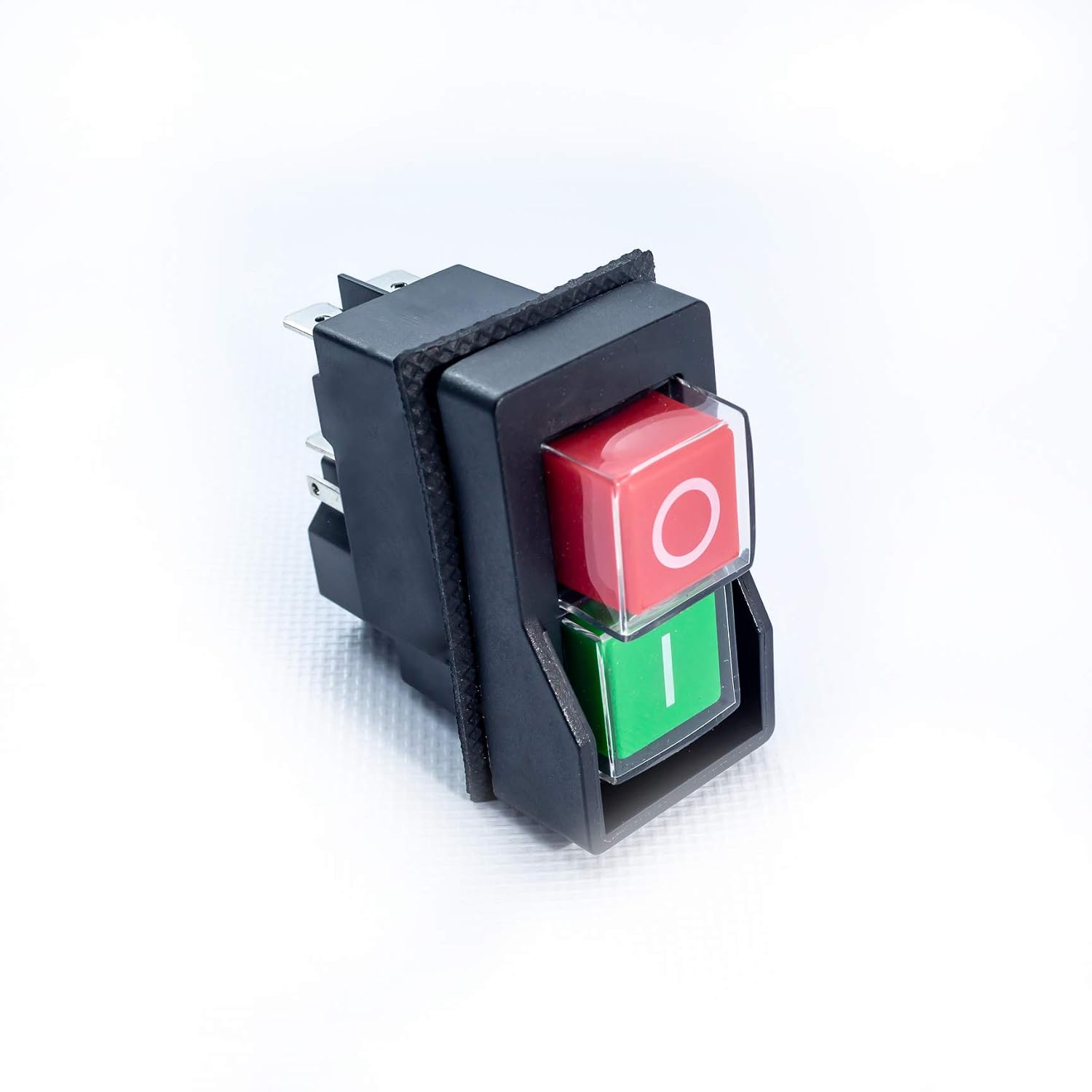

My question today is: where do I find a switch for the CM drill press? It is a bench top model and here are some pictures.

1/3 HP should draw less than 5 amps, so any 110v switch would work. I've seen light switches used in similar applications, although that wouldn't be my choice.
If you want to keep it original, you may be able to find a replacement switch at one of these sites:
https://www.searspartsdirect.com/partsdirect/brands-products/Craftsman-Parts/Power-Drill-Parts
https://www.ereplacementparts.com/craftsman-drill-press-parts-c-158286_159104.html
I prefer a large stop button for my stationary tools. Something like one of these would work well; fab a small mounting plate and you're good to go. I'd choose the magnetic switch due to power outages (thanks PG&E!)
https://www.amazon.com/POWERTEC-71006-SAFETY-Locking-Switch/dp/B002DSBWI6/ref=sr_1_1?s=hi&ie=UTF8&qid=1543561380&sr=1-1&keywords=powertec+switch
