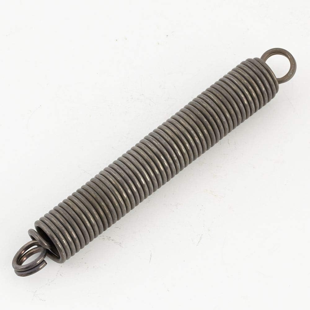

Time to replace the Spring.
The pics bellow show my DP, model 113.24580. And a picture of an "Craftsman 38989 Drill Press Feed Return Spring Genuine Original Equipment Manufacturer (OEM)" if bought new.
Questions:
1. What are the specs on the OEM spring (LBf, Length, Diameter, etc.)?
2. What tips do I need to know about installing it (Grease application, etc.)?
Questions:
Is there any reason I cannot go to the local hardware store and dig through their springs until I find a spring that looks similar? Seems like a real simple setup: Two pins and a spring. Is there anything I need to keep in mind about installing and using it to make sure no wear-n-tear or damage happens?
Thx.
That's pretty uncommon for a spring to snap like that. I usually see them twisted out of shape.
Your hub assembly is identical to or interchangeable with the late 150 hub assembly.
Anyway, check this post for dimensions, etc.
https://www.garagejournal.com/forum/showthread.php?p=6347474#post6347474
I don't know strength specs.
This post may also be helpful.
https://www.garagejournal.com/forum/showthread.php?p=6347465#post6347465
At the time I wrote that post, the spring was still available on SPD... not anymore.
I usually run a bead of Super Lube oil along the length of the spring barrel when assembling.
That broken spring may be useful on an early machine if you can bend that last half loop into a tang.
