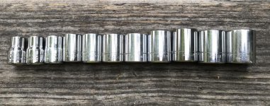

Here is a set of metric G series 3/8” drive sockets with knurling.

Here is a set of metric EE 3/8” drive sockets without knurling. I think Rileysan or JoCo may be able to help with info on the CDs.

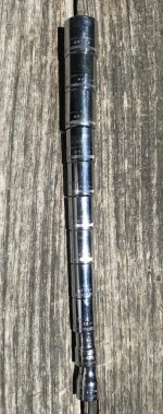

Dadstools: Sorry, but I'm going to have to disagree with you. I have a double detent (late) GK series socket with an angular font and round three, so I believe his socket is late production. But thanks for the info on when Easco was bought in 85.
Interesting and mine is the single detent I know they made the double detent later in production up until they went to China I talked to my neighbor who has a lot of Craftsman tools and he said he has never seen one like that until now I have a couple GK ones in both the early and late fonts and have a CG one with the early more rounded font so it’s interesting I wish we knew more about it
Hmmm....not the same G. The example being discussed has a narrow G with a serif. So, while it's true your example is not rounded, it certainly is distinctly different than the narrow serif G. I'm looking at all the geometric features of the character, not just one. The case is still open.
Opps, I should have emphasized that I was talking about the three on my socket being similar to Blake's, and you are right, the Gs are definitely not the same.
