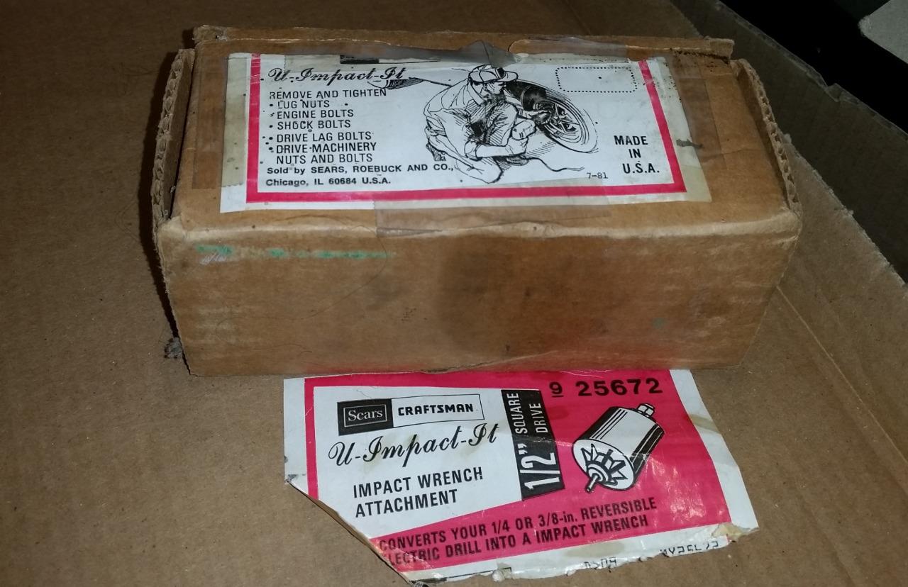

This was mixed in among my Grandfather's tools after we inherited them.
I haven't been able to find anything out about it online, other than some google image search results showing thumbnails for ebay auctions that no longer exist.
It appears to be a device that fits in the chuck of a drill and turns it into an 'impact' tool, with a 3/8" square drive on the end.
Anyone know anything about these?

Neat, I've been looking to get my hands on one of those kinds of devices for one of my drills but its kinda hard to find them now; didnt know Sears used to make them. I have only B&D drills since their batteries are easy to rebuild and they dont make a nicd impact driver and am too cheap to convert so if you're in the same kind of boat I am its a pretty useful tool. It is a bit bulky though so it wont fit into tight areas.
They work by winding up a spring on a clutch and when the clutch/spring mechanism reaches over the square block it creates an impact.

There appears to be little info on these out there.
This one appears to be dated 1981.
