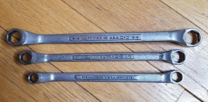

Here are some wrenches I have not seen on the thread on in you doc. Use freely if you like/need to :)
