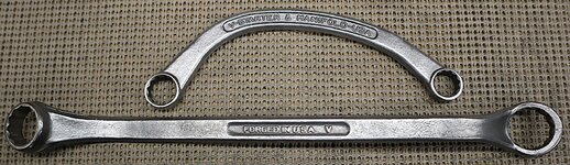

Here are a couple of Sears wrenches. The top one is a starter/manifold wrench and both are marked with the "V" indicating Moore Drop Forging or affiliated. I think I bought this new about 1970, give or take five years. It is marked with the Craftsman name, but in a recessed area, not a raised panel. Finish appears to be cadmium. The second wrench is a "Dunlap" offset with "Forged in USA V" on back.

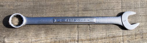

A photo of the front of the wrenches would be helpful. Are there double lines either side of CRAFTSMAN? I suspect that there are, which would date the wrenches to no earlier than 1976 or 1977. The outlier is the 24mm wrench with the lower case “m”s. On the assumption that the wrenches were all purchased at the same time, the wrenches would date to the time that “MM” transitioned to “mm”. I have looked for years for that date and never found anything authoritative. I suspect very late ‘70s to very early ‘80s, almost certainly before the Rales brothers hostile takeover in 1985 when the wrenches started to get ugly.
Kudzuman
May 10, 2025
6
Based in the variations in the width of the raised panels on the back of the wrenches due to deep stamping on half of the wrenches, if I had to guess, I would guess early ‘80s. I stand to be corrected. Nice set! If I had beaten you to them I would have bought them! I’ve been buying “MM” wrenches lately to fill sets. Harder to find are 16, 18, 20 and 23.
Kudzuman
May 10, 2025
6
I just noticed the 24 did not appear to have the double lines flanking CRAFTSMAN, which would place it after 1972 or 1973 when the model numbers first appeared, but before 1976 or 1977 when the double lines were re-introduced. The “mm” stamping was not used until even later. I wish someone who worked at Springdale would chime in! Strange wrench!
