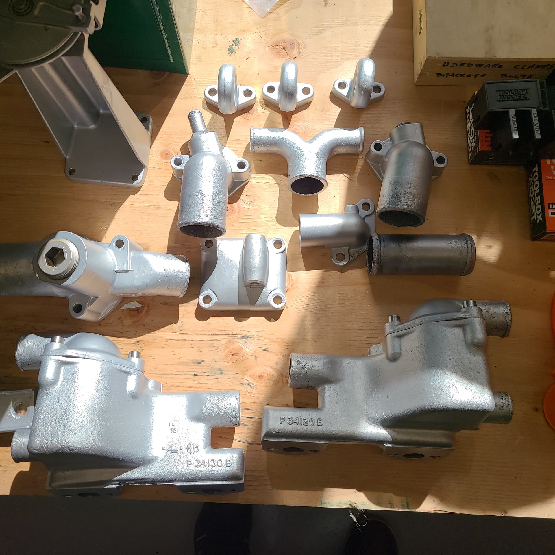

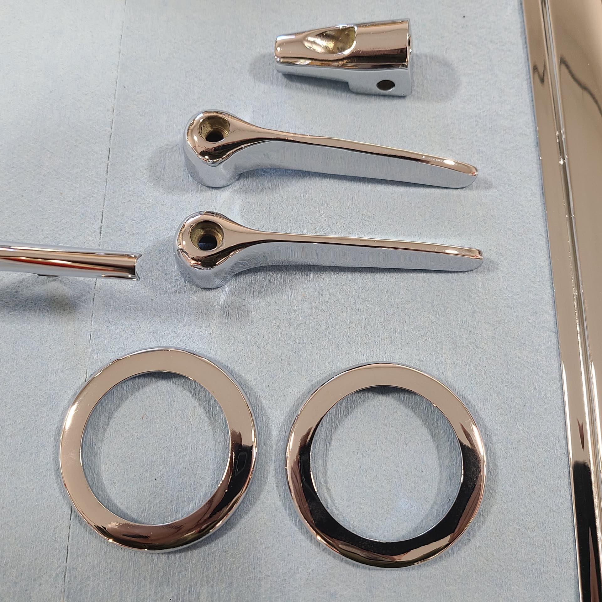

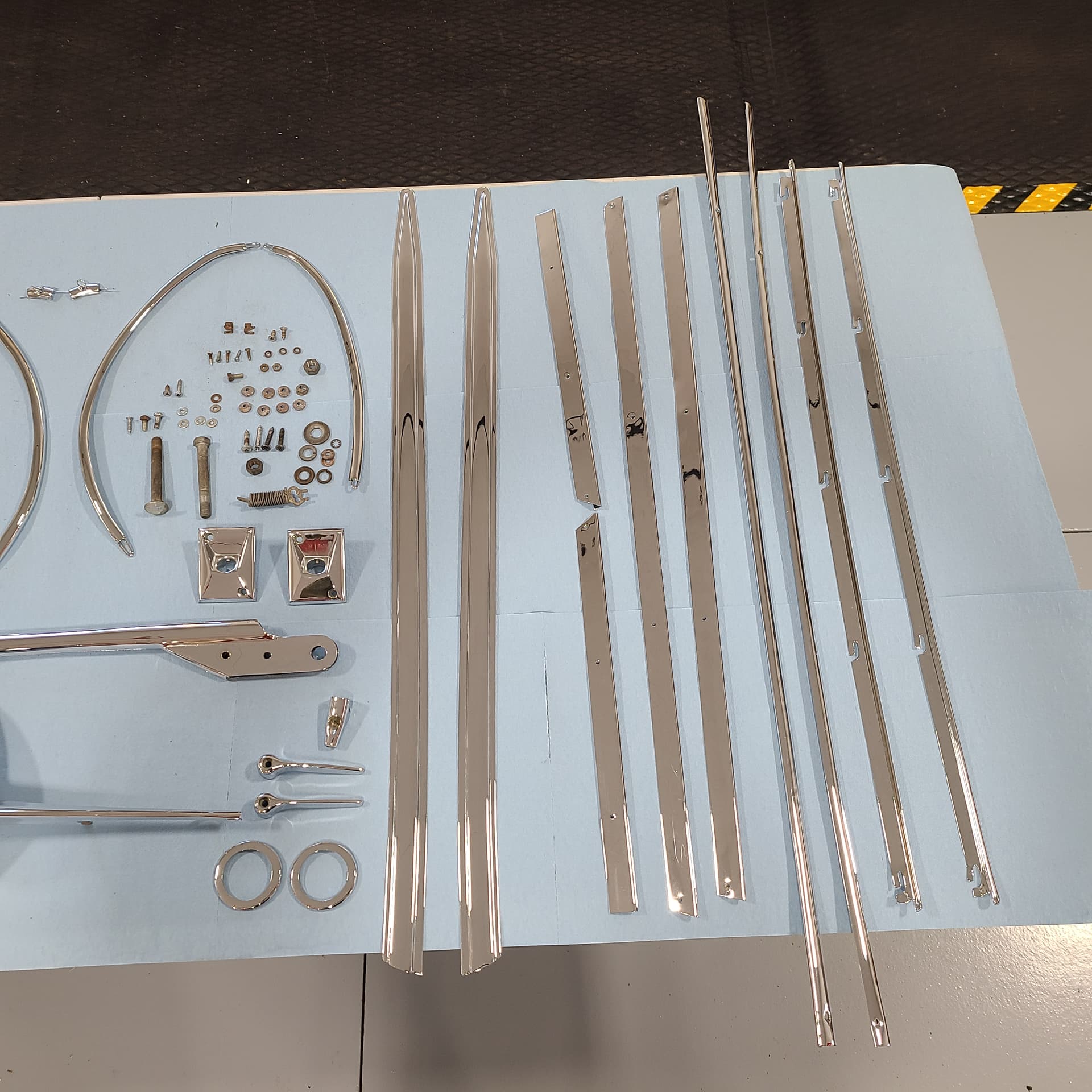

As I have stated, my intent is to cadmium plate a bunch of items (I have since decided to nickel plate the suspension pieces and found a plater 3 hours from my house). In the case of the suspension, my painter needed them to move the car around but couldn’t provide a hard schedule. So I temporarily delayed coating them and instead soaked them for 2-3 days in Berryman’s and then scrubbed them with SOS pads.
They came pretty clean except where the angles prevented me from “getting in there”.

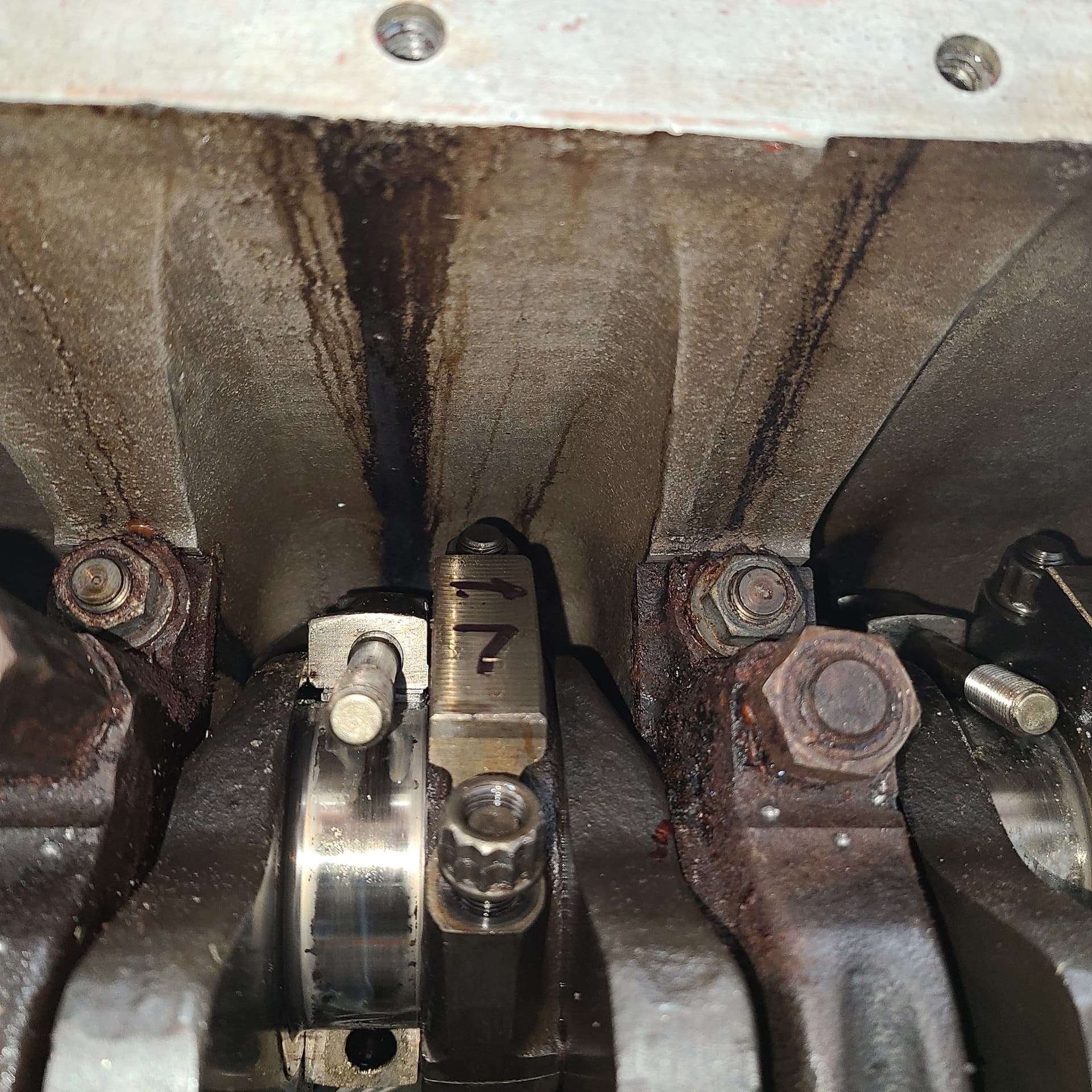

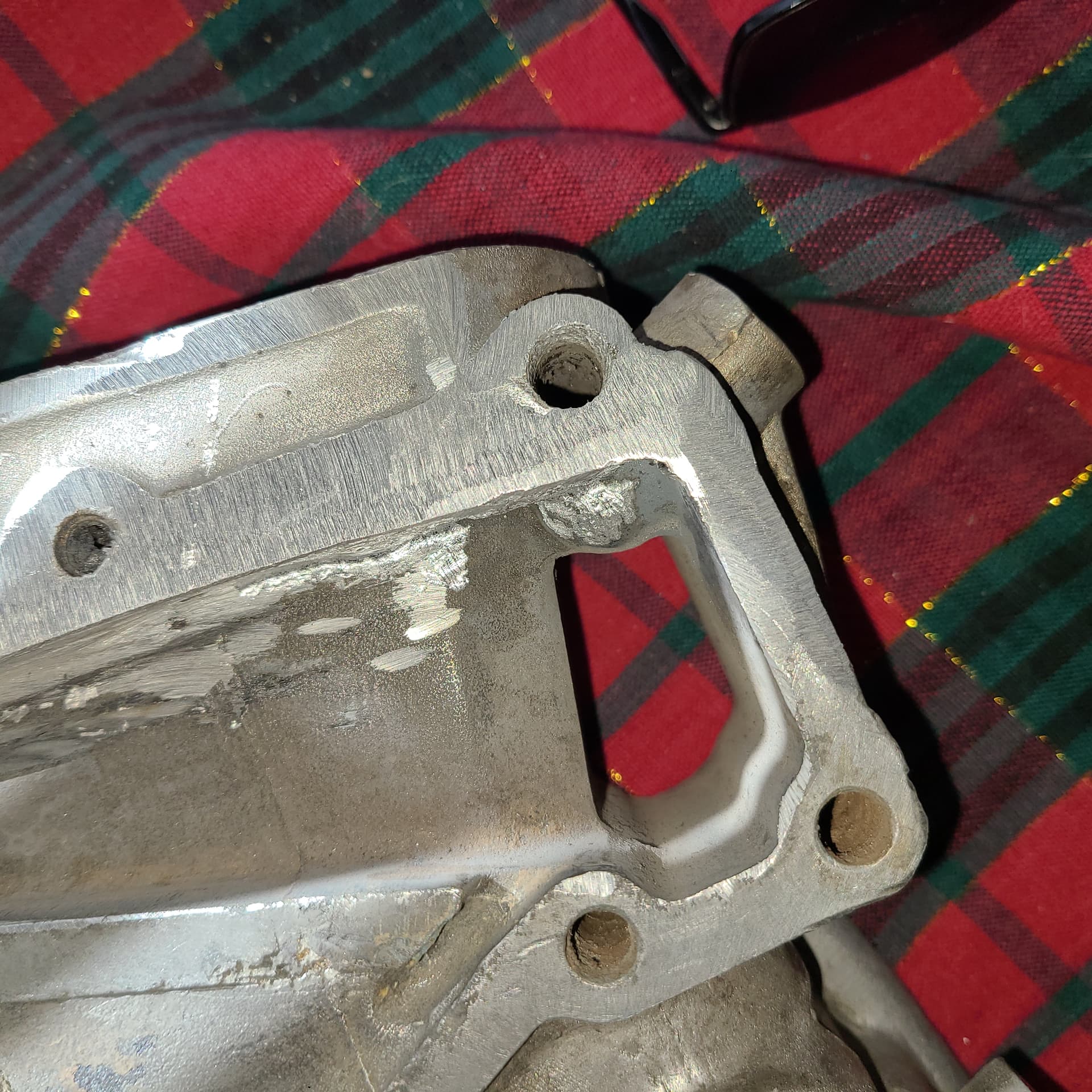

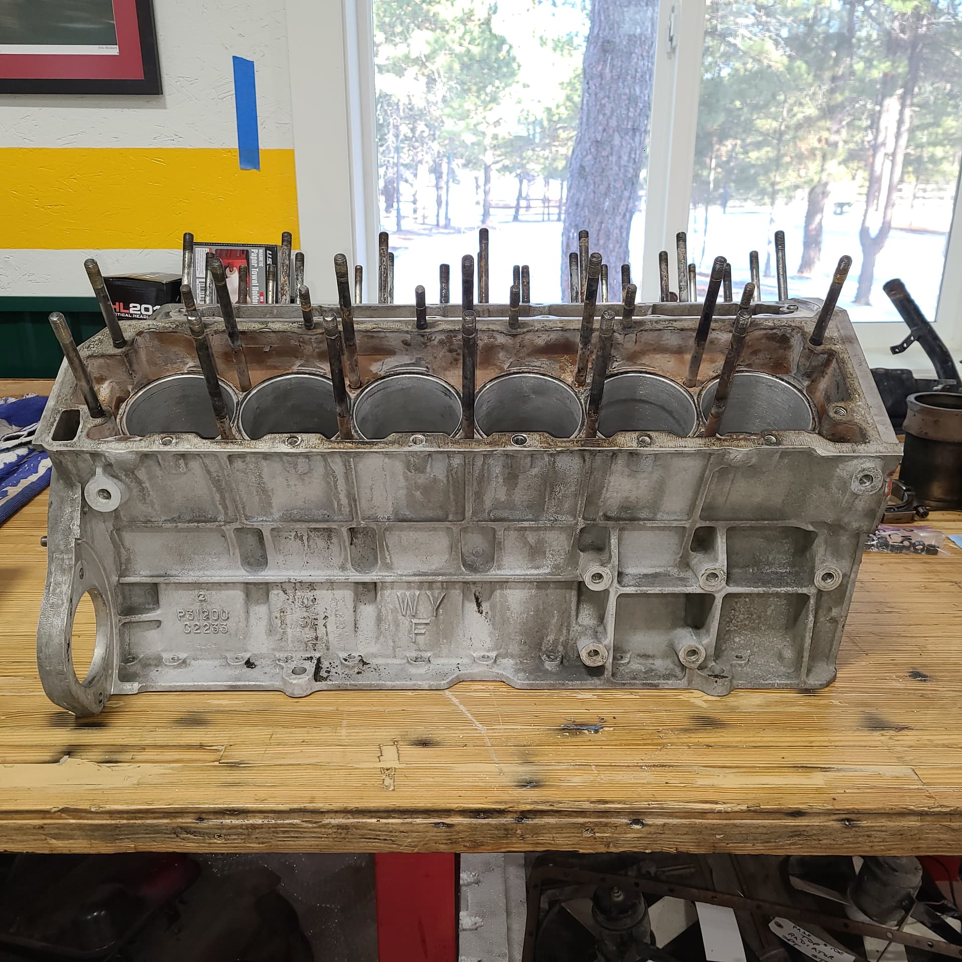

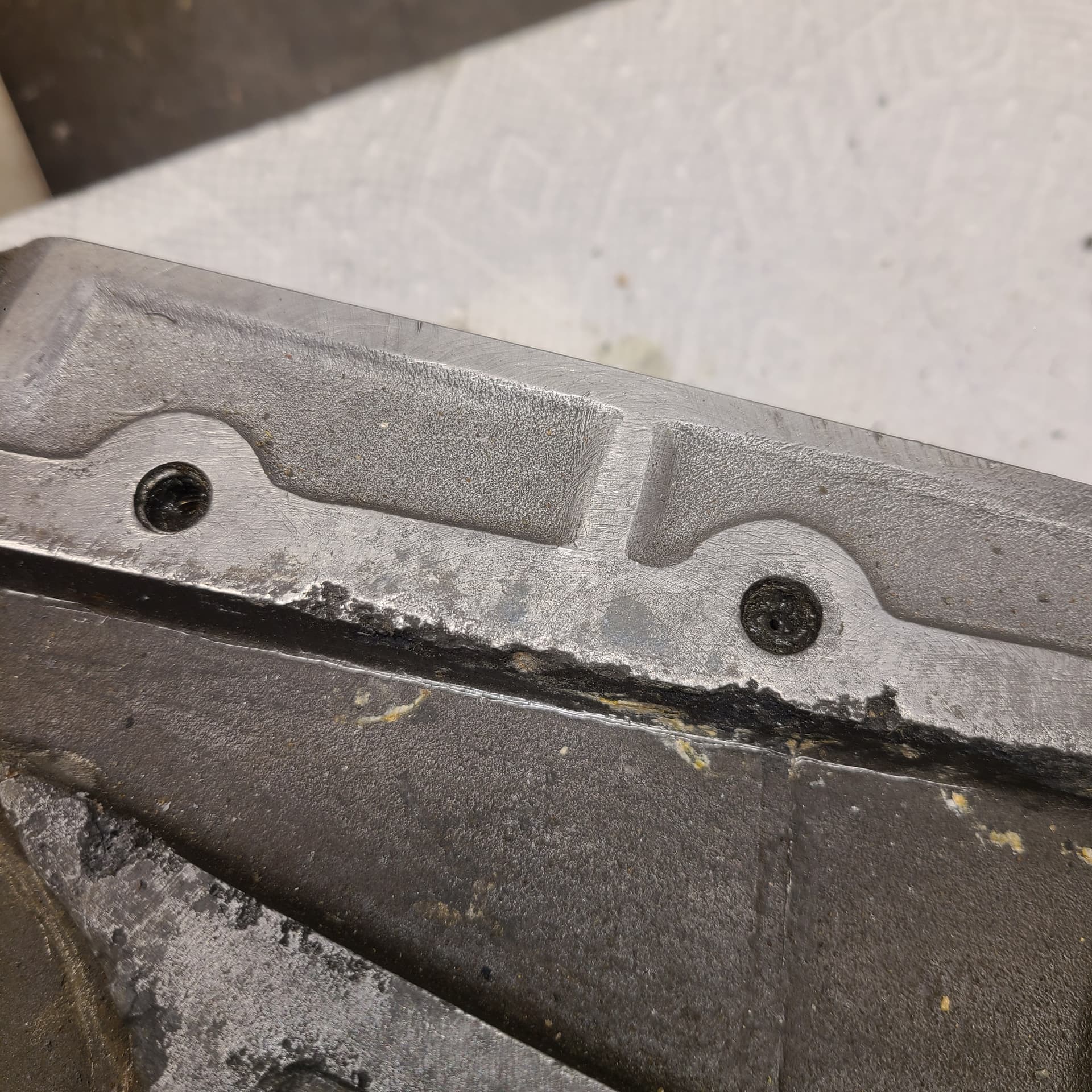

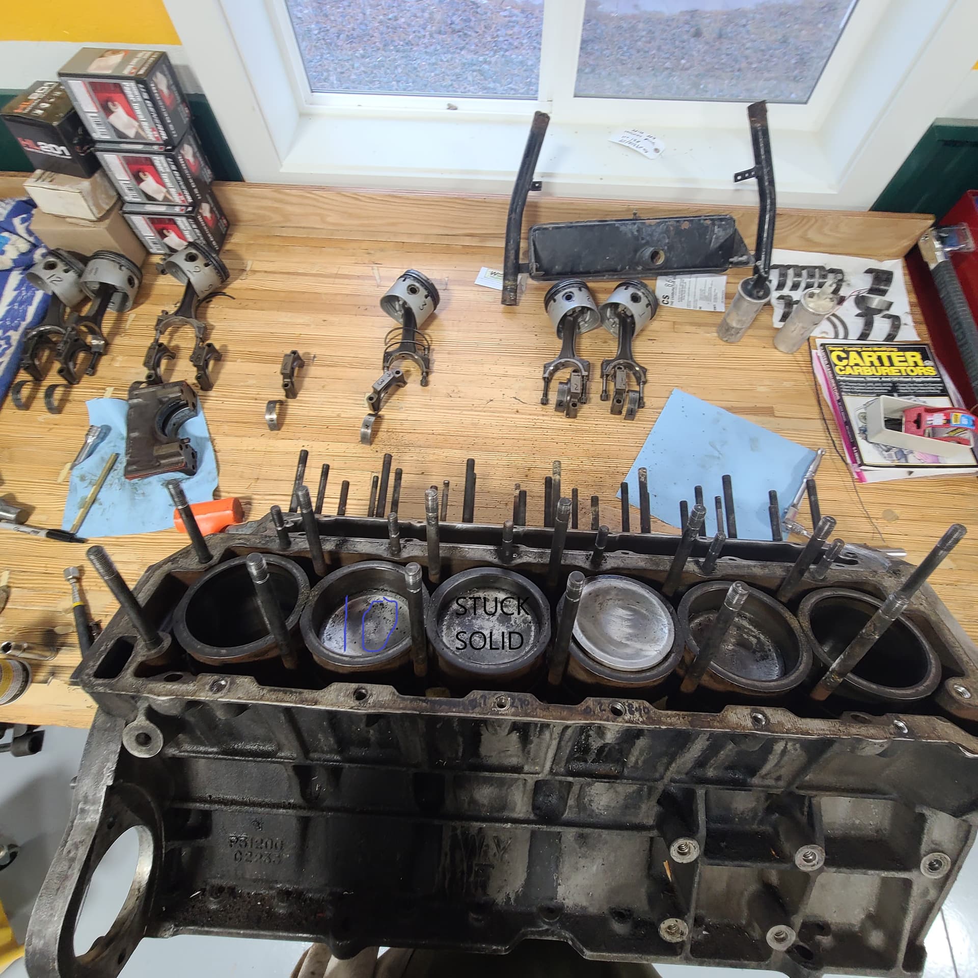

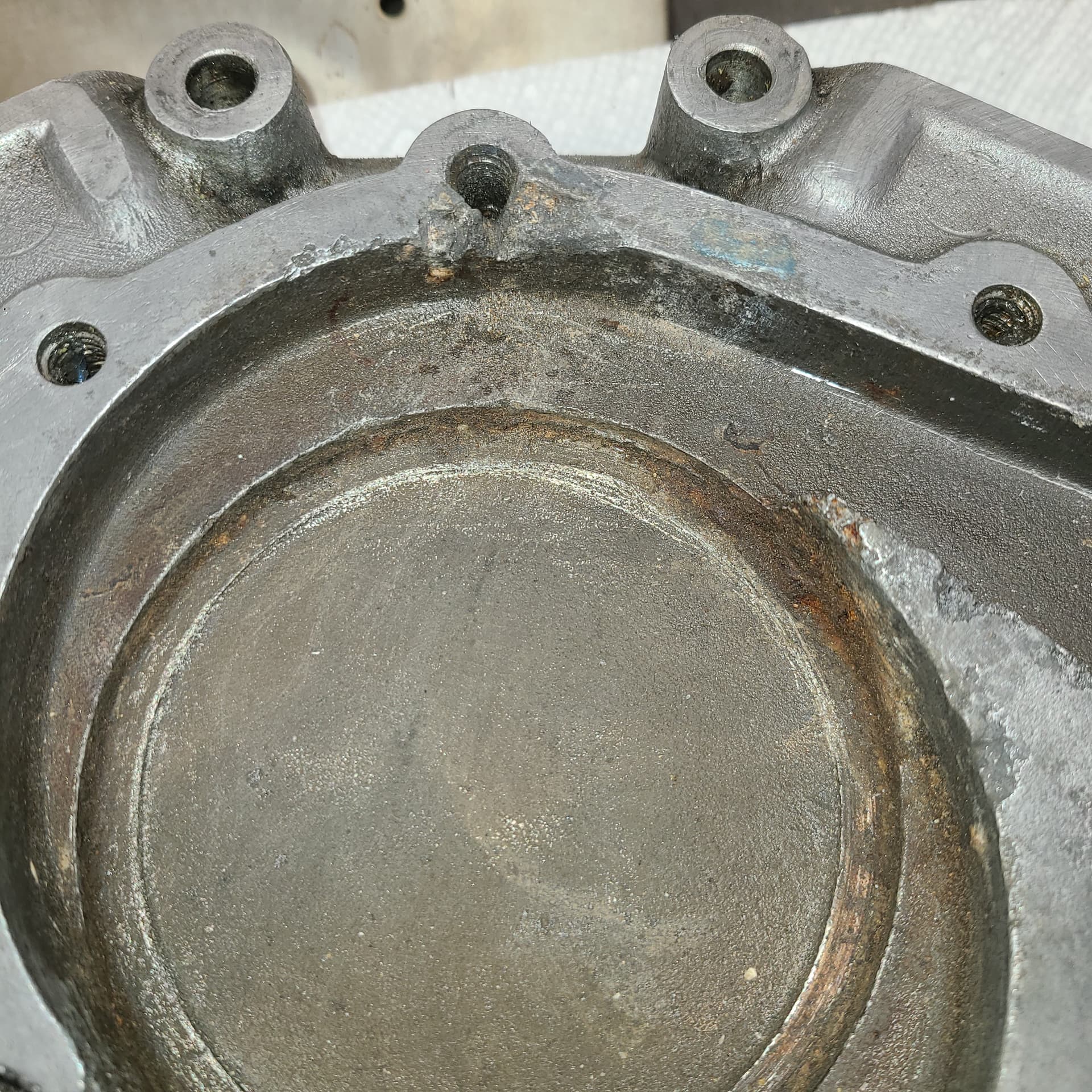

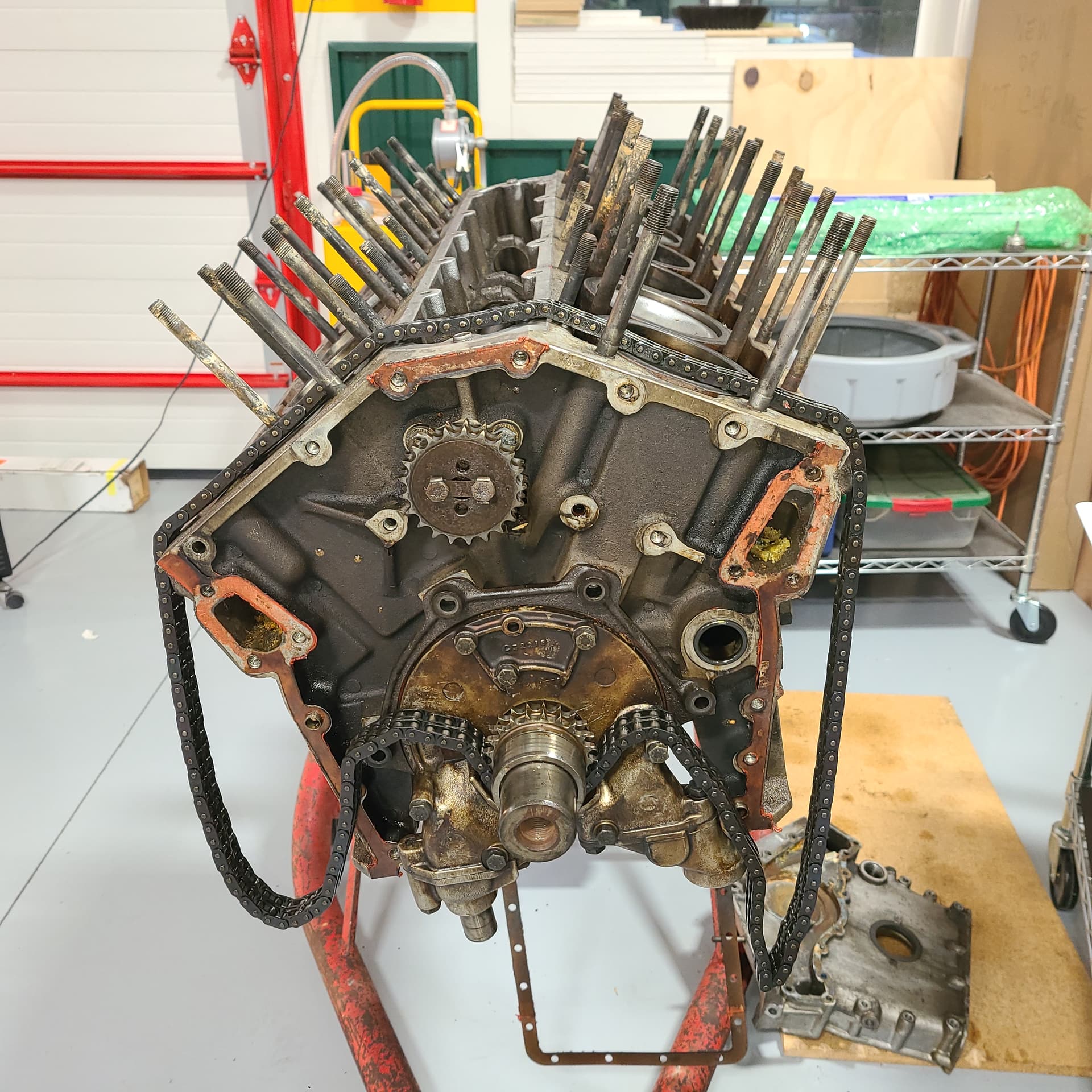

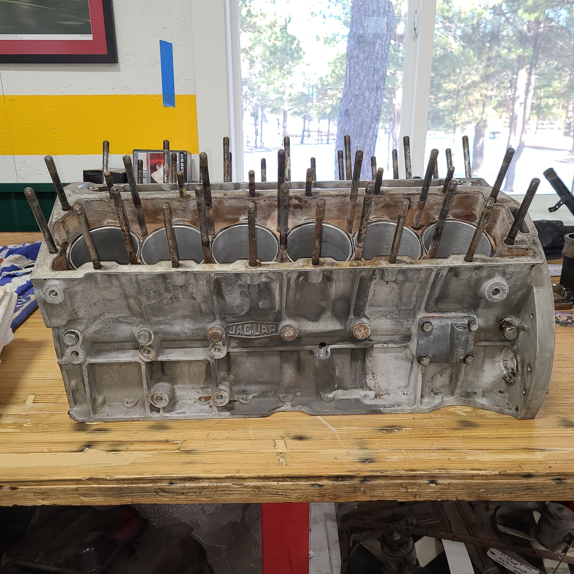

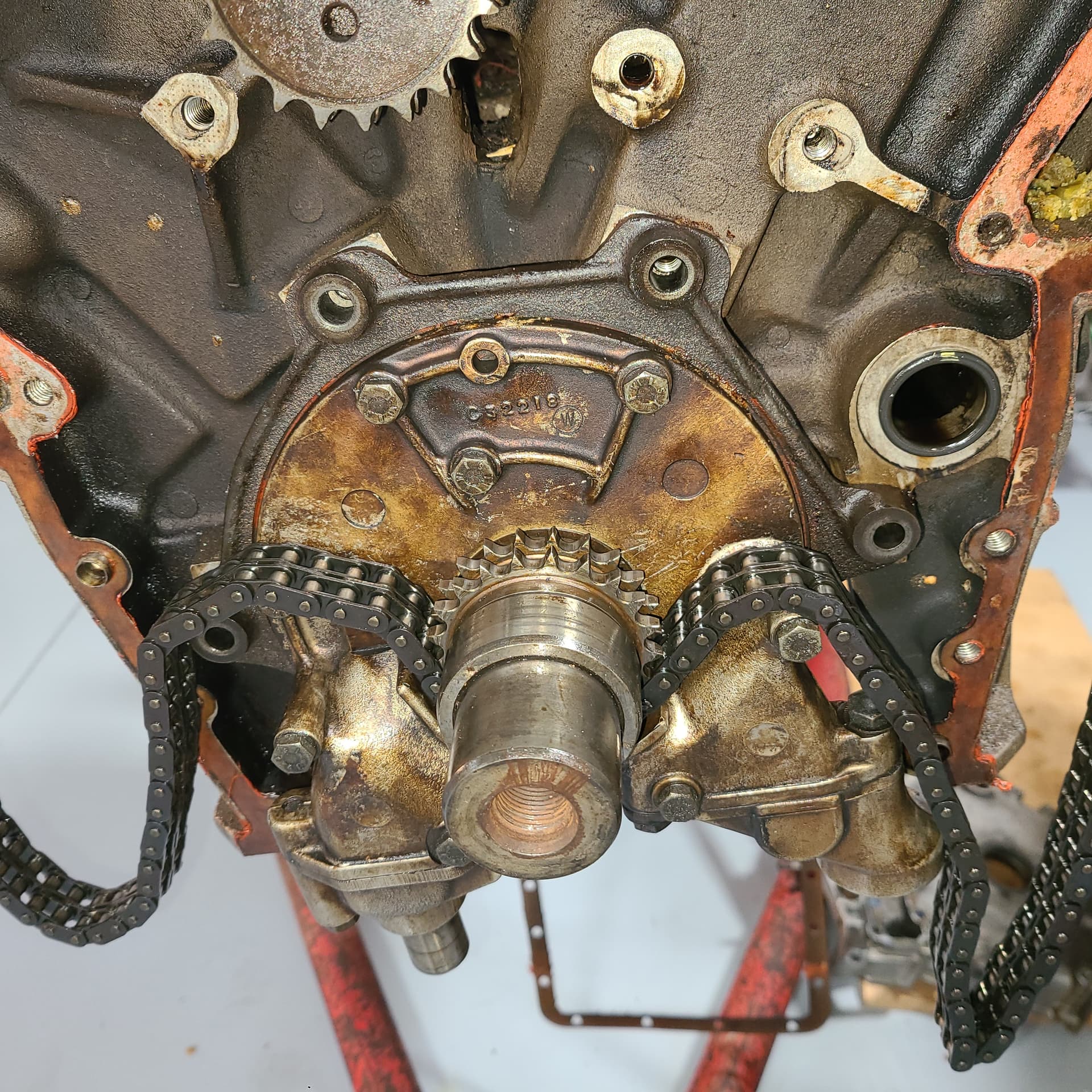

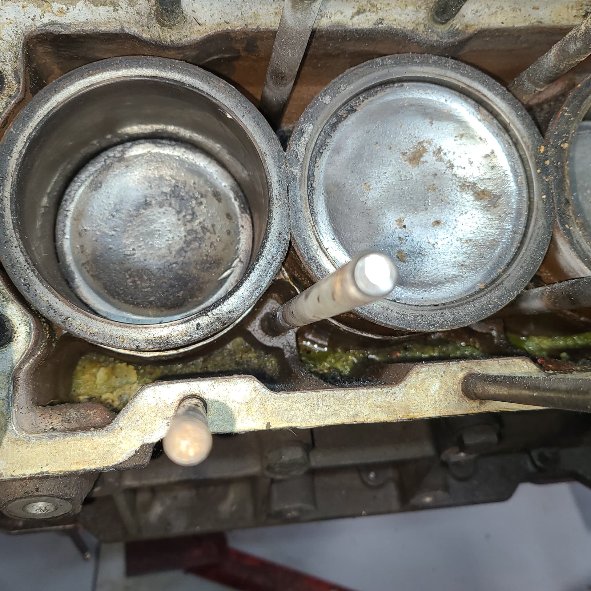

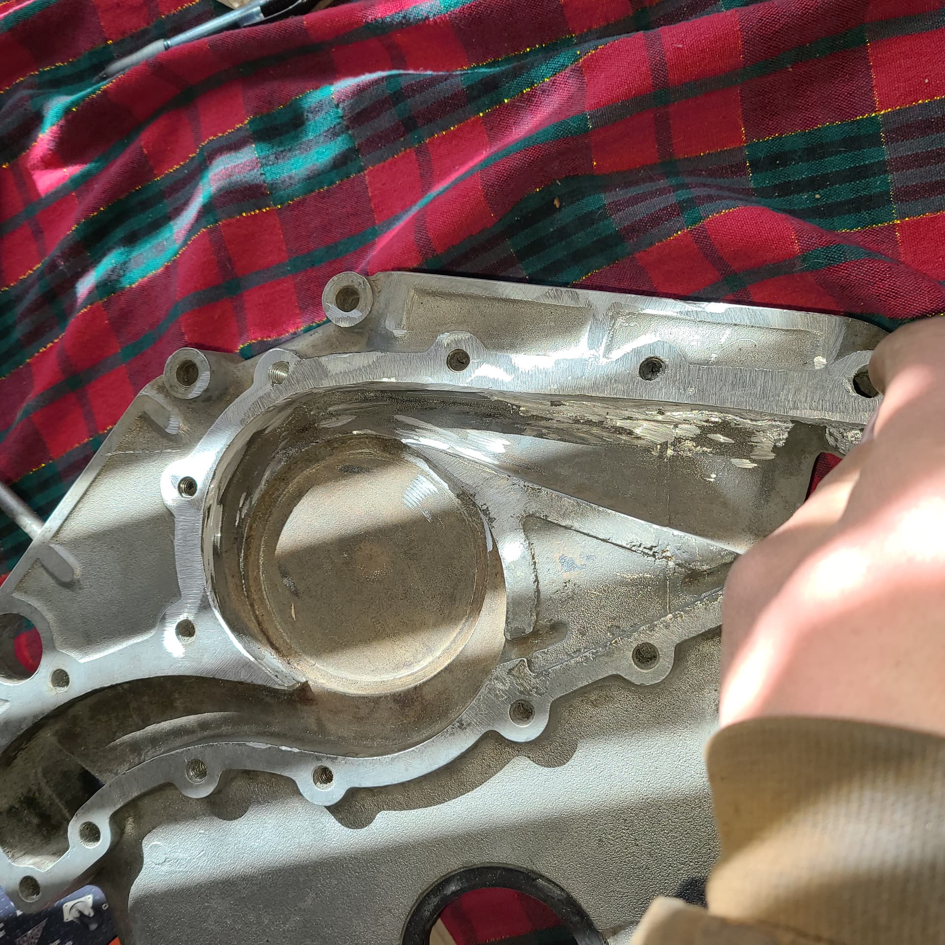

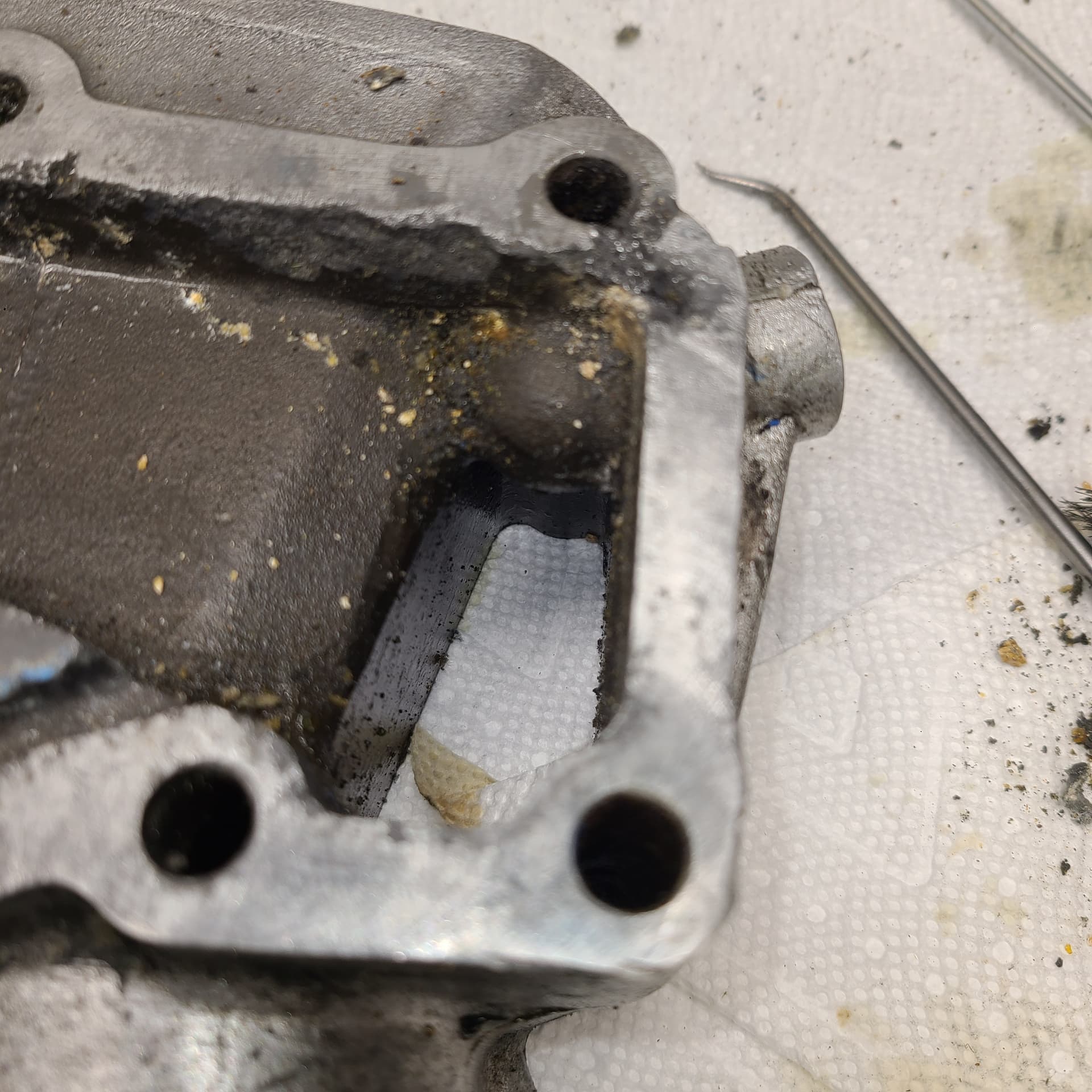

I also pulled off the head gaskets if only to take a see how bad the congealed / dehydrated coolant looked. I took 6-8 photos (mostly for my records) – here are the worst of them:
20211124_1459031920×1920 458 KB
20211124_1459151920×1920 406 KB
20211124_1500161920×1920 412 KB
Some of it is still wet (PB Blaster? – but how? if trickling down the studs I take that as a win; studs ought to come out fairly (cough - cough) easily) and some is dry. I’m thinking it’ll clean up nicely once I pull the pistons and crankshaft – – he said hopefully.

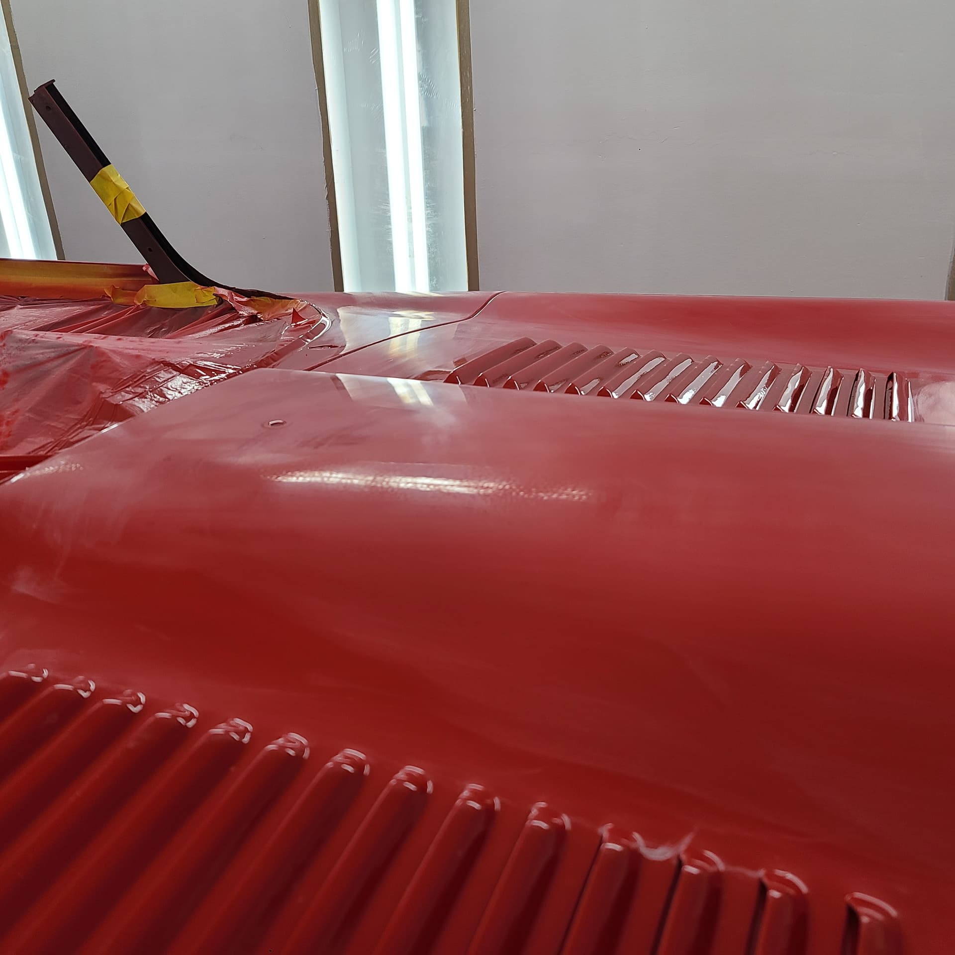

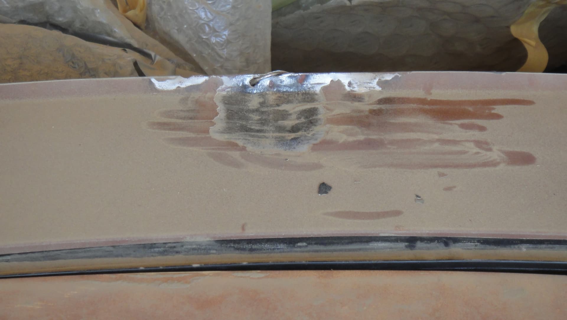

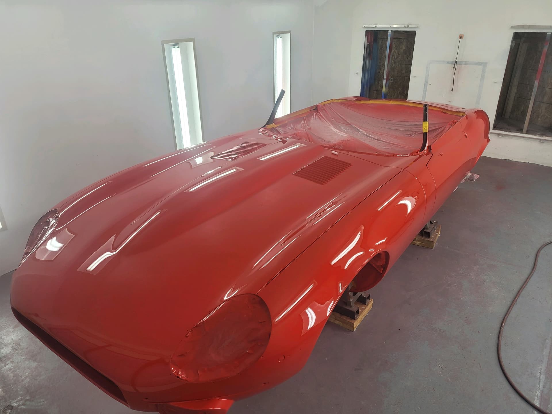

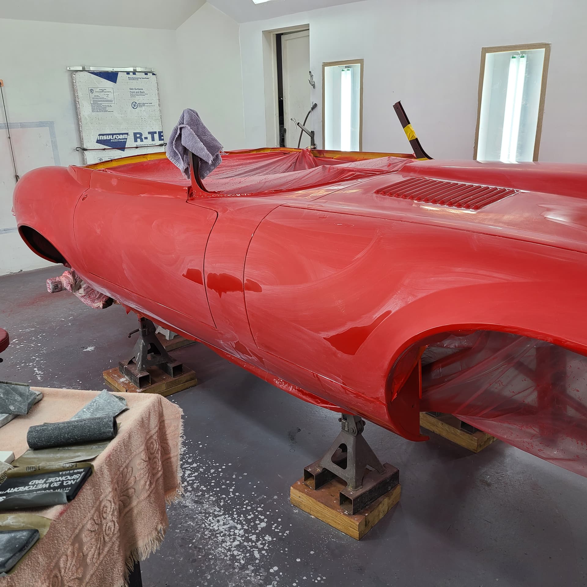

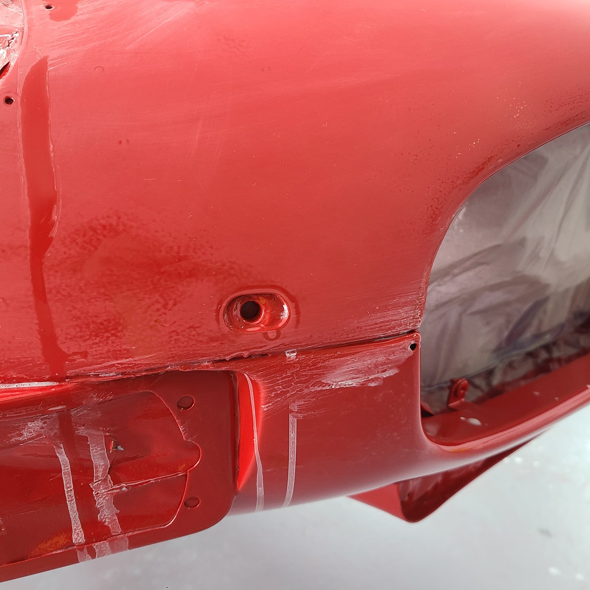

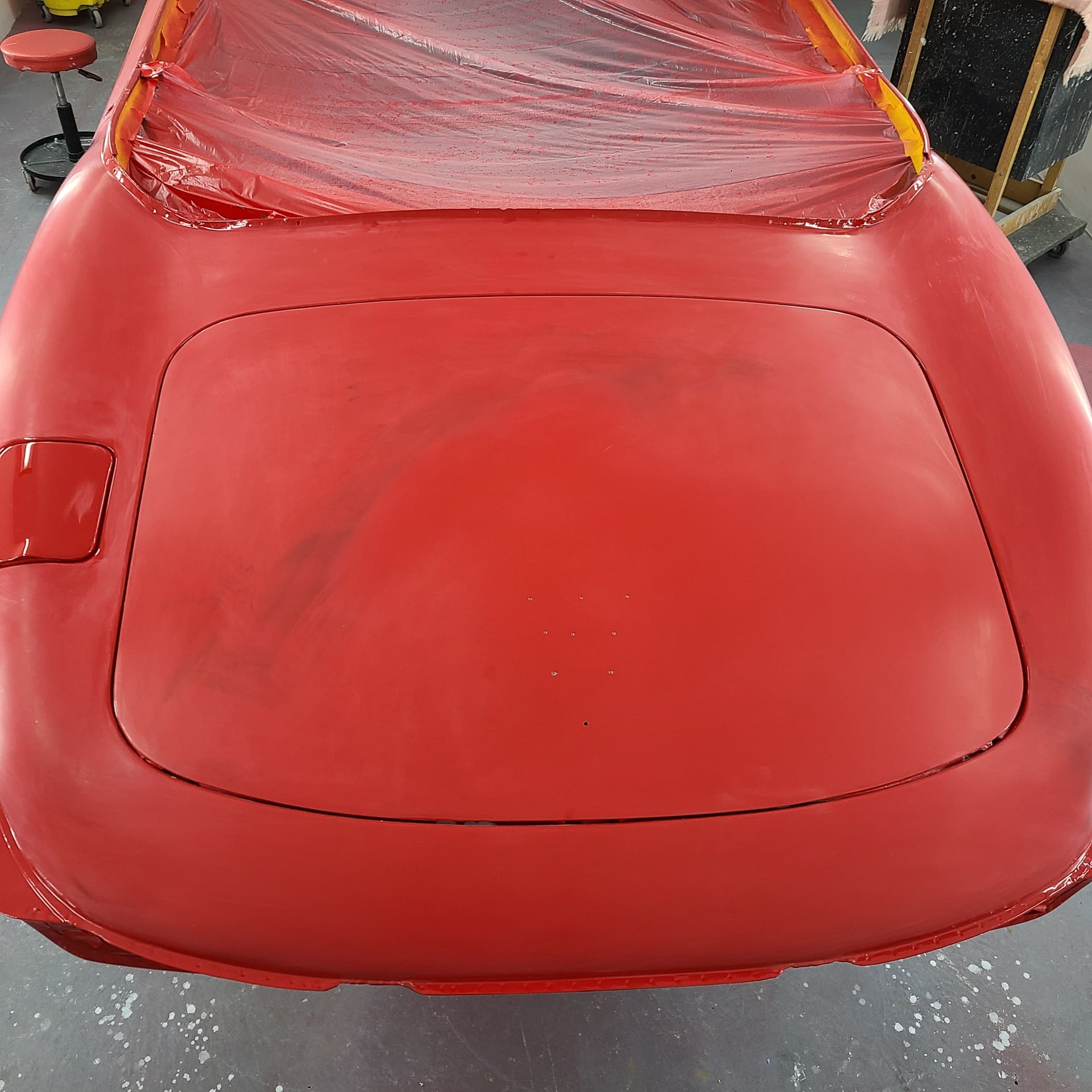

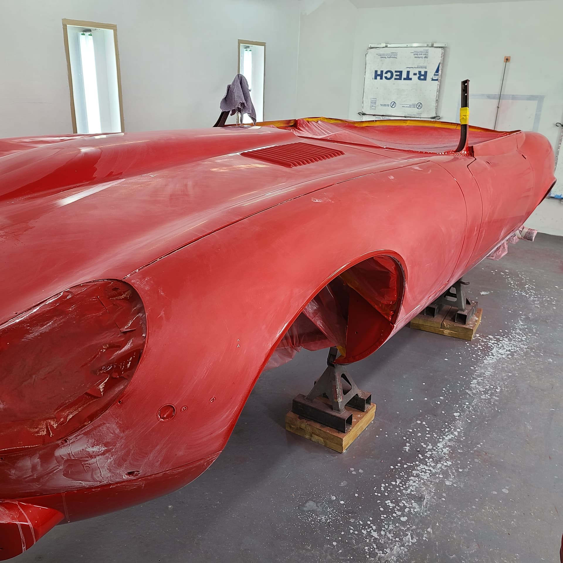

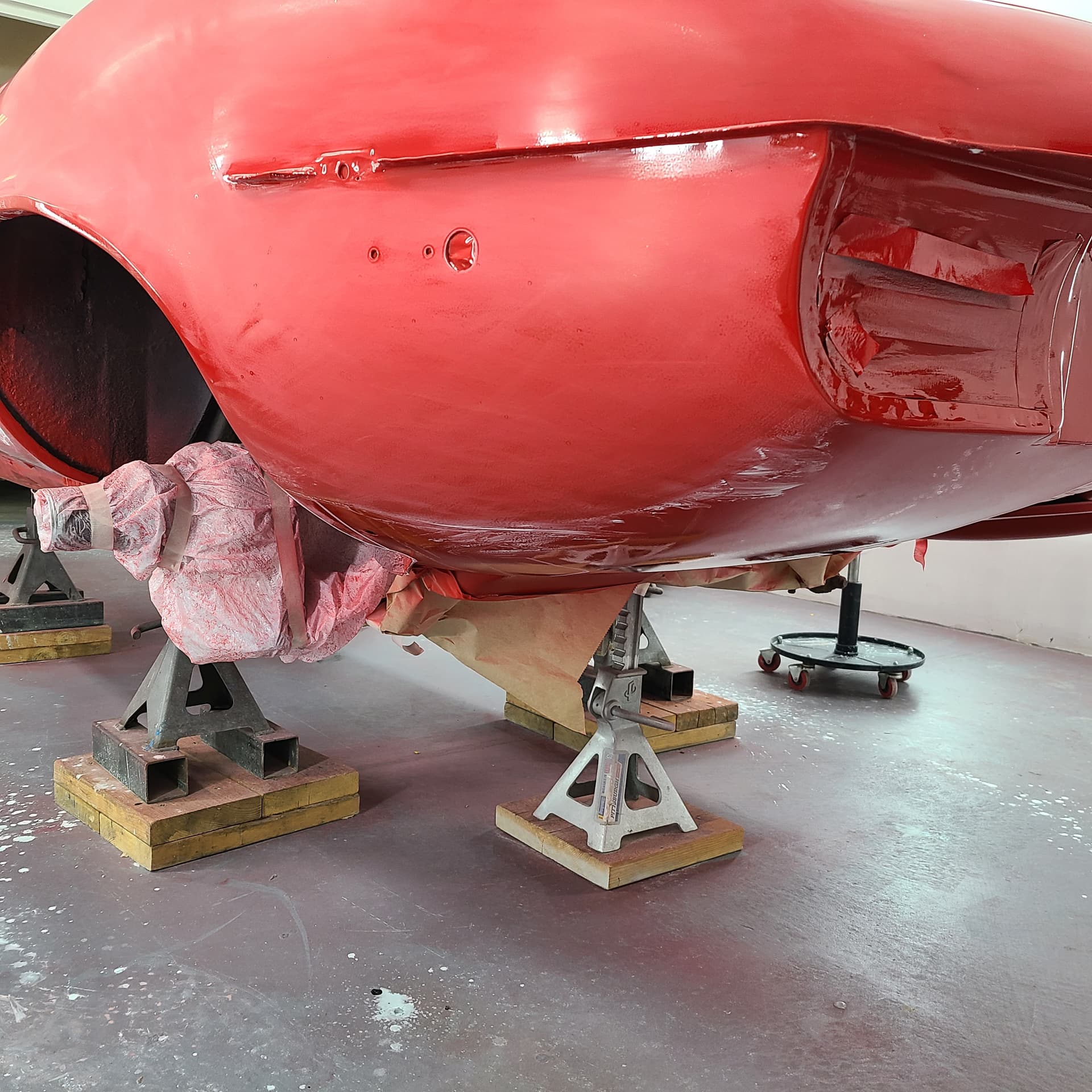

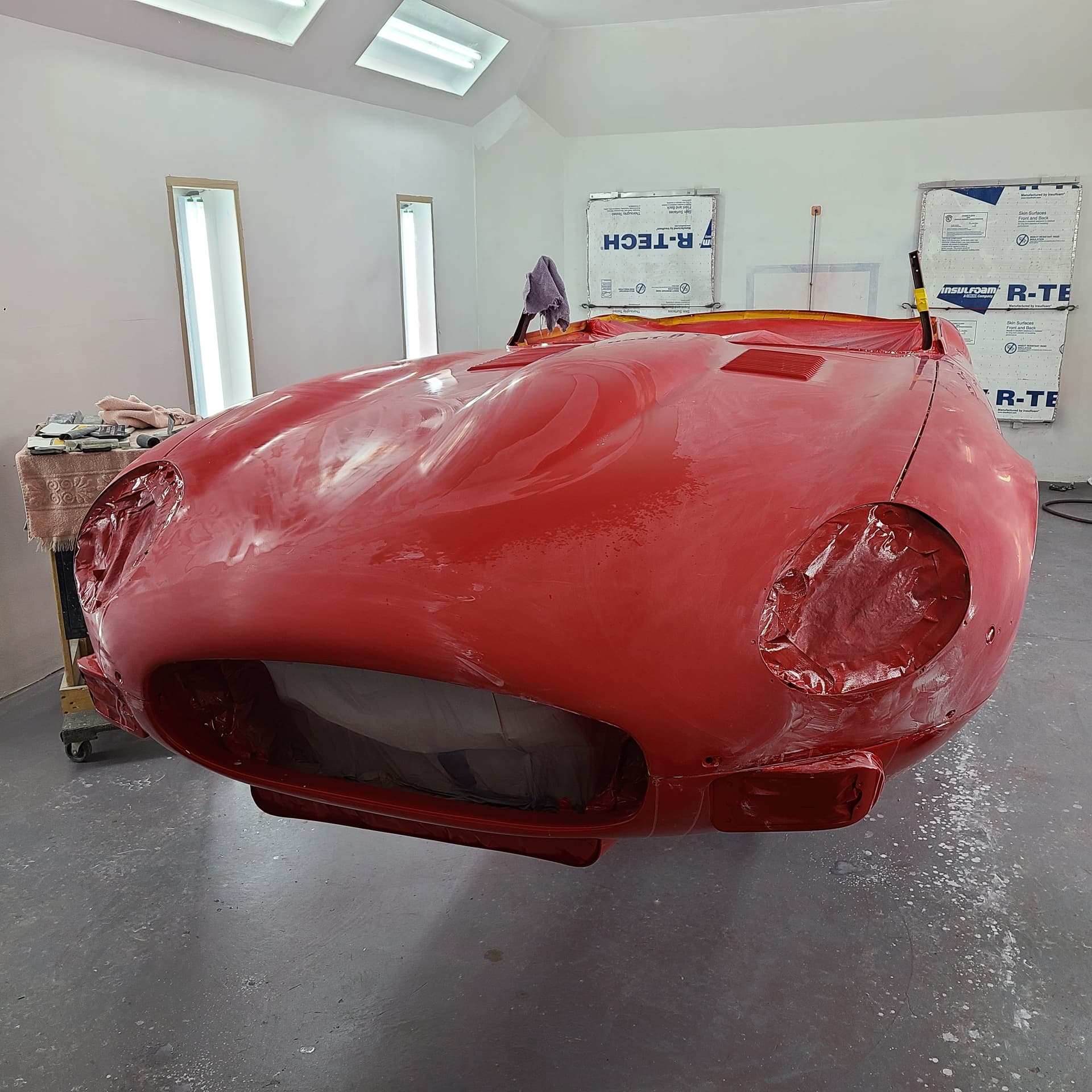

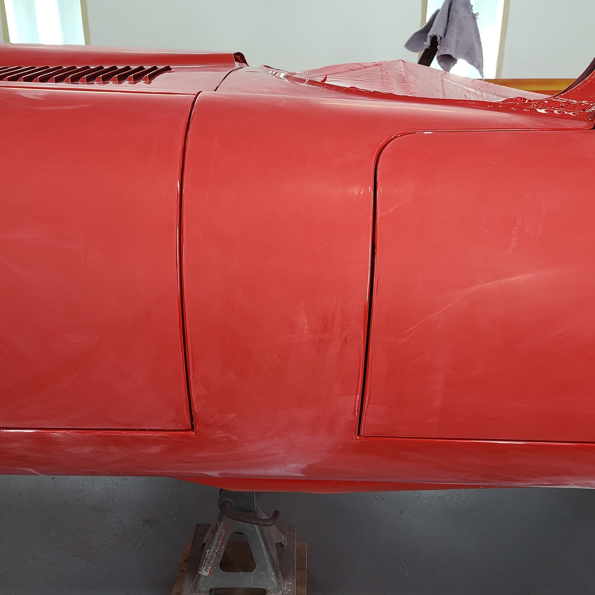

The painter applied 3 color coats and 4 clear coats. At this point, he was wet sanding with 1500 grit paper:
1 - Wet sanding with 1500 grit1920×1920 293 KB
2 - Left Front 3-4 View1920×1920 292 KB
3 - Right Front 3-4 View1920×1920 310 KB
He said he’s going to wet sand with 2000 and then 3000 paper before buffing,

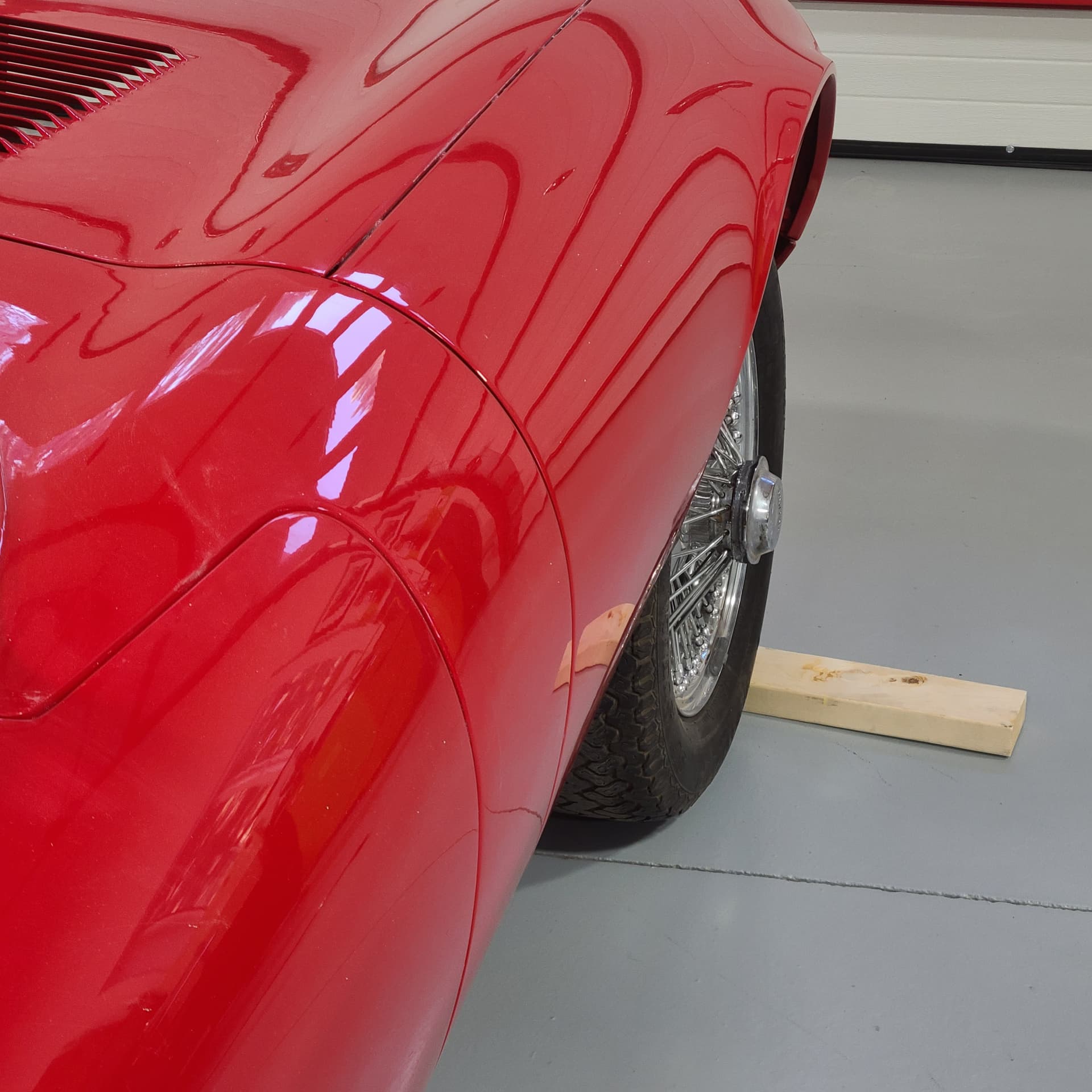

I focused some of my photos on the three areas of body damage

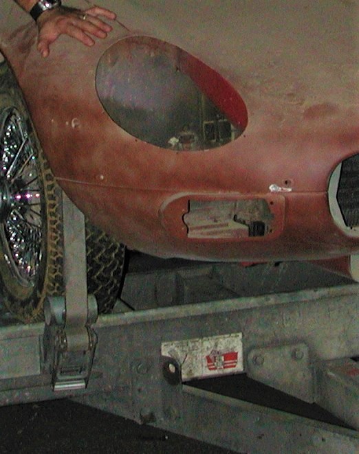

  1. BEFORE - Rub Mark From Bolt Head On Trailer; Jag was snugged too close to front of trailer
    DSCN2179 (2)522×661 85.9 KB
    AFTER - GONE
    4 - Rub Mark from Trailering Phoenix FIXED1920×1920 219 KB
BEFORE - Photo Not Available – I lowered the car on my lift without checking placement of a Home Depot 5-gallon pail. I put a dent under the LR fender that was 1/3 to 1/2 the size/depth of a basketball.
AFTER
5 - Dent under LR Wing from HD 5-Gallon pail FIXED1920×1920 339 KB
BEFORE - This dent (at the mid-point of the rearmost panel of the passenger compartment – between the attaching points for the hood and the boot opening) was caused by an unfastened gusset on a plastic tarp I tied over passenger compartment when foul weather threatened while moving my Jag from Phoenix to C Springs. About the size of a hardball and 3/4" deep
14 - Rear View1920×1082 155 KB
15 - Close Up Rear Scutle Damage1920×1082 99 KB
AFTER - The metal was stretched such that the painter had to cut a slice in the middle of the dent, straighten the dent, and then weld the slice closed. I suspect a dab of Bondo was involved
6 - Dent from Flapping Tarp Trailering from Phoenix FIXED1920×1920 233 KB
7 - Dent from Flapping Tarp Trailering from Phoenix - side view FIXED1920×1920 116 KB

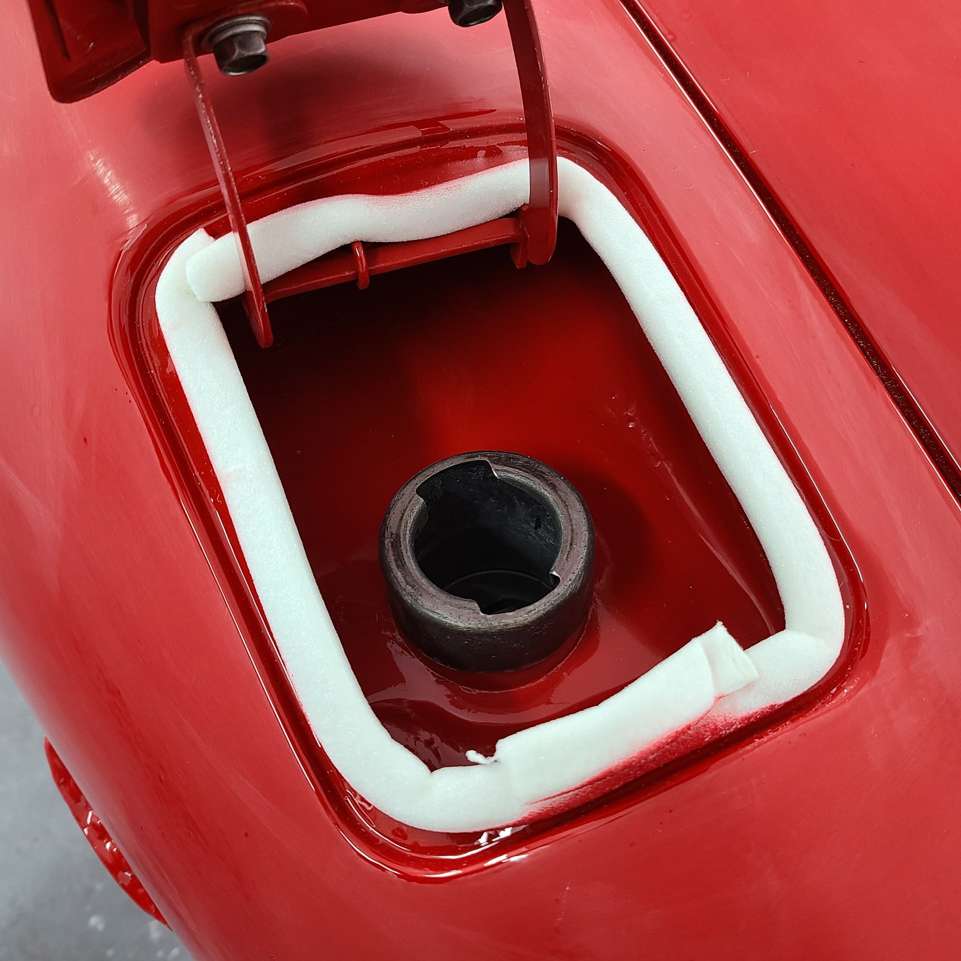

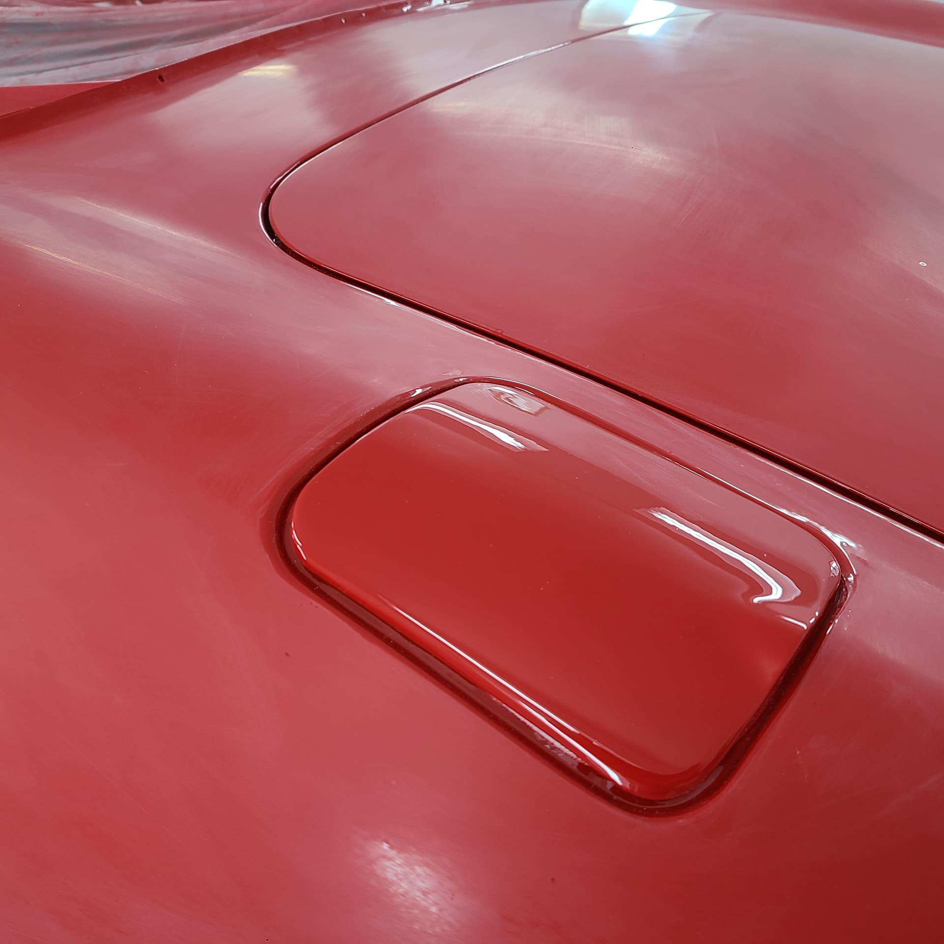

The next 4 shots (including the above shot of the repaired dent forward of the boot lid opening) focused on the gaps between body panels. (The captions tell the details.)
8 - Body Gap FuelLid & Wet Sanding of Deck Lid While Filler Cap Lid is asyet Untouched1920×1920 127 KB
9a - Under Fuel Cap Lid1920×1920 234 KB
9 - Body Gaps - Boot Lid1920×1920 235 KB
10 -Body Gaps - driver Side bonnetg & Door vis-a-vis Body1920×1920 160 KB
11 - Very Minor Orange Peel on Bonnet Bulge1920×1920 148 KB
After the painter completes the wet sanding with 2000 and then 3000 grit paper and buffing, he still needs to paint some small bits: steering column shaft, sugar scoops, the cross bar on the horseshoe, 2x cross tubes under the spaceframes, etc.

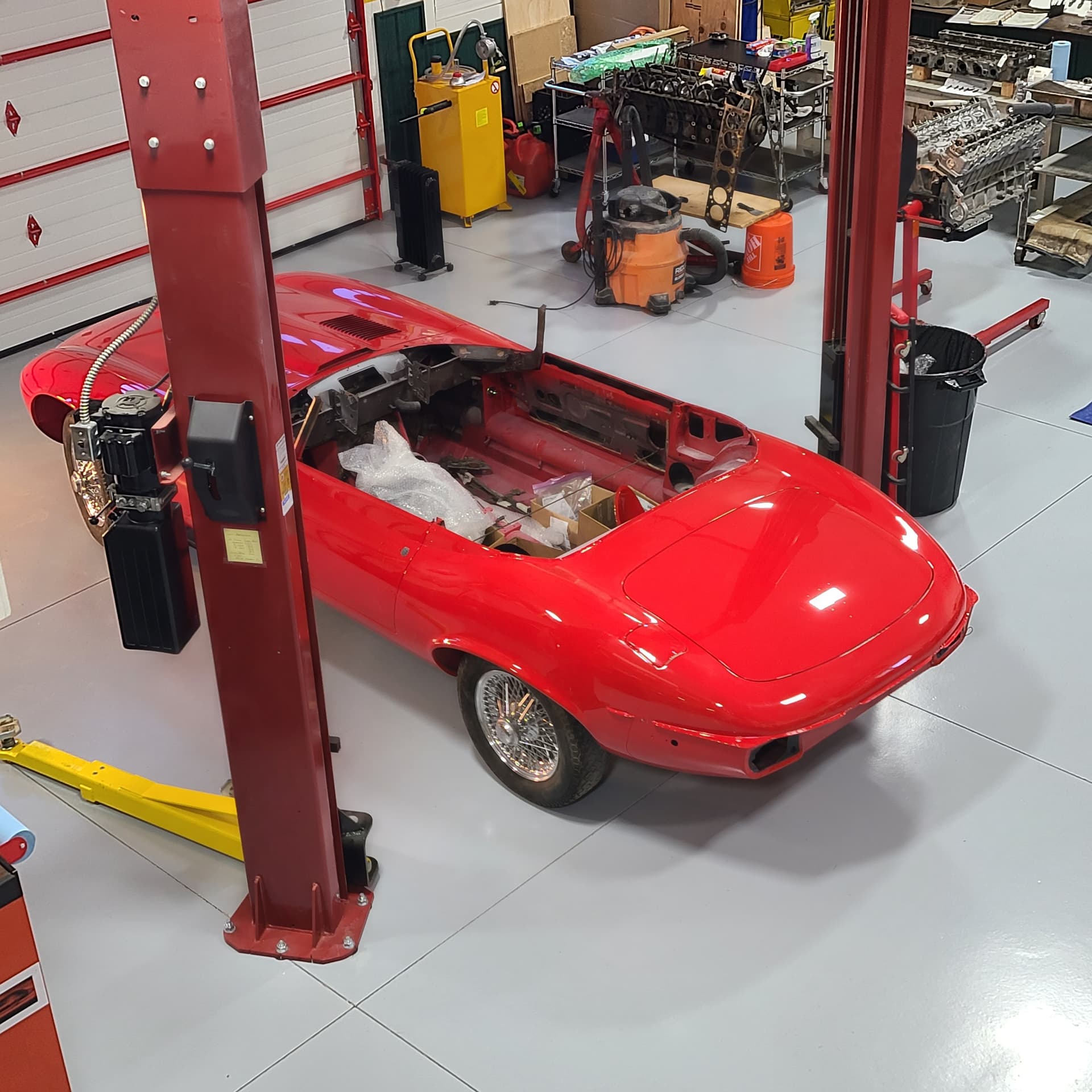

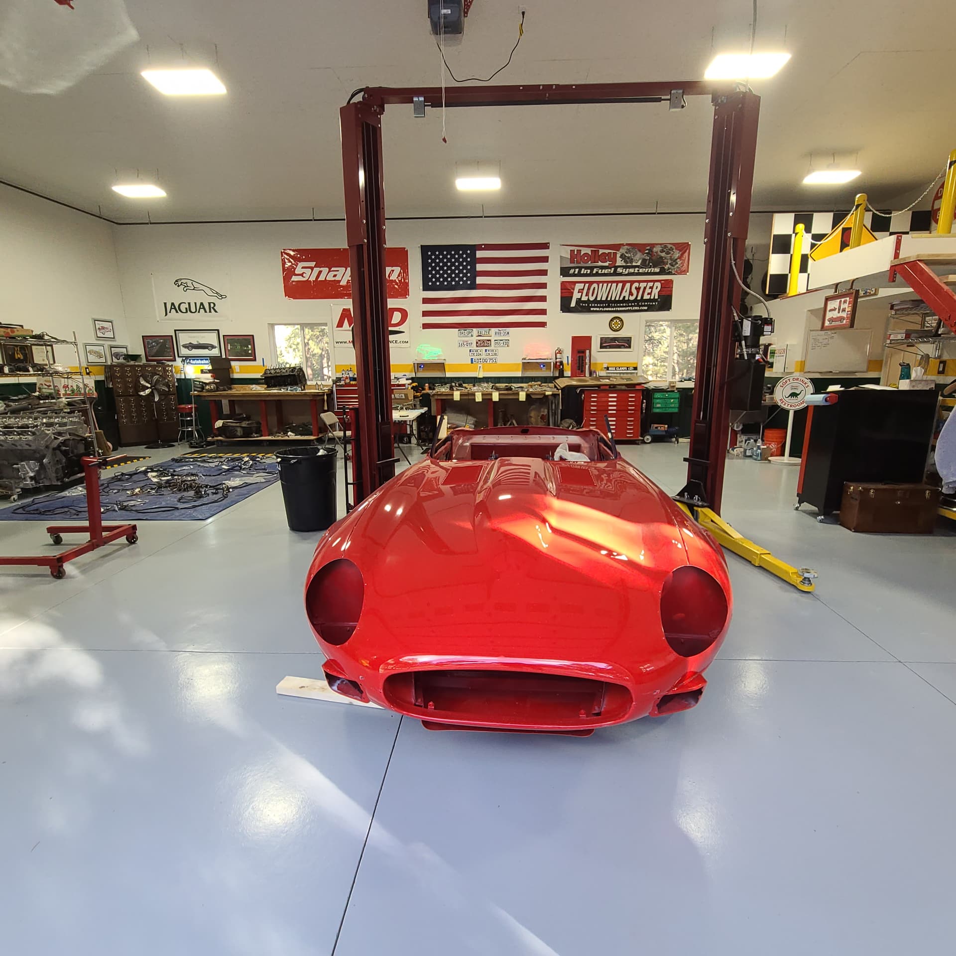

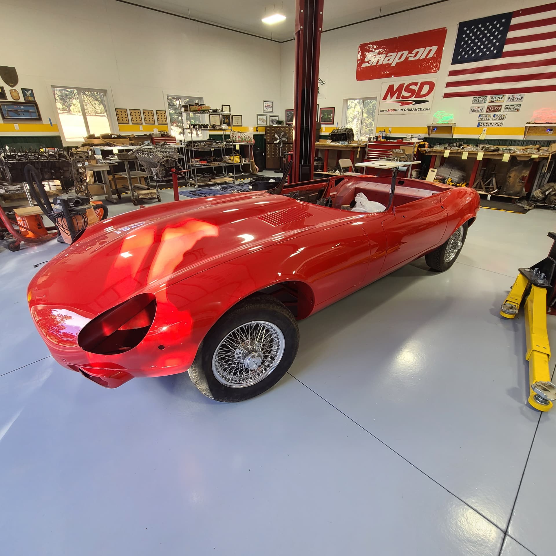

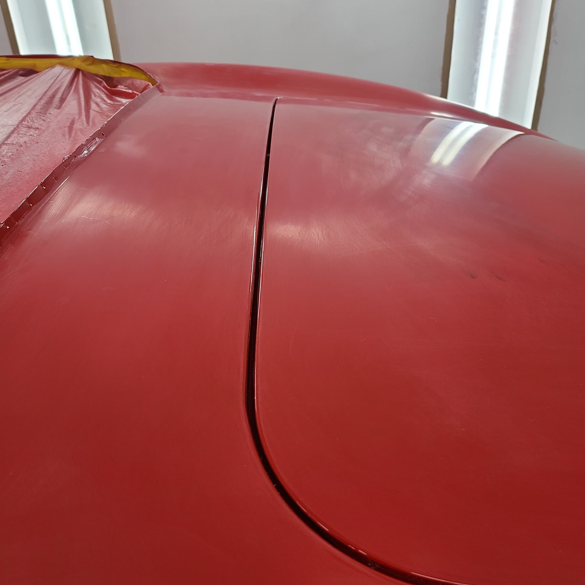

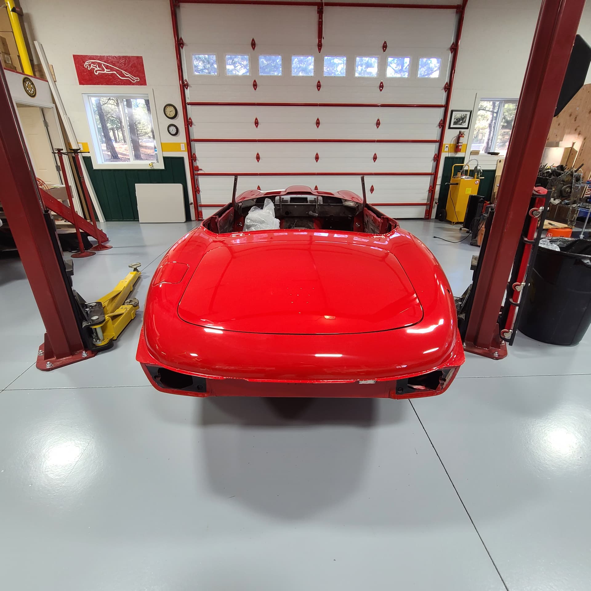

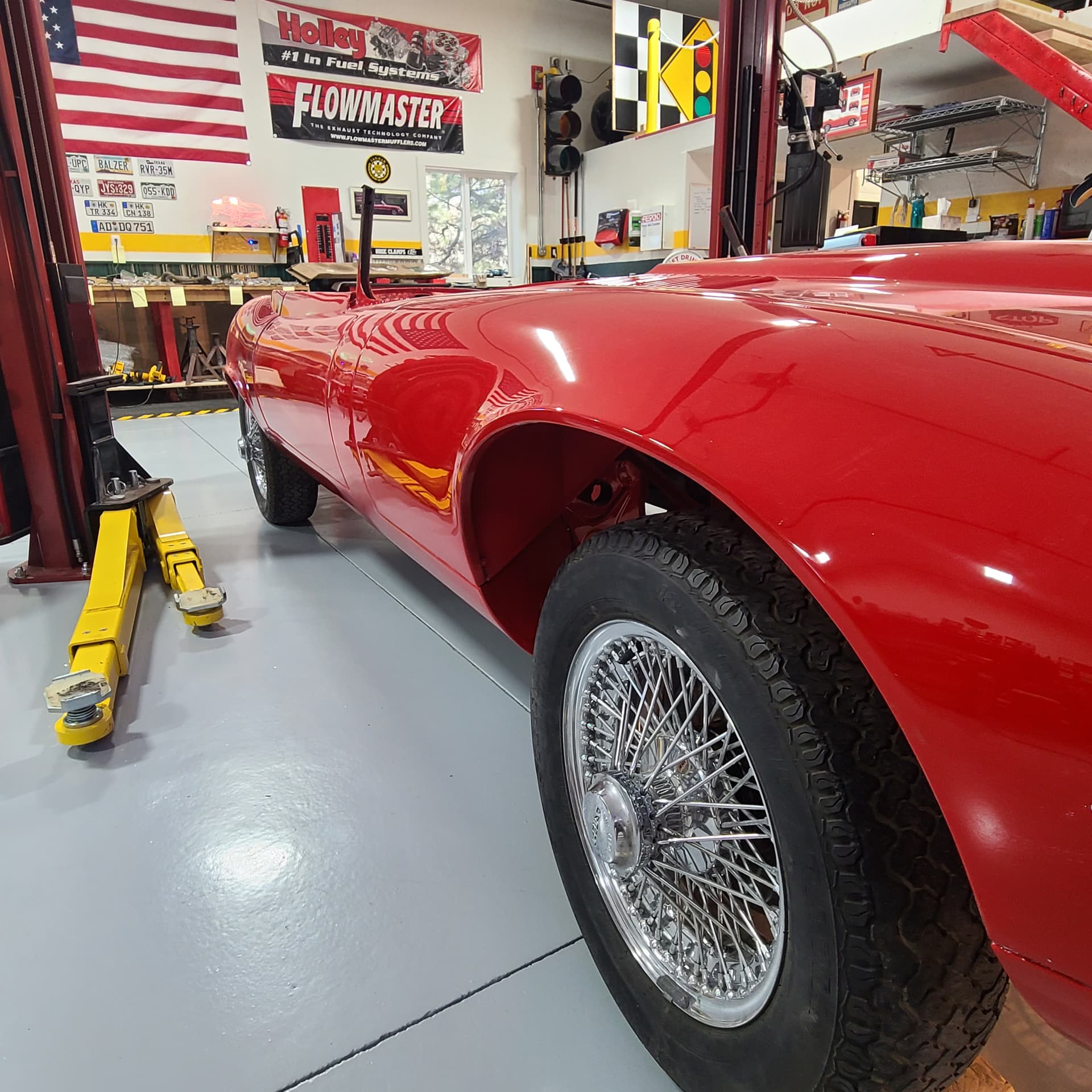

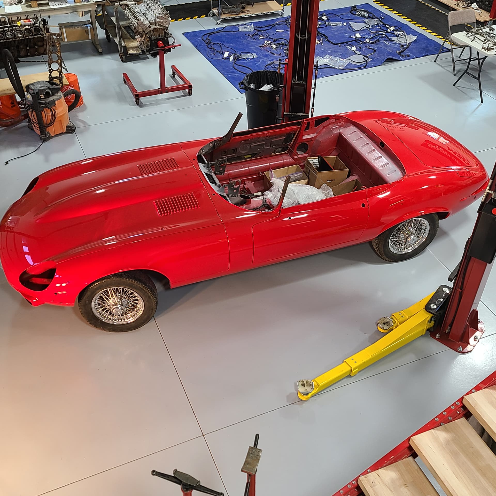

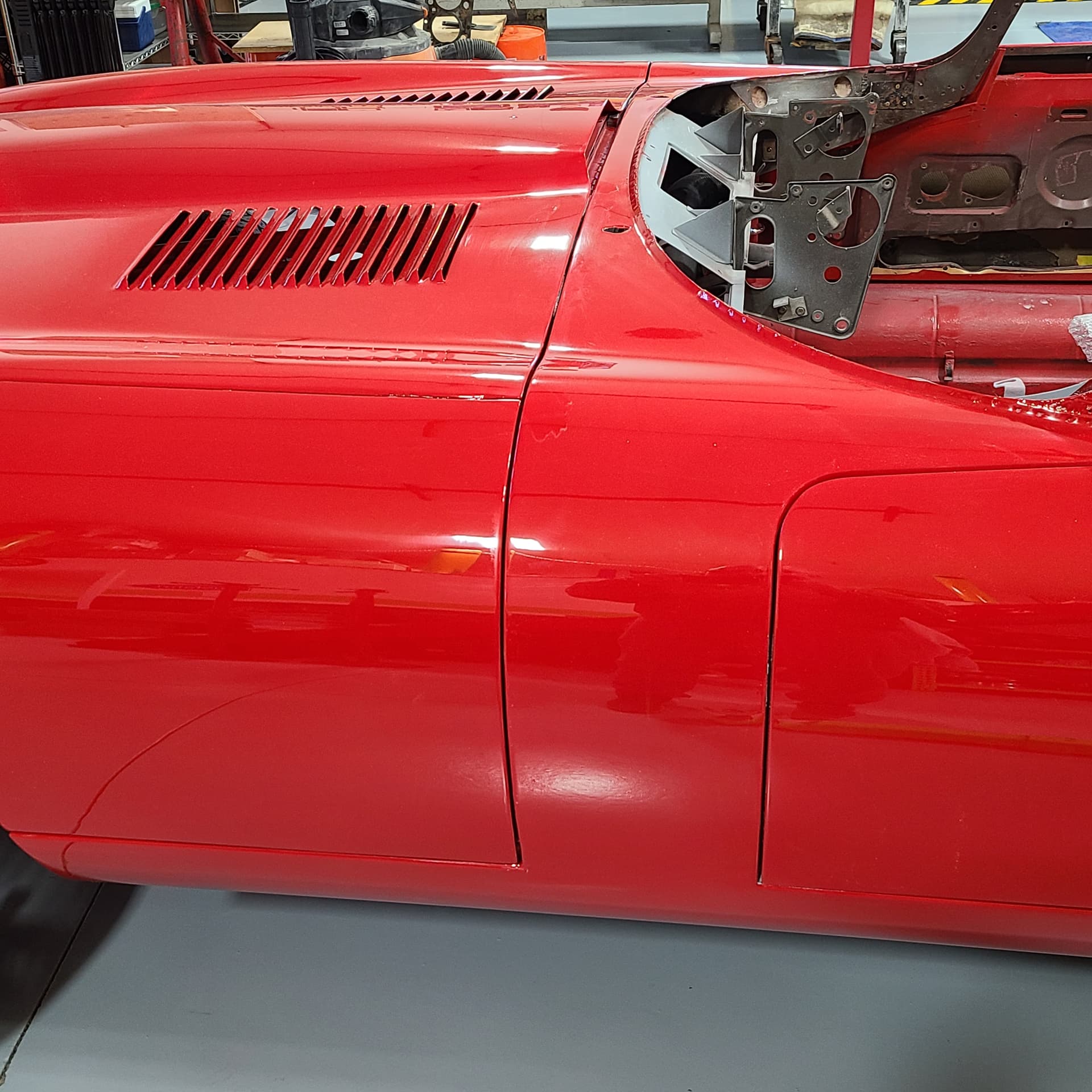

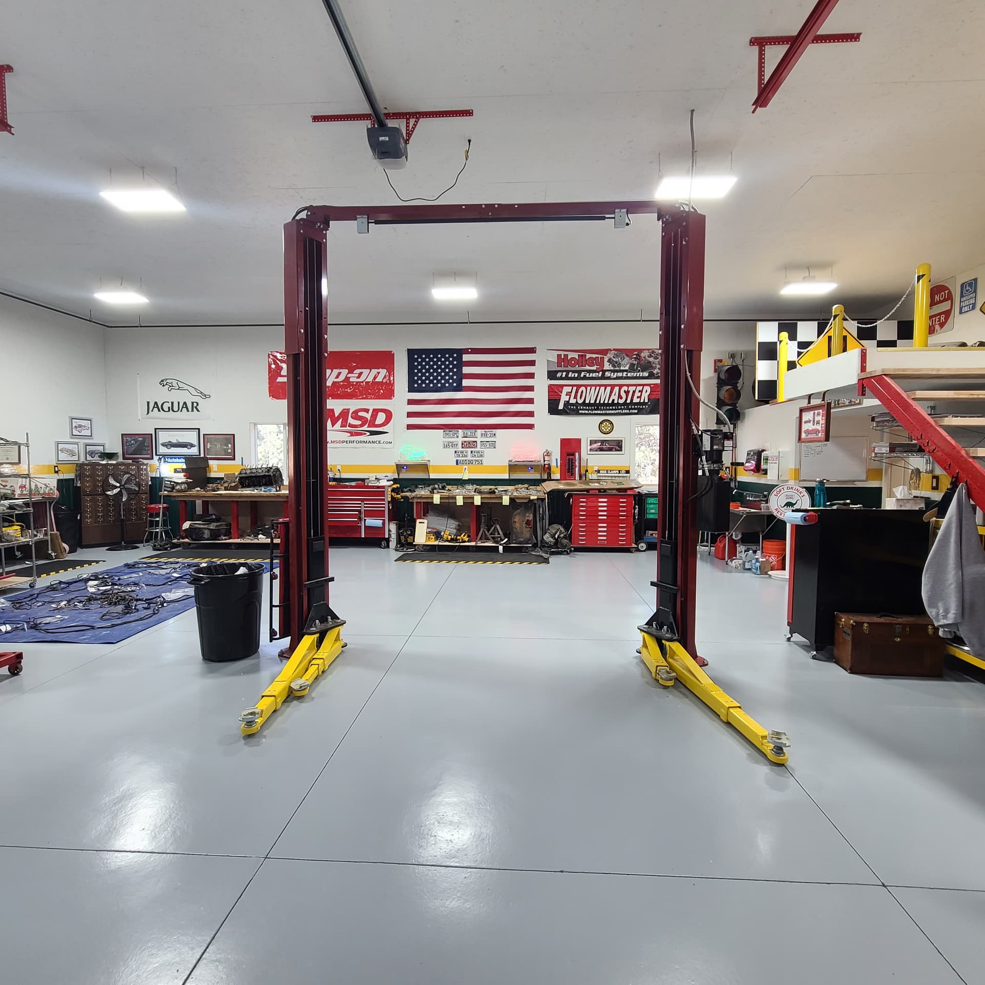

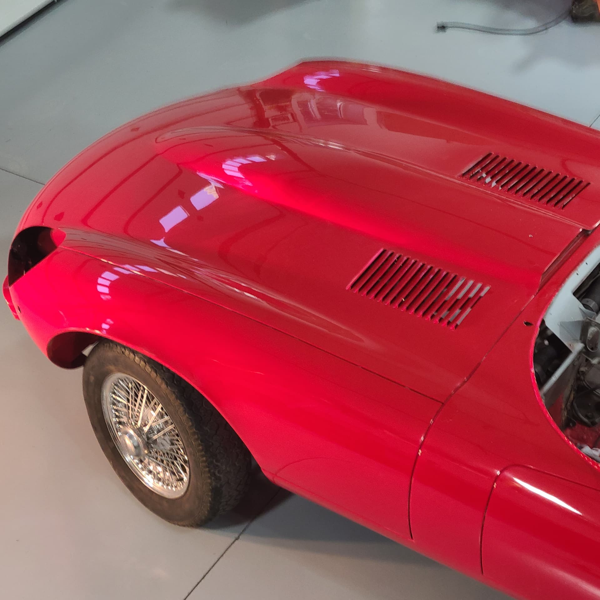

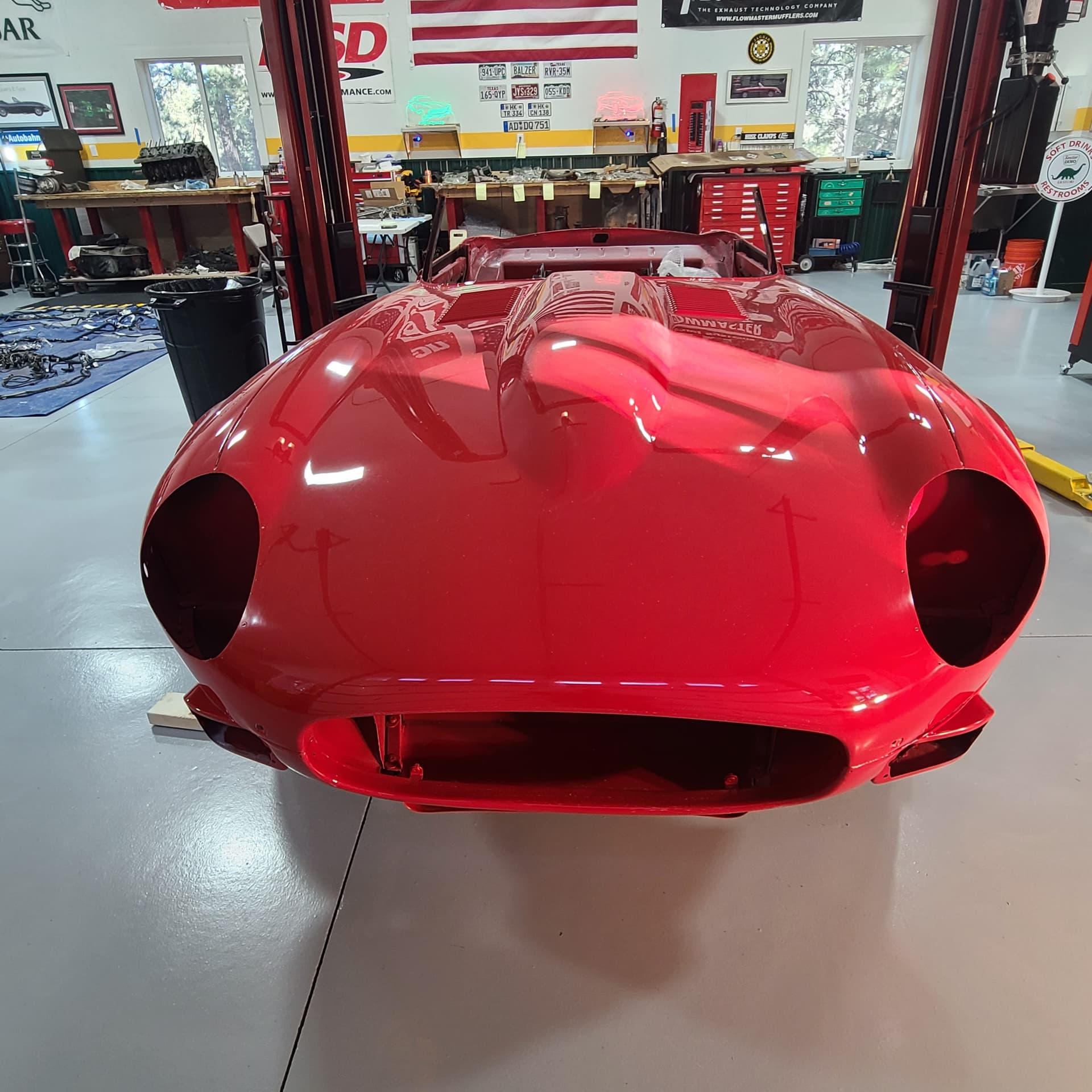

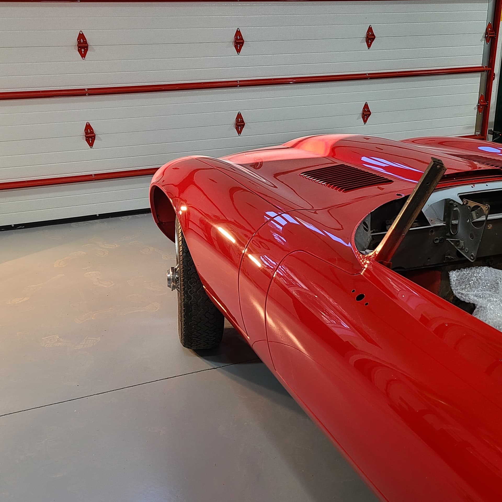

On Saturday 11DEC21 at 1:30PM the painter backed into the drive to my Hobby Shop and delivered my RED Series III OTS. To me – each photo looks new and fresh and different. I suspect that these photos will all look alike to most (kinda like watching (suffering through) your neighbor’s vacation photos/slides). So – sit back – take a gander – try to stay awake.
Each photo is captioned
1 - I cleaned up so the garage was as clean and fresh as the Jag1920×1920 260 KB
2 - It Home Its Red and it needs everythingput back1920×1920 262 KB
3 - Three Quarter Front View1920×1920 299 KB
4 - The Back End1920×1920 241 KB
This is one of my favorite shots: the powder coated garage door reinforcing rails are reflected in the red paint and flare upward/outward as they flow along the curves of the bonnet
5 - The Reflection Lines are Nice and Straight1920×1920 200 KB
5a -The Reflection Lines are Nice and Straight1920×1920 254 KB
5b -The Reflection Lines are Nice and Straight1920×1920 337 KB
6 - Shut Lines Look Pretty Nice1920×1920 291 KB
7 - Now I Gotta figure out HOW TO INSTALL THE Sugar Scoops -- I didnt take them out1920×1920 285 KB
8 - From Above1920×1920 335 KB
9 - Behinbd - From Above1920×1920 282 KB
10 - The Bonnet from Above1920×1920 195 KB

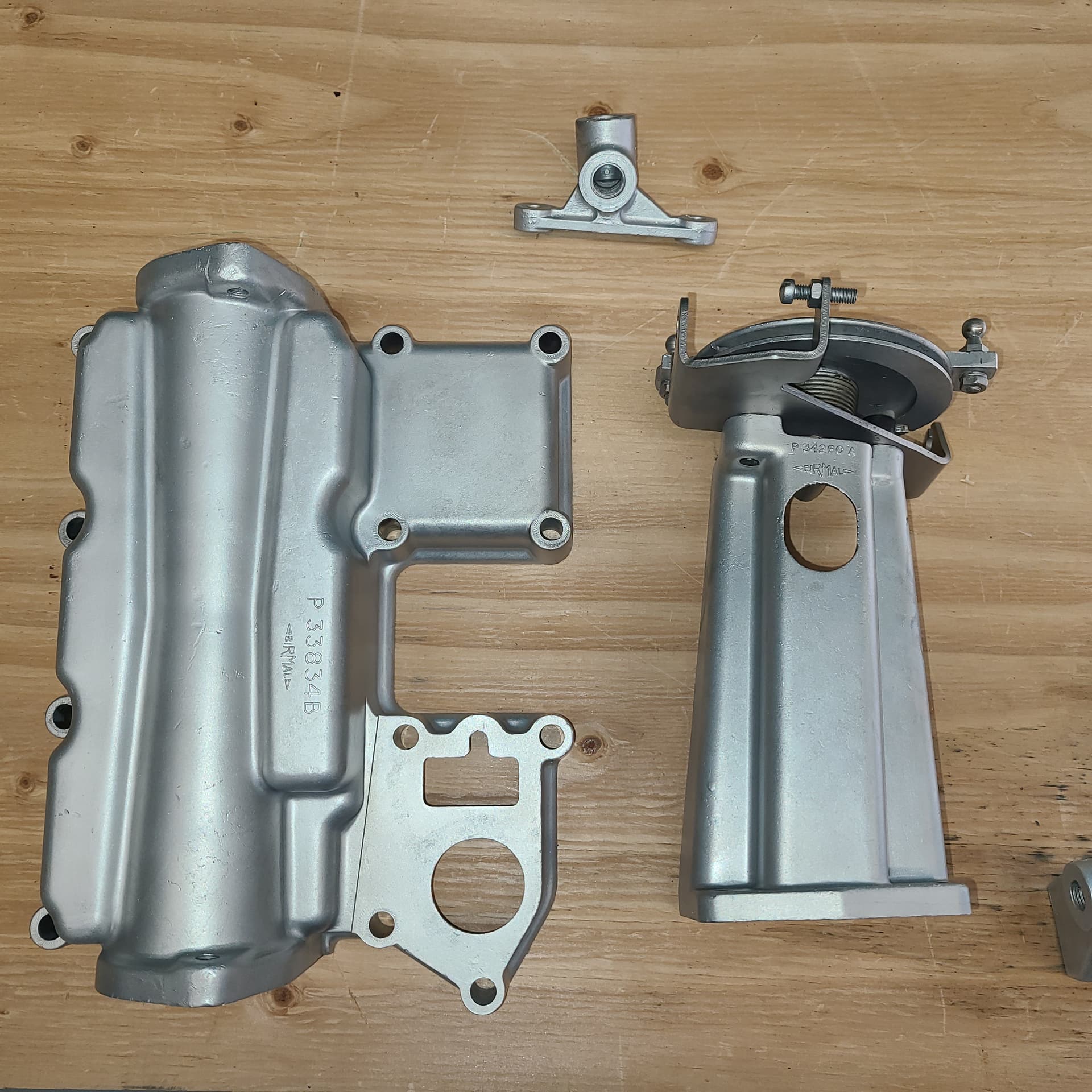

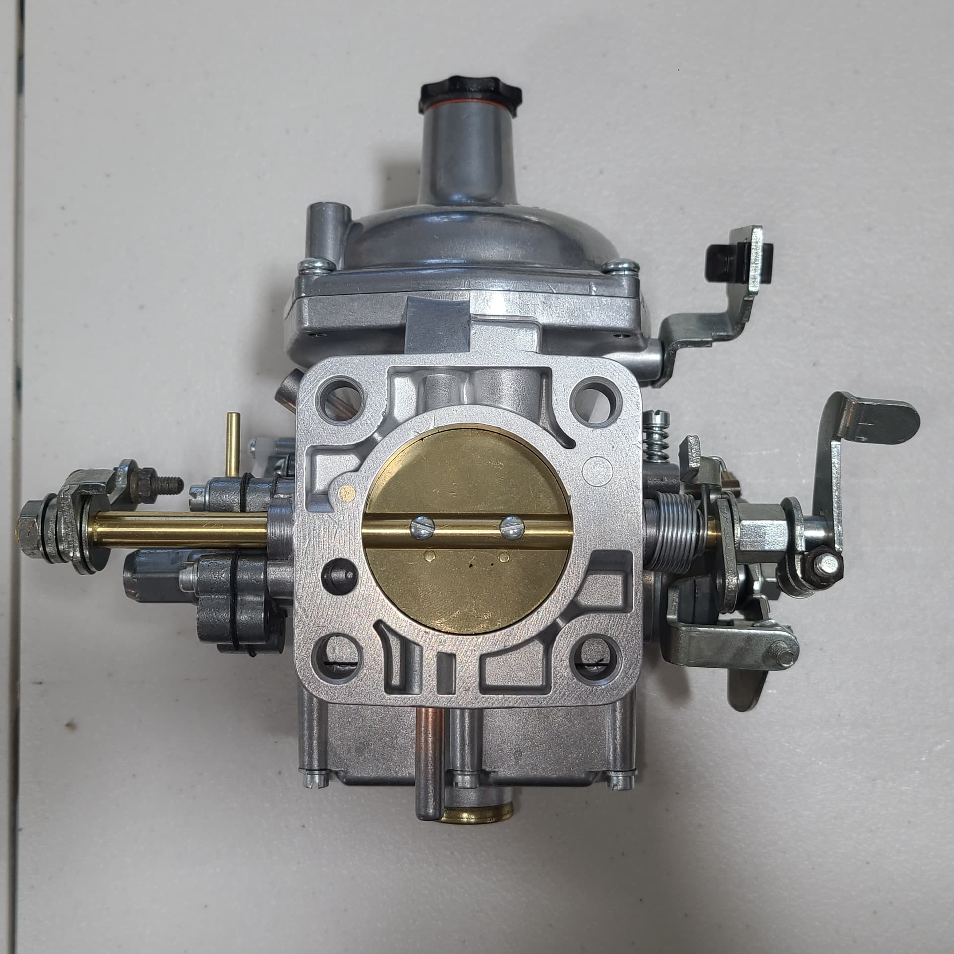

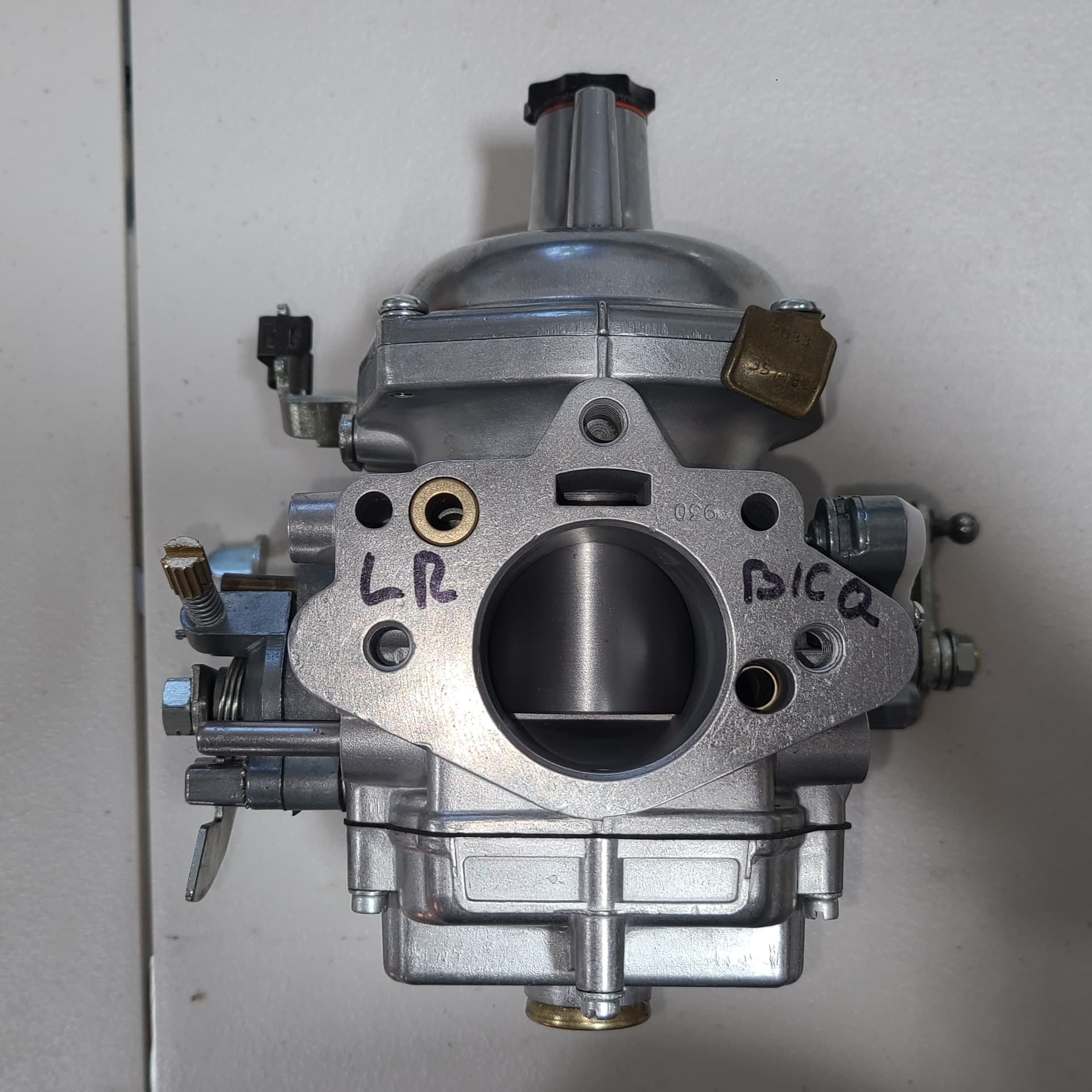

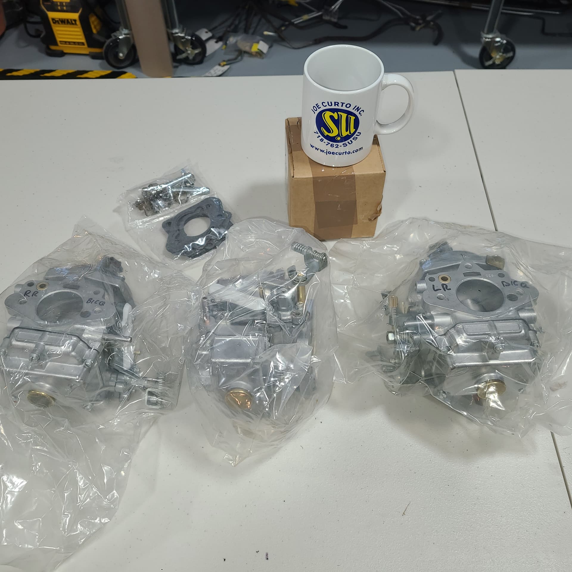

February 2022: Joe Curto, an expert in SU and Stromberg side draft carbs, finished the rebuild/restoration of my four carburetors. He needed to replace at least 1 float, at least 1 vacuum adjuster screw, several lock screws. I am sure there were more issues but these were the highlights. The carbs sat for 32 years unused in the AZ desert and the CO high desert plain.
He had called during the previous week and referred me to Rob Medynski (sp?) (*) whose expertise is rebuilding dizzies and converting them to vacuum advance. As part of the rebuild, Rob drills and taps a port in the proper location of one of the carbs to get the vacuum to the dizzy. Joe sent one of my carbs, after his rebuild, to Rob.
This photo shows the driver's side pair of carbs on the dusty, rusty engine
Each rebuilt carb was packaged in its own box, enclosed in a vacuum-sealed bag, and nestled in scrunched up newspaper. Very secure.
I unboxed each of the three carbs (Joe sent my Right Front carb to the guy doing the rebuild/upgrade of my dizzy to machine a port of the vacuum advance). Oddly - there was a fourth box smaller than the others. Hmmm – left over parts? (not likely) Return of replaced components (unnecessary). A Joe Curto Coffee Mug. Nice touch
20220214_1701351920×1920 245 KB
Each carb was labeled as to its position on the engine and the needle size – all three have B1CQ.
I only unbagged the one.
20220214_1703031920×1920 256 KB
I’m not an expert but it looks and feels like Joe vapor blasted the carbs.
He apparently plated or cad plated the bell cranks and other small bits
20220214_1703371920×1920 308 KB
20220214_1703501920×1920 261 KB
If they work half as well as they look, I’ll be a happy camper.

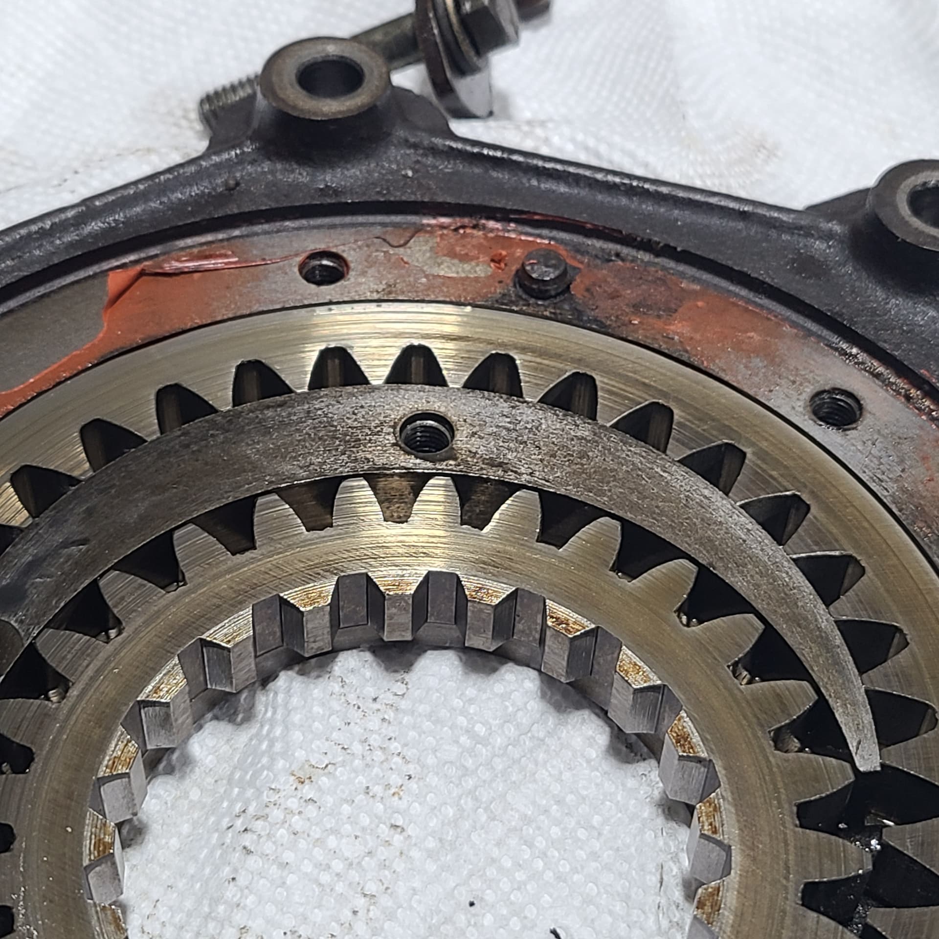

01MAR22: I did turn a “corner” in that I put the first thing back on my Jag today.

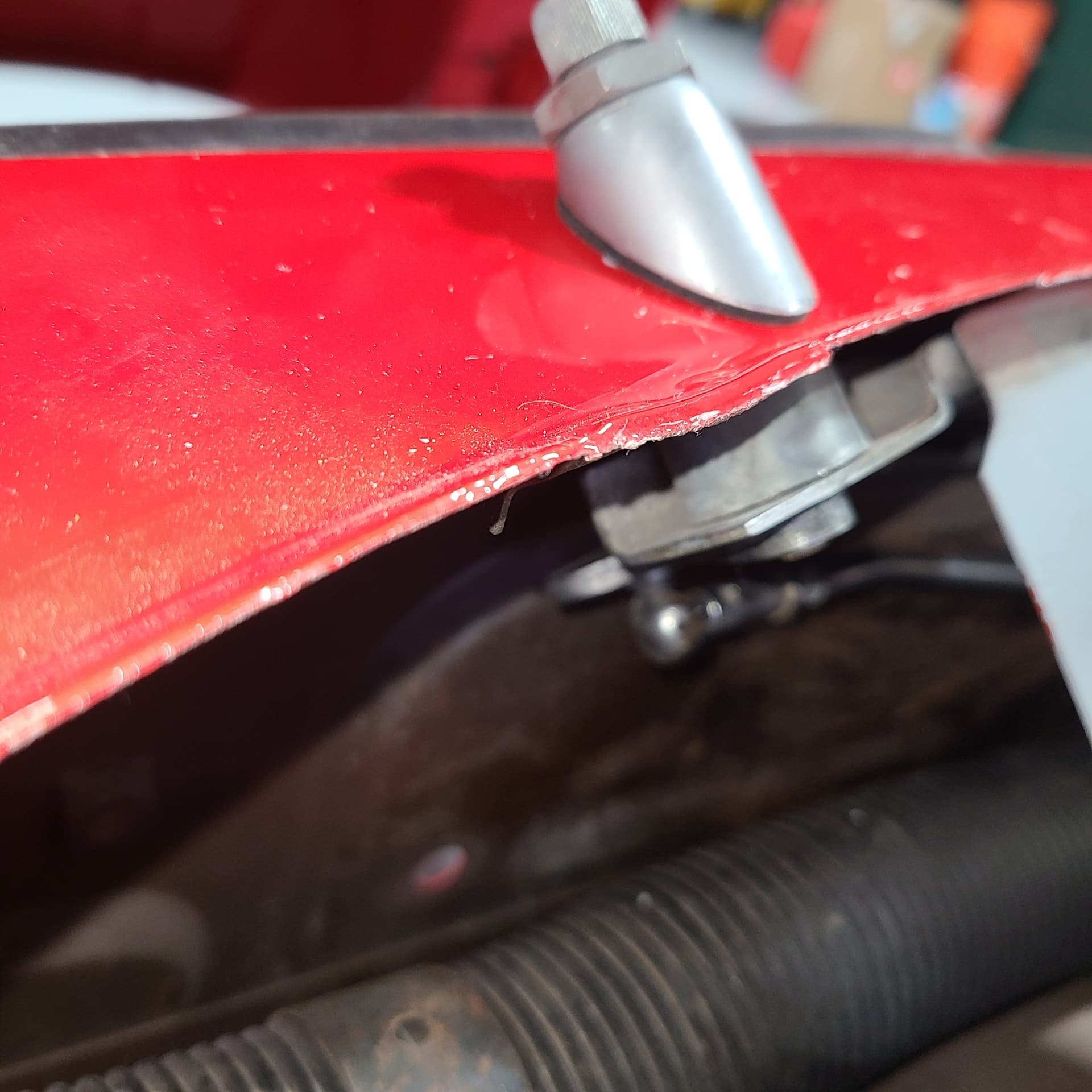

One tip for (Series III owners only?? ) those removing/re-installing the wiper mechanism is NOT to try to wrestle them out either the left or right opening in the dash (the curve of the dash at the ends gets in the way). Purely by accident, I found out today that I could quite easily slip the ~3’ long mechanism into/under the dash through the center opening without risking the paint or bending the mechanism.
20220301_1406591920×1920 358 KB
20220301_1517121920×1920 329 KB
20220301_1516571920×1920 182 KB
PS – Those small white dots are NOT areas with no/missing paint; those are remnants of the polish or final buffing compound the painter used, they are in tiny depressions in the lip of the body

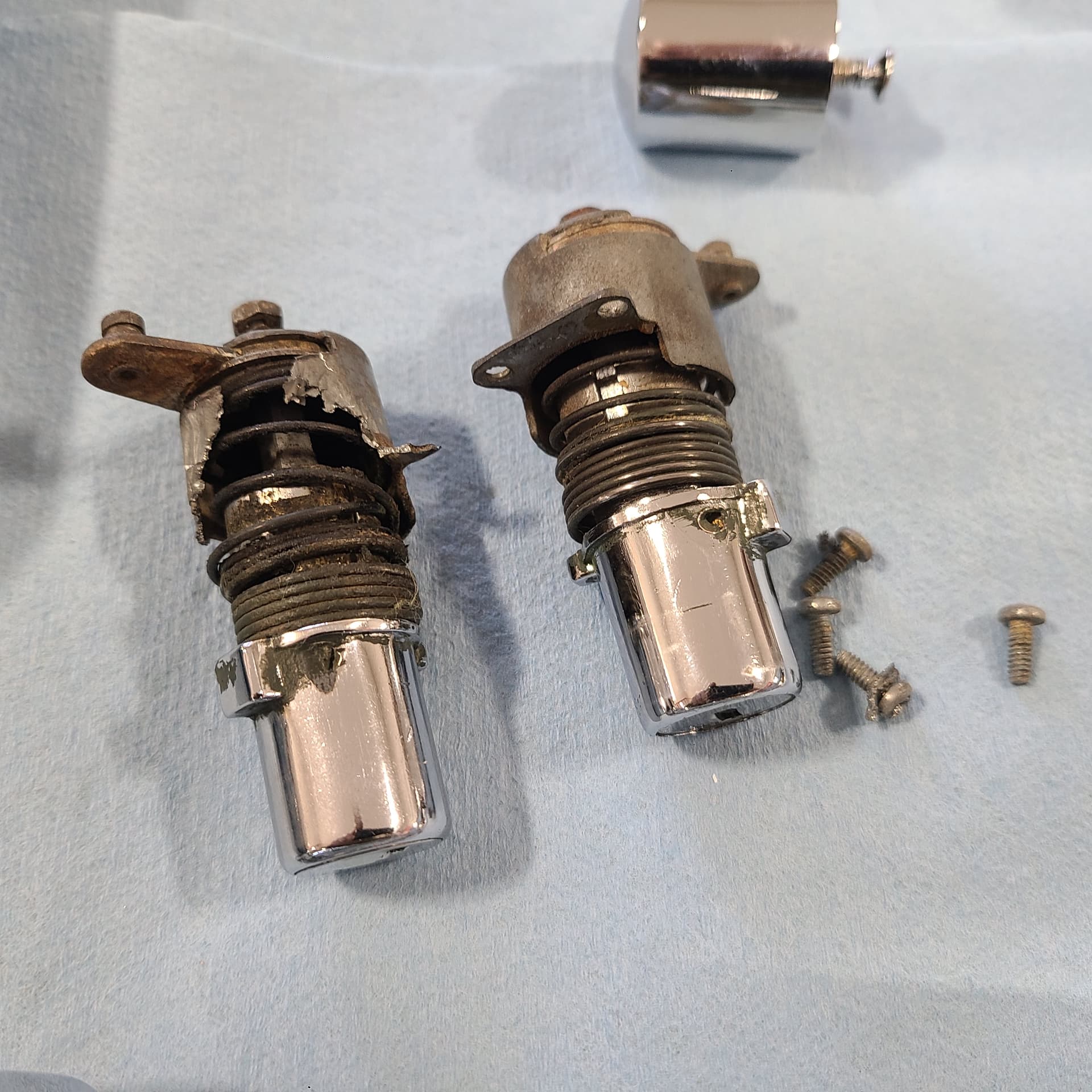

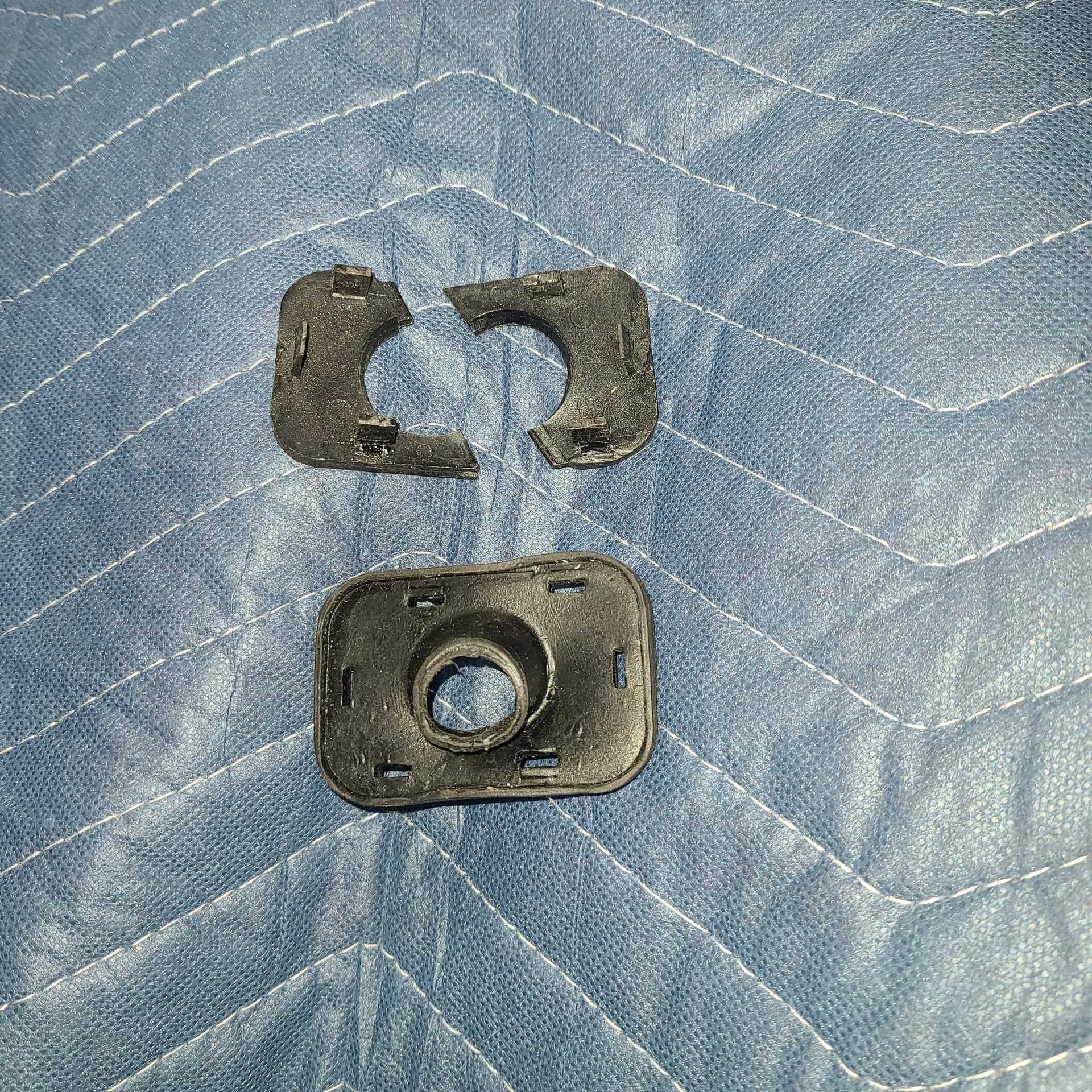

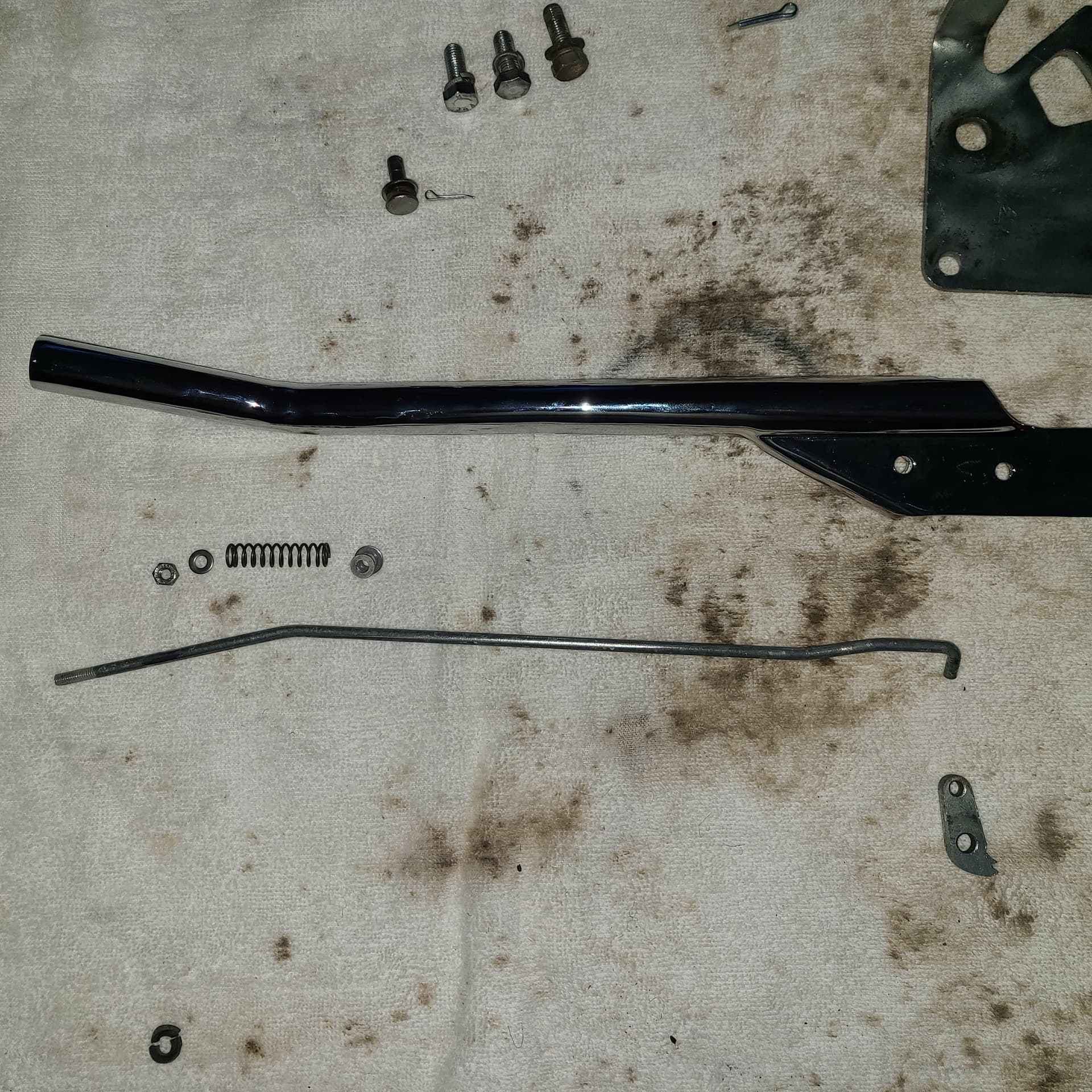

The small step forward was reassembling the emergency handbrake handle with newly chromed tube and release button.
FORWARD: after fumbling around for half an hour and squinting at the useless photos I took months ago, I figured out how the assembly went back together
BACKWARD: the small black plastic (or hardened rubber??) grommet-like thing split in half after only 50 years. Pretty sure I need it to have a functioning handbrake – but maybe not???.
20220309_1802401920×1920 530 KB

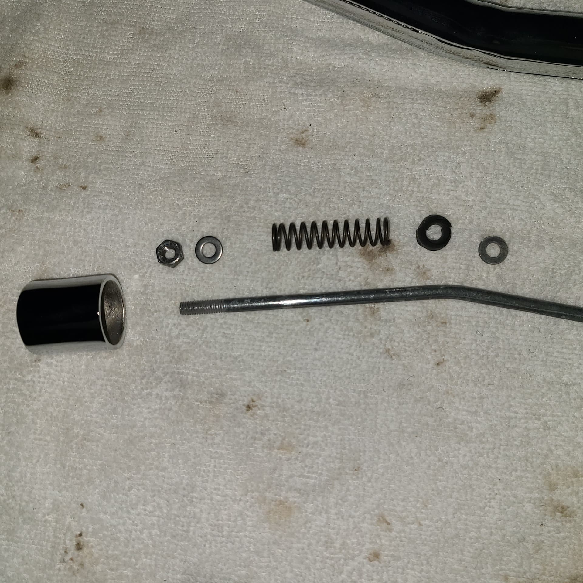

This photo (above) shows the mechanism laid out in assembly order. The broken grommet-like thing is in the lower left corner - in halves. The rod fits inside the chromed tube (see bend). The spring is bracketed by the small washers; the nut adjusts the length of the spring (applying tension).
-o-o-o-o-o-o-
20220309_1803261920×1920 356 KB
The chromed release button (threaded recess inside of it) presses down the rod (through the spring; the spring simply returns the release button to the starting position) which pivots a small pawl at the far end (not pictured) and releases the ratchet on the base of the e-brake handle, thereby releasing the e-brakes. For all this to work properly, the spring must be held in place on the rod.
I suspect others have had this problem -- still 06MAY22 -- trying to solve this one

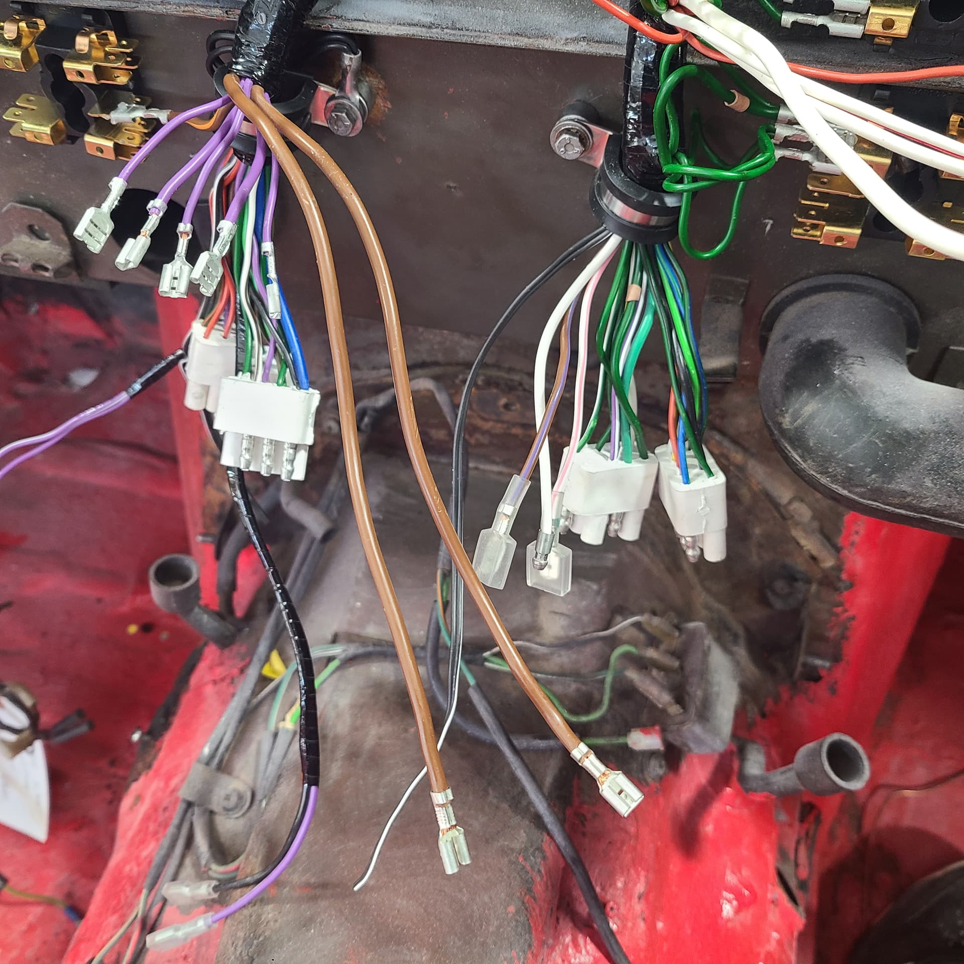

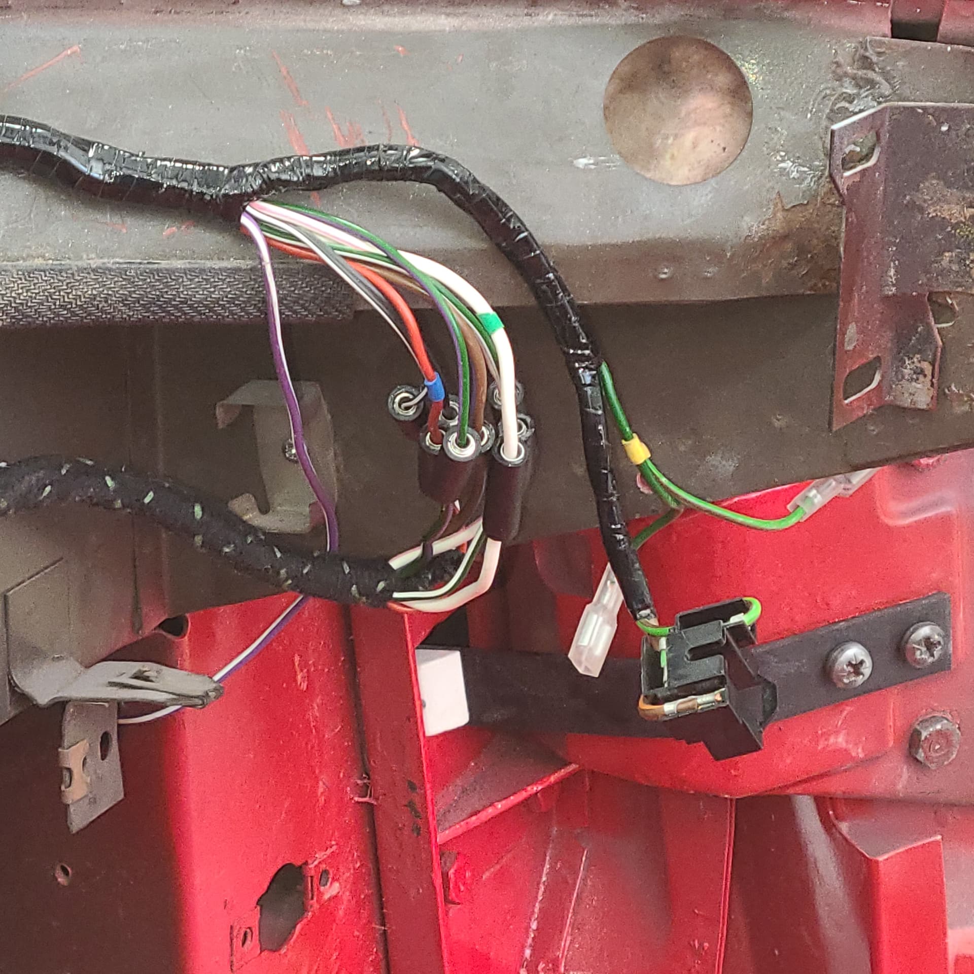

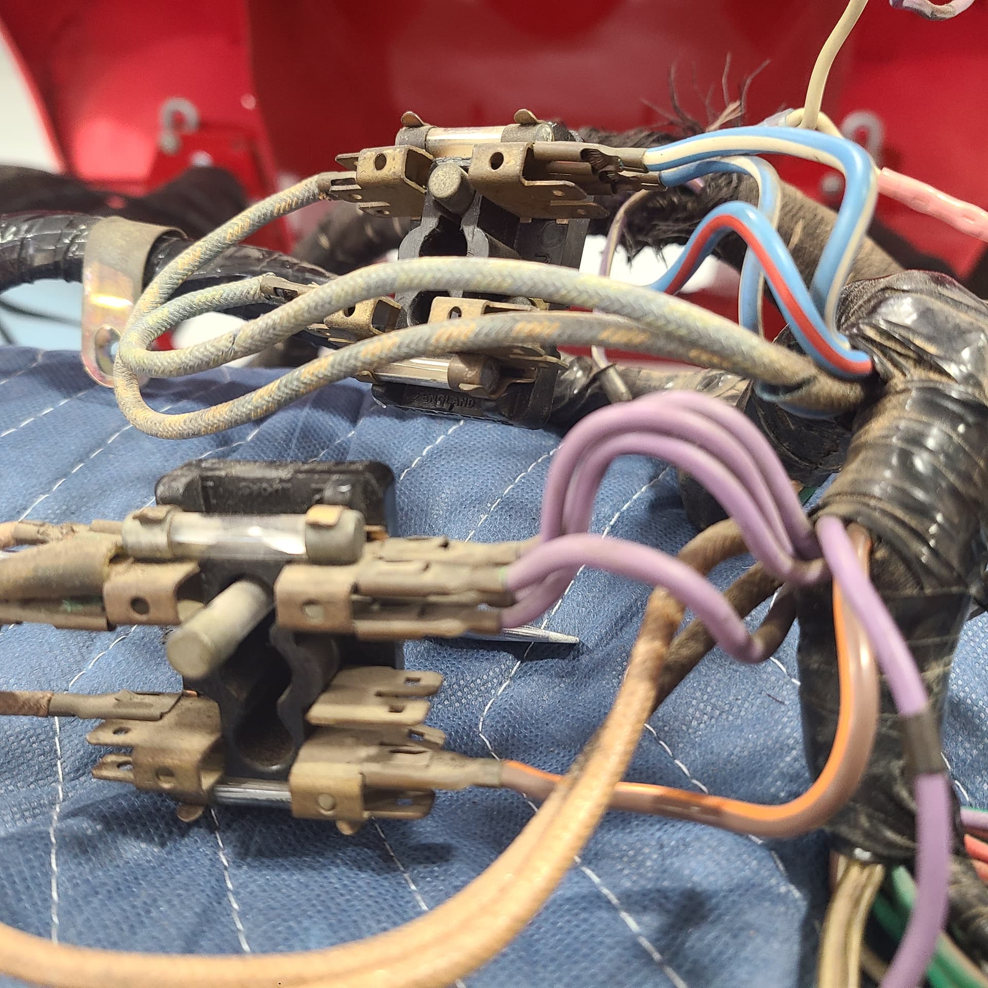

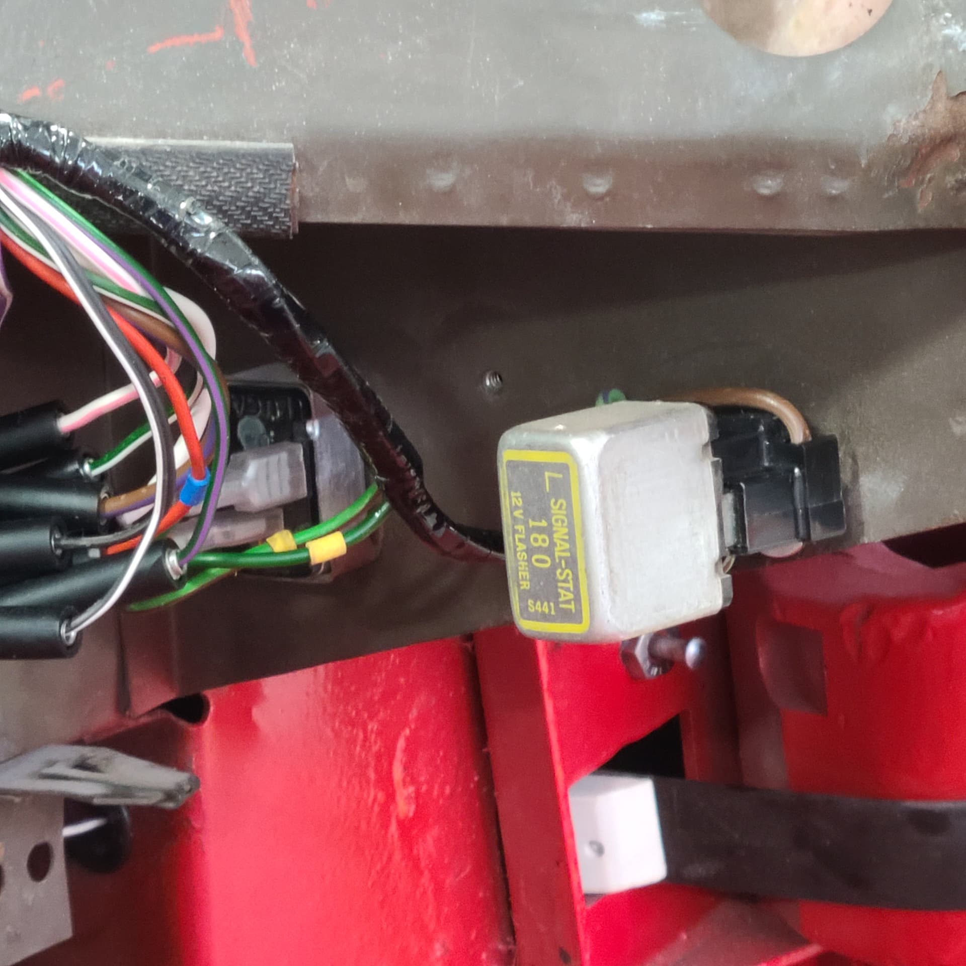

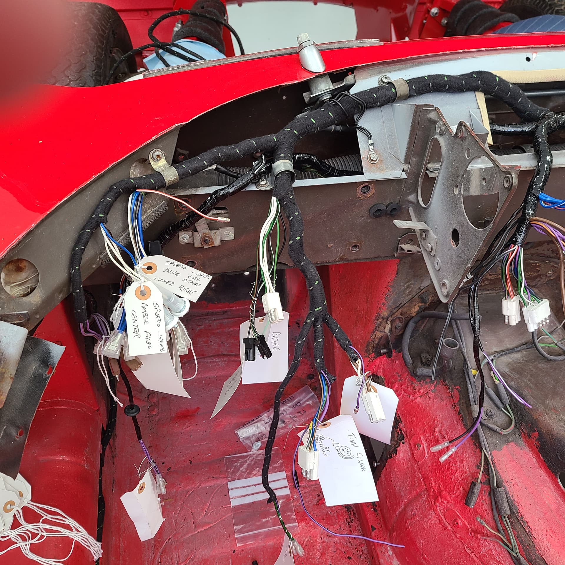

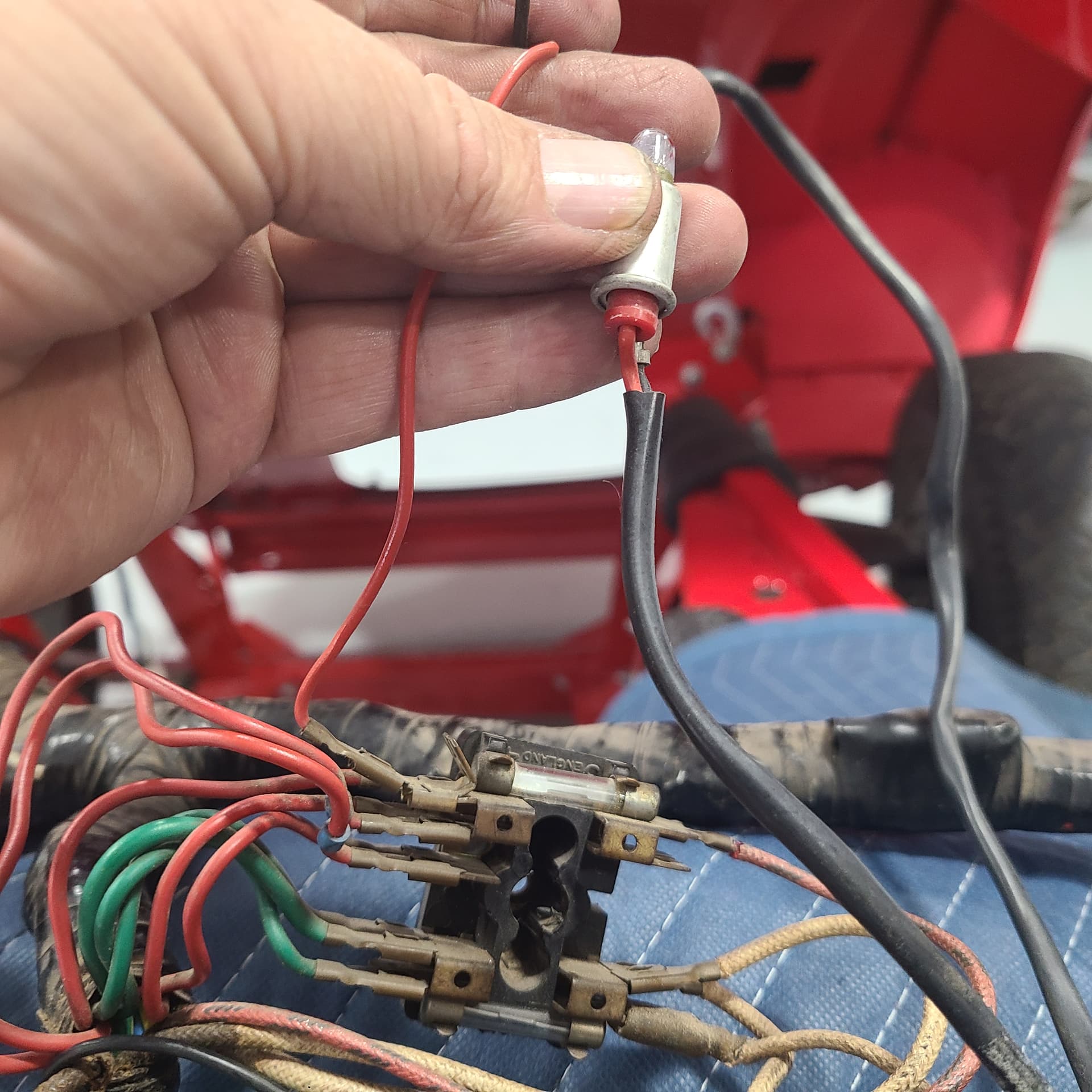

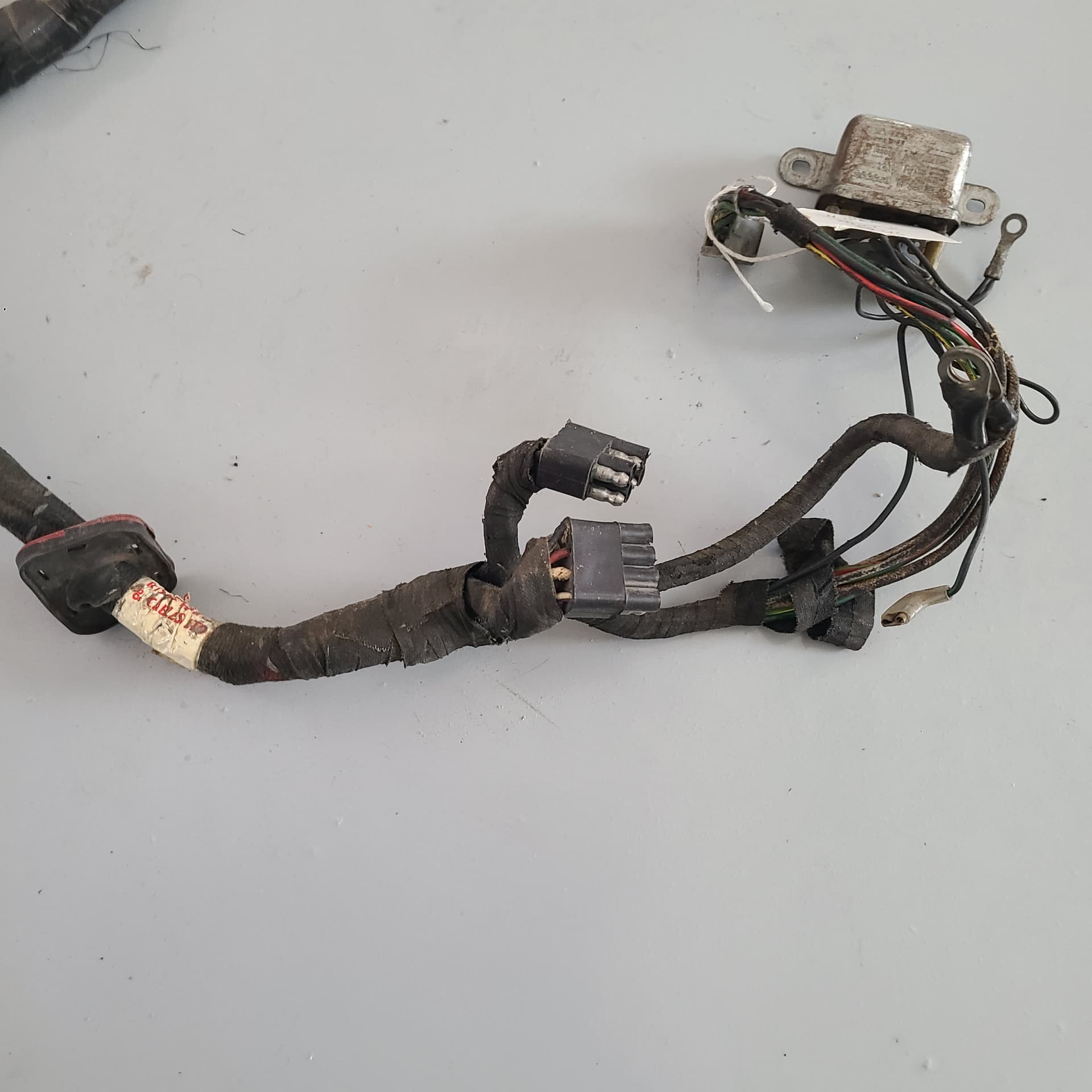

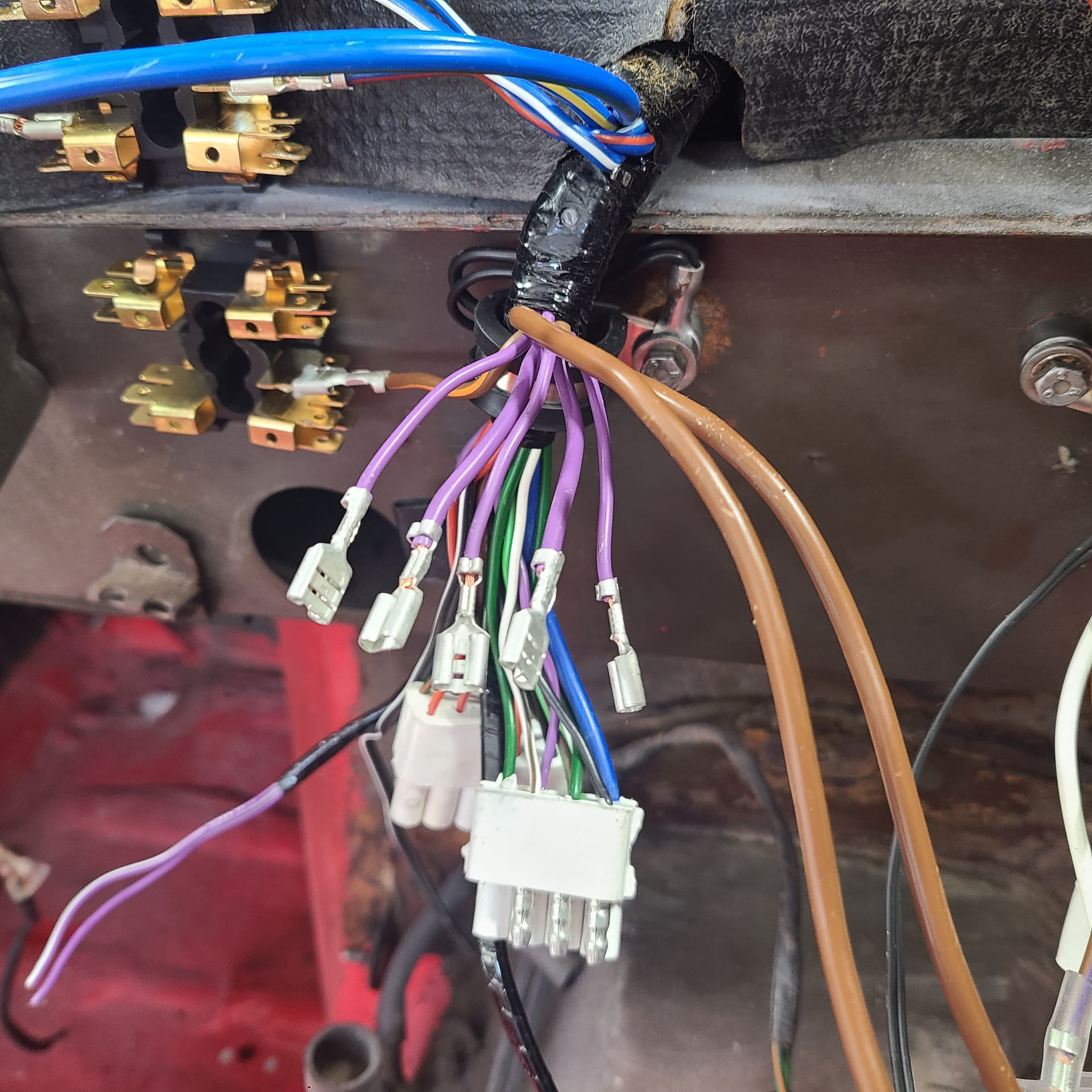

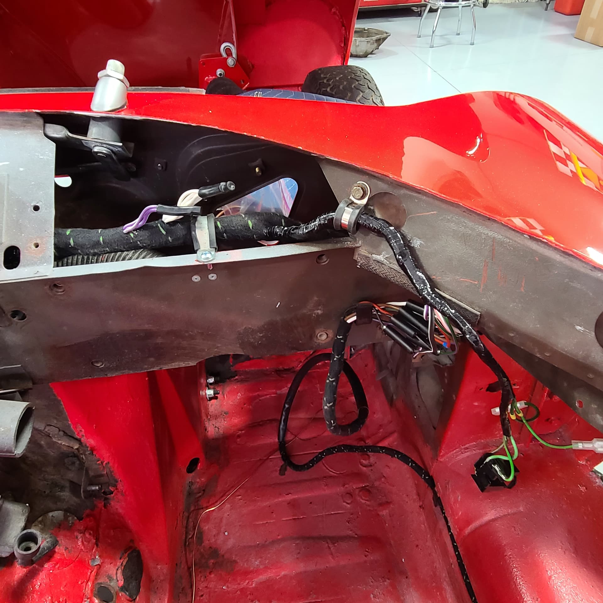

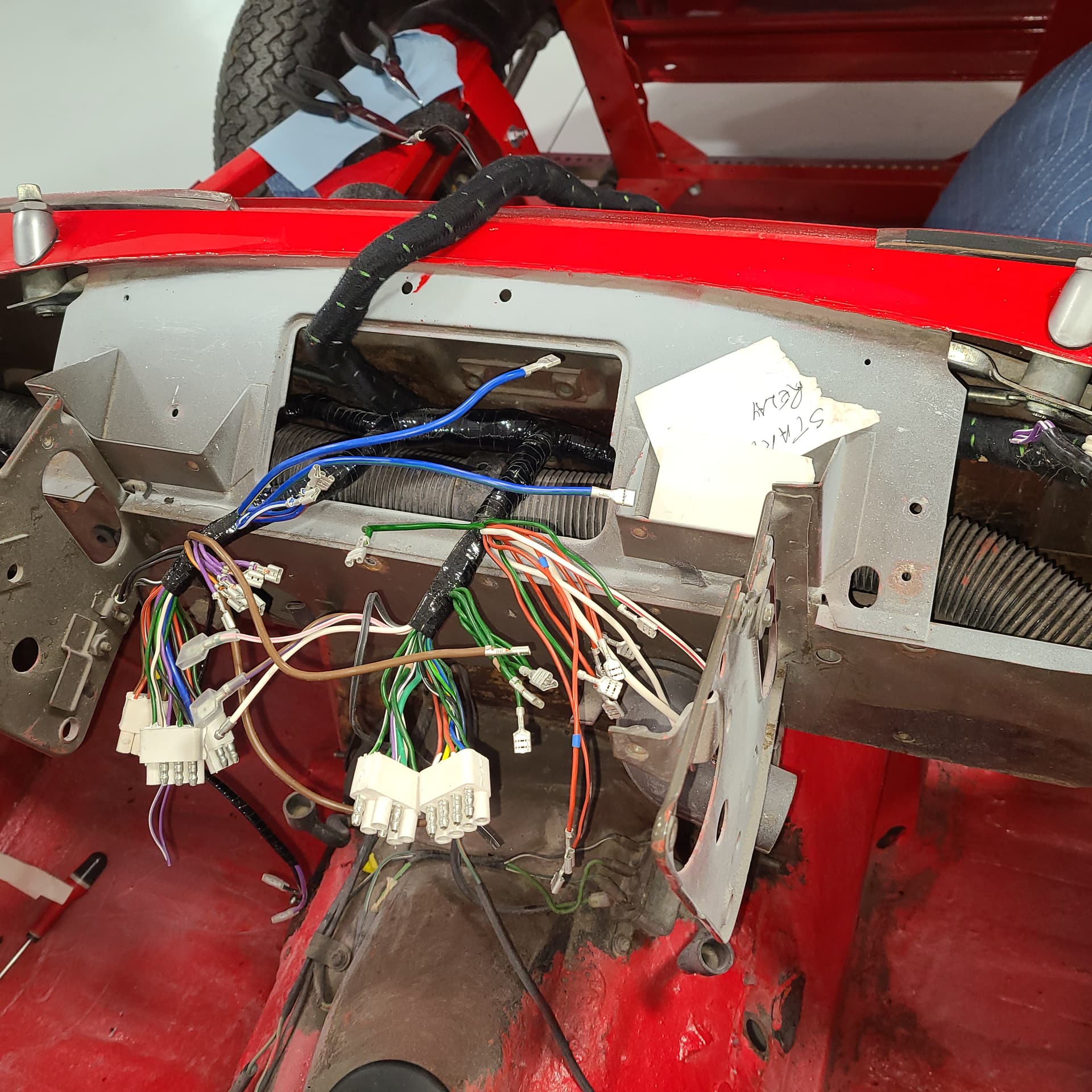

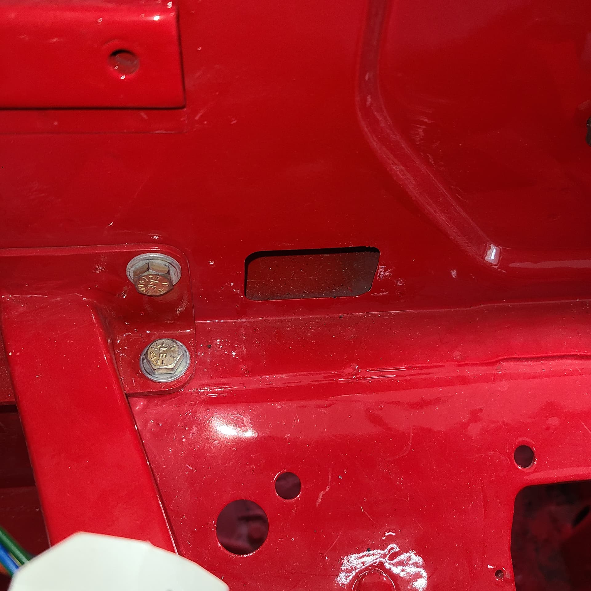

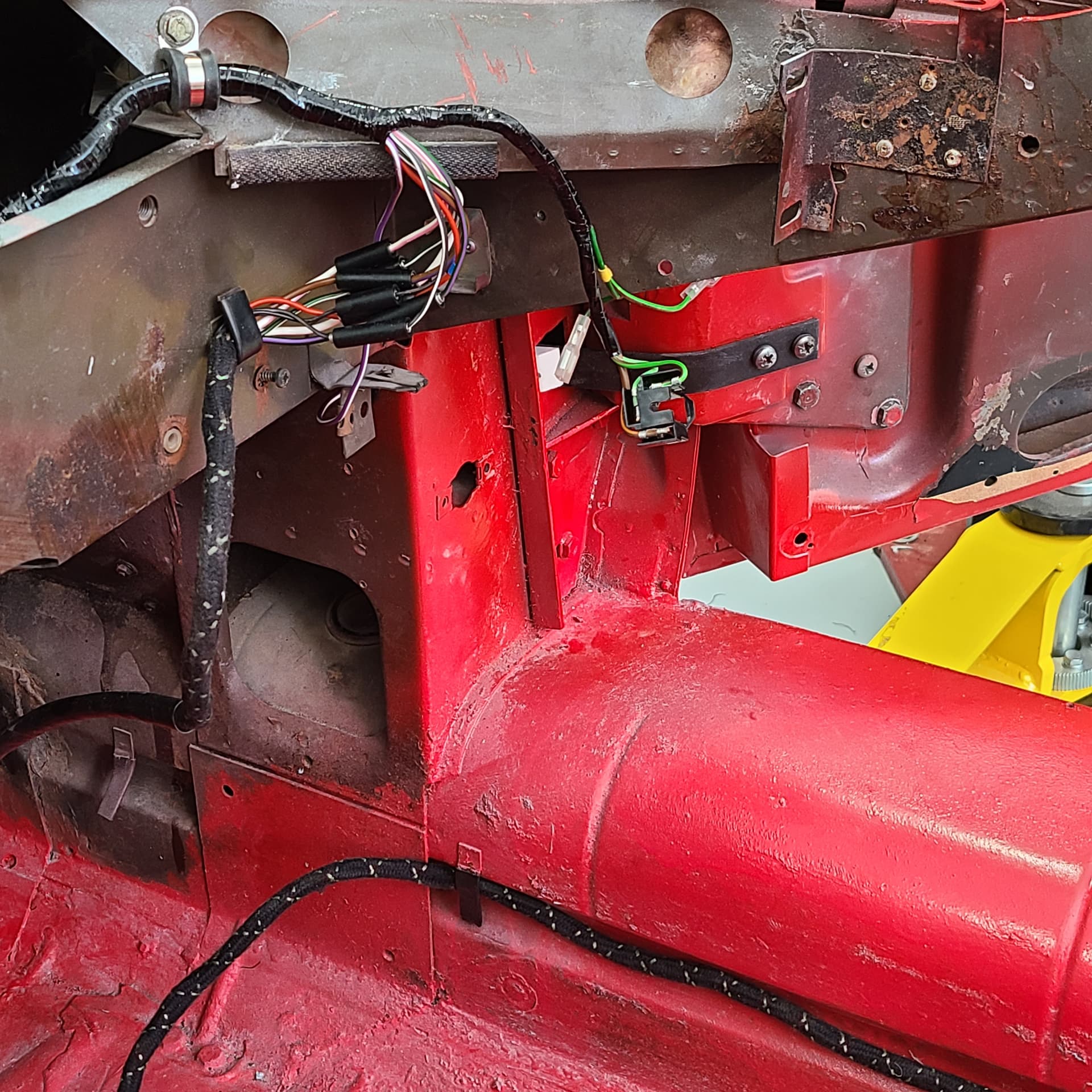

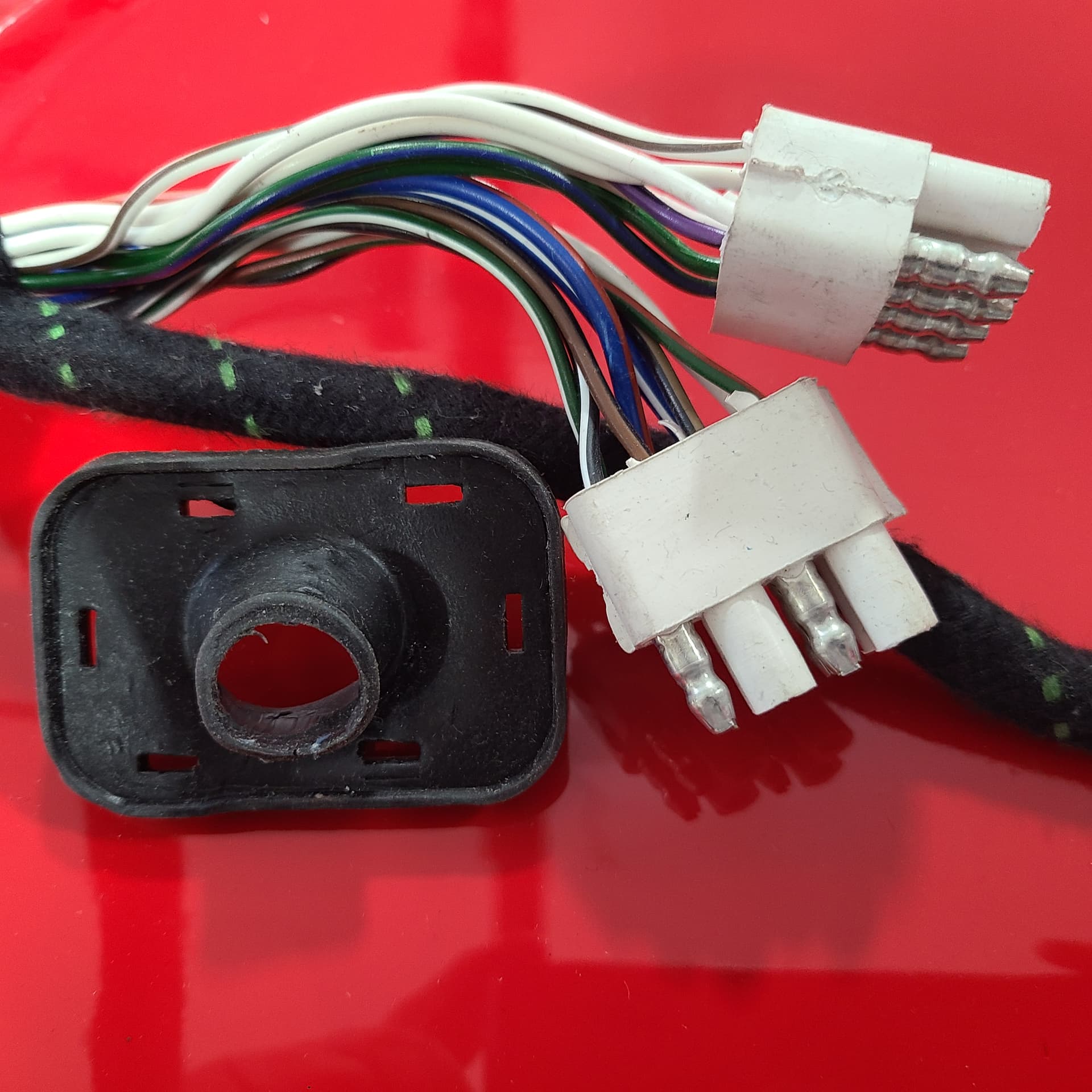

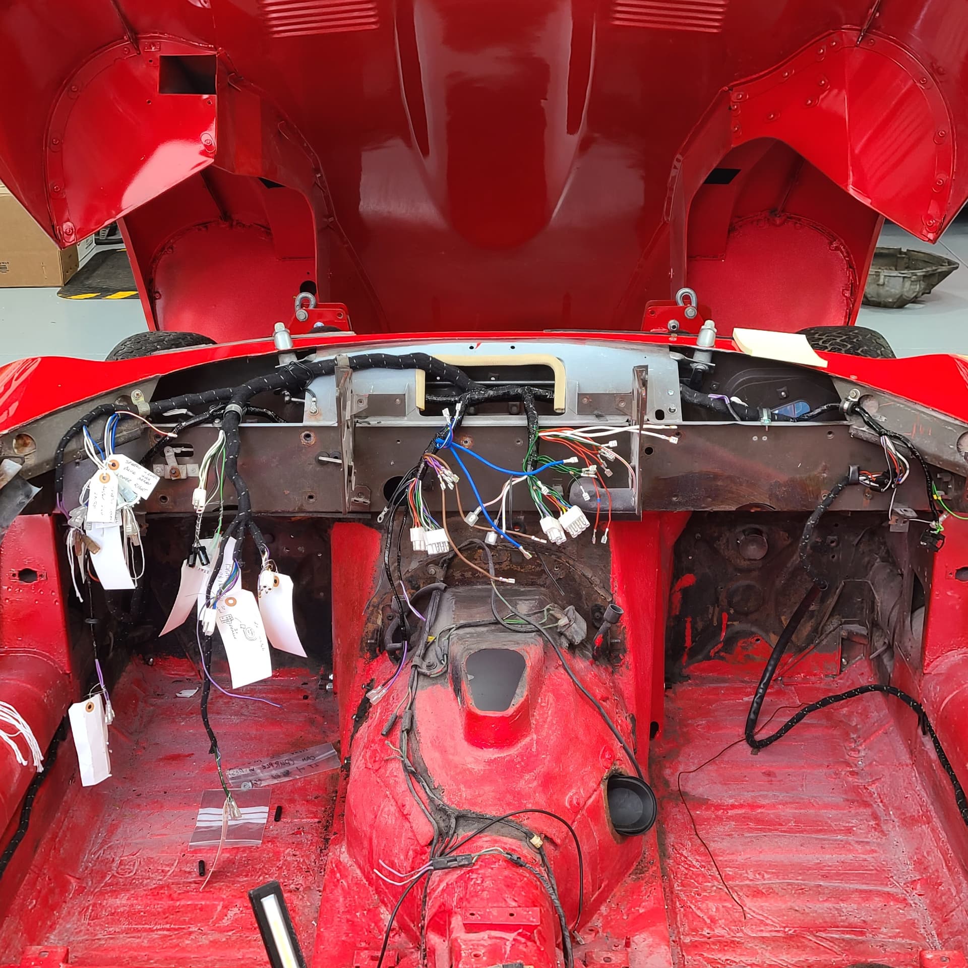

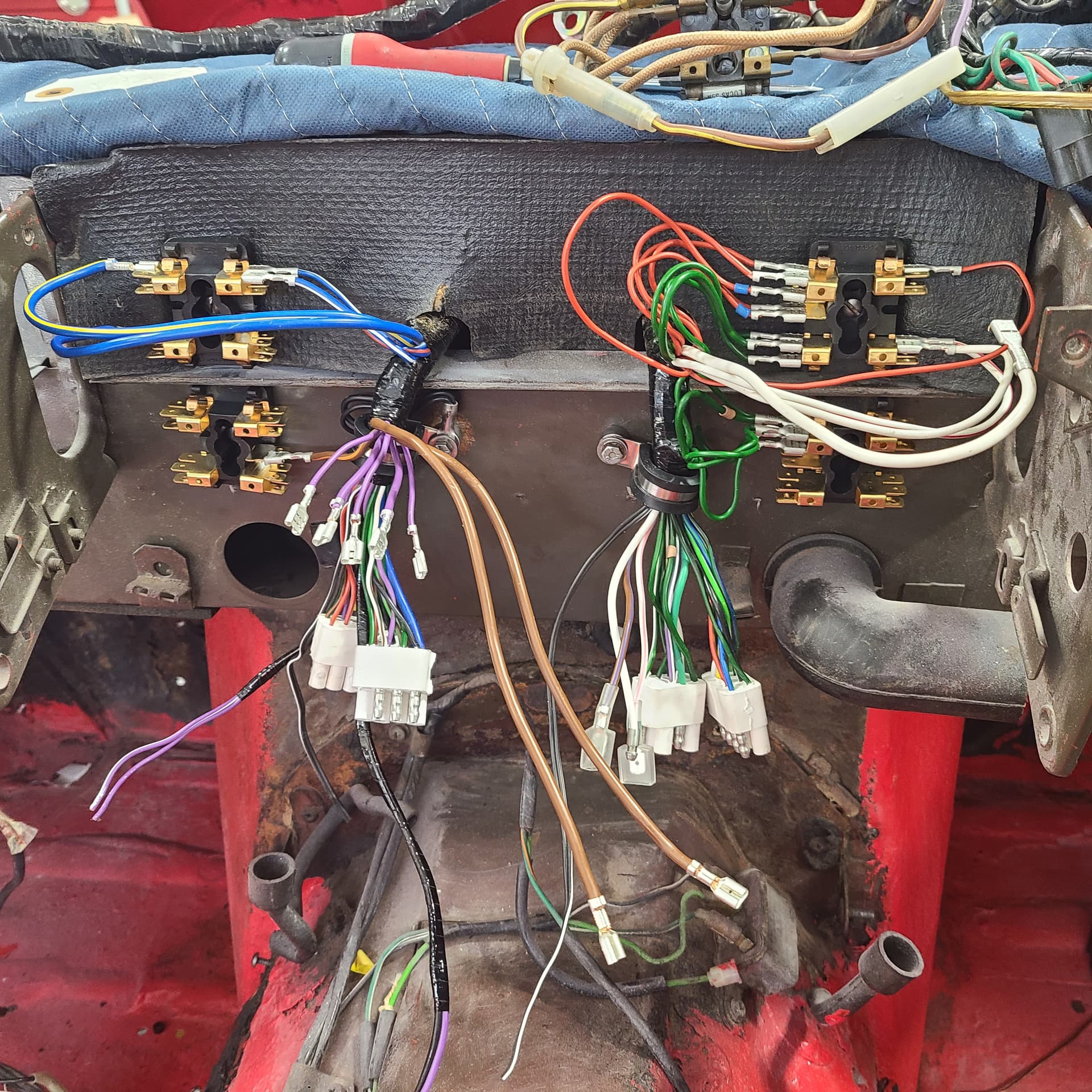

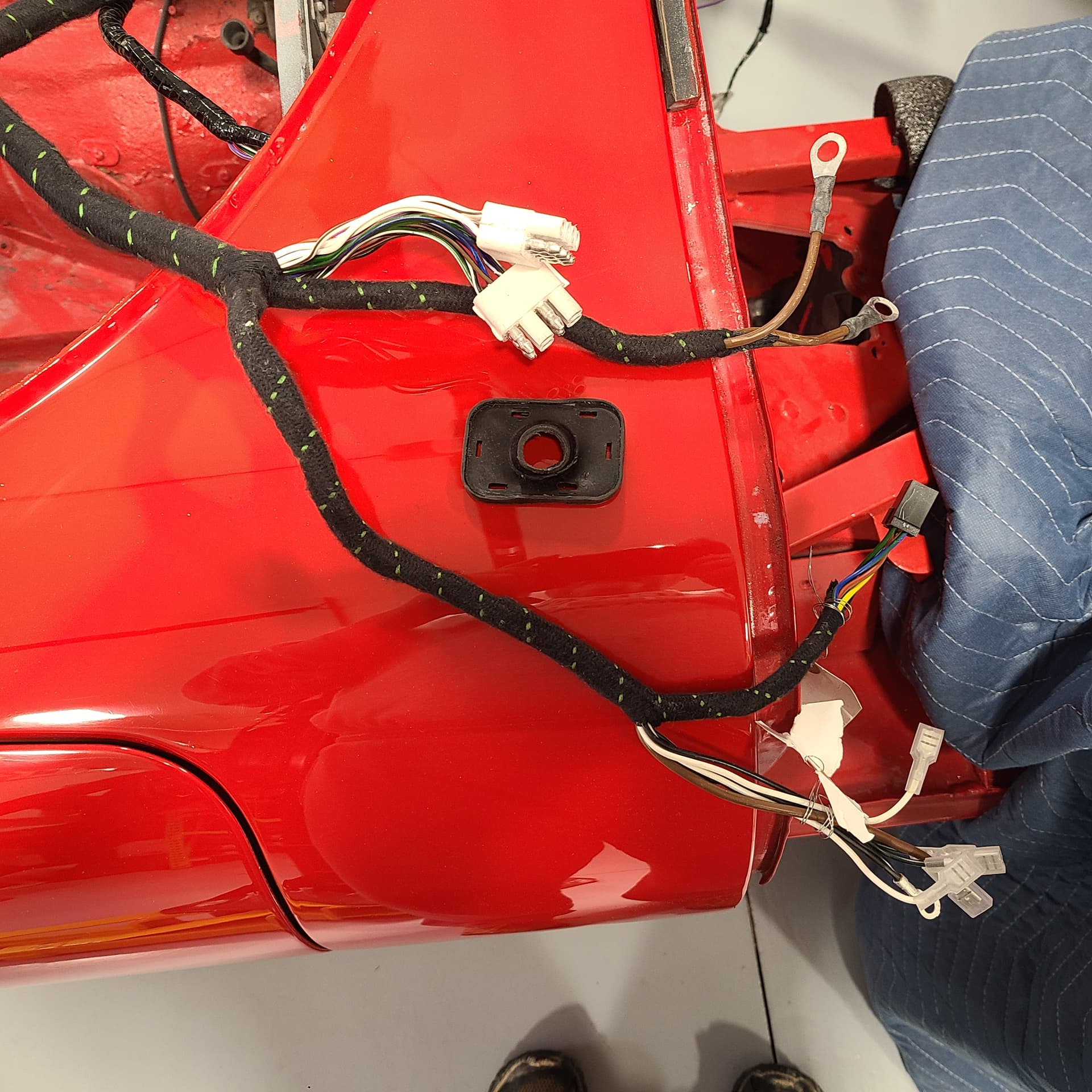

One of the major issues I'm struggling with (small in the grand scheme of things but it's holding up installing more wiring harnesses) is getting a special grommet over the main bulkhead harness to protect it where it passes through the firewall:
The following 5 photos describe my issue. About the only solution I can see is to cut the rubber piece at 6 o’clock to fit it over the wiring harness and then clamp the 2 plastic lock pieces in place.
Captions tell the tale:
1 - The rectangular hole in pssenger side firewall through which wiring harness passes1920×1920 242 KB
2 - All of this harness (from the left edge of the image to the terminals) must fit through the round hole in the rubbe1920×1920 337 KB
3 - The rubber piece with the hole fit on the backside of the firewall and the plastic piece with the prongs locks it1920×1920 505 KB
4 - Close up of three-piece grommet-gasket thing1920×1920 892 KB
5 - The trickiest part is sqeeeezing the white connectors through the hole1920×1920 233 KB
C
Craig Balzer
Sep 21, 2005
876
Colorado Springs

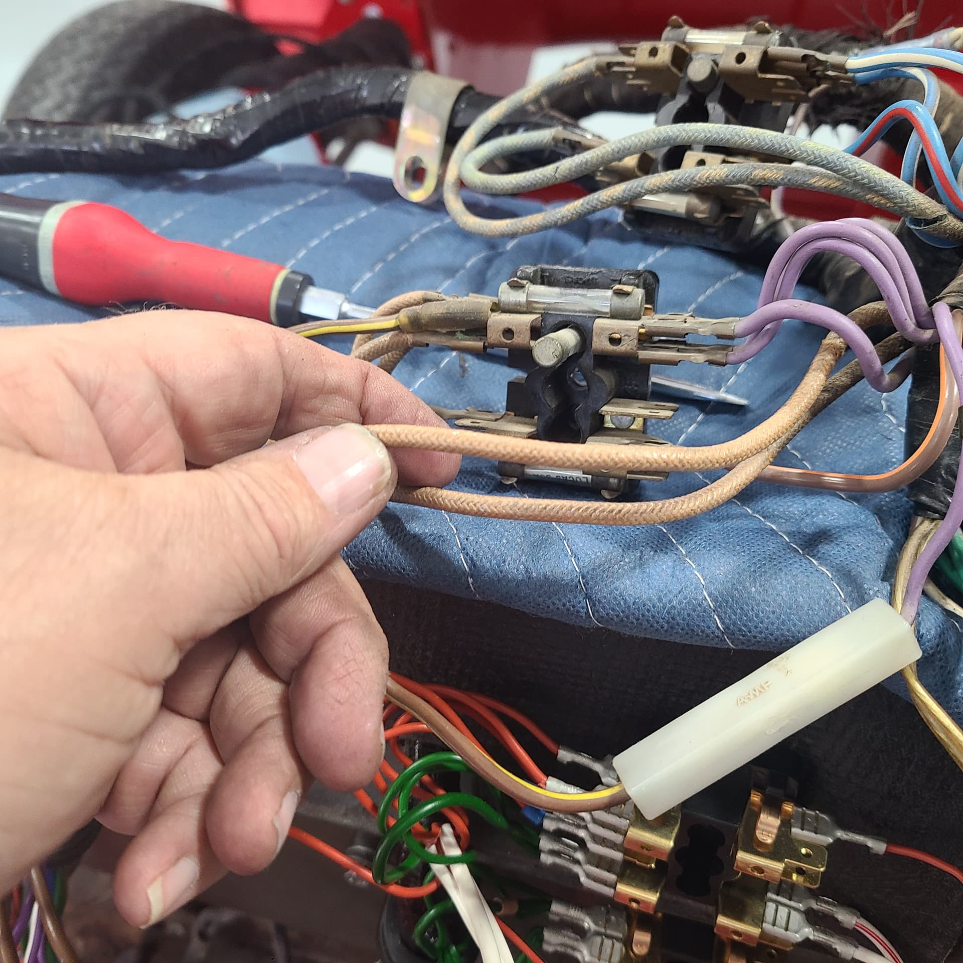

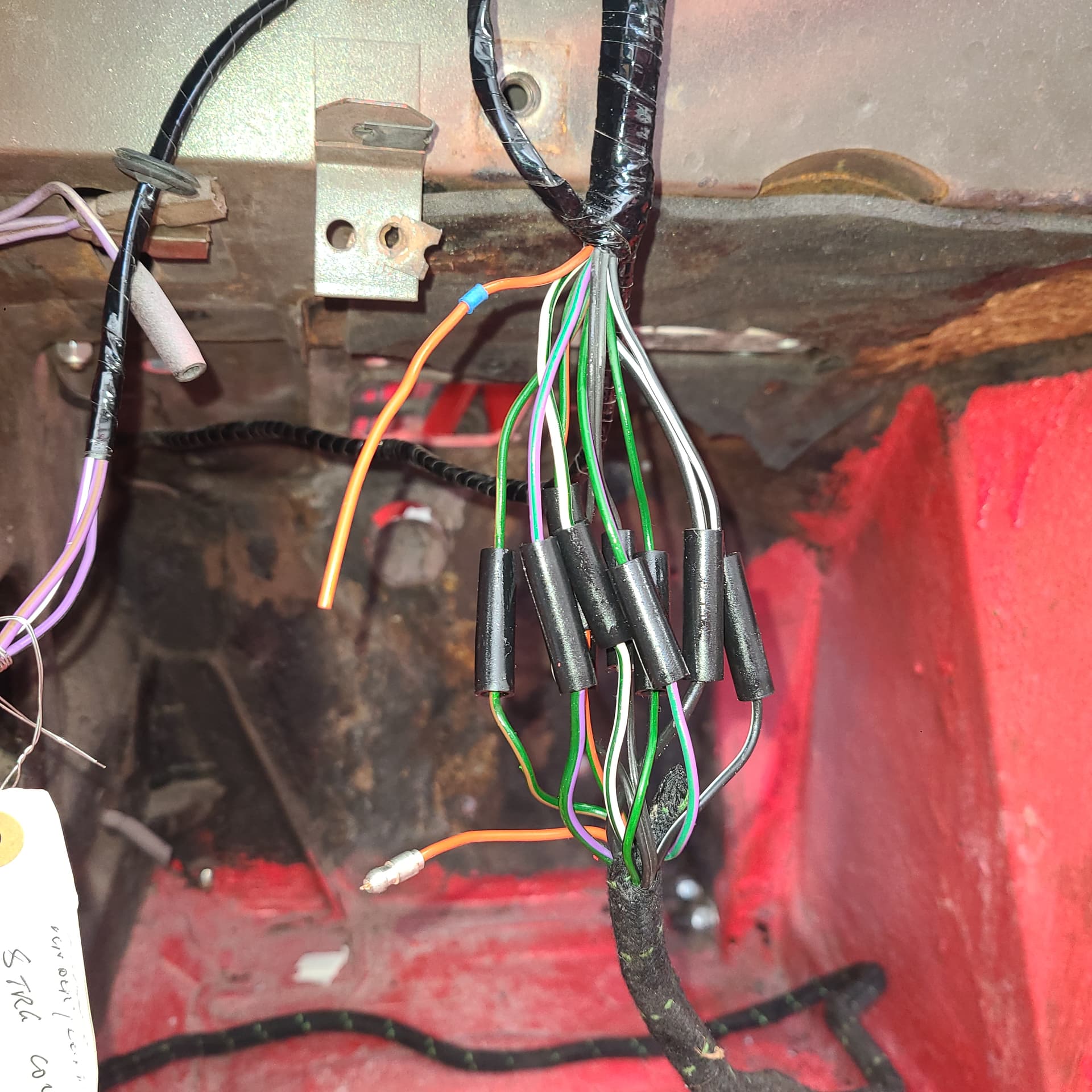

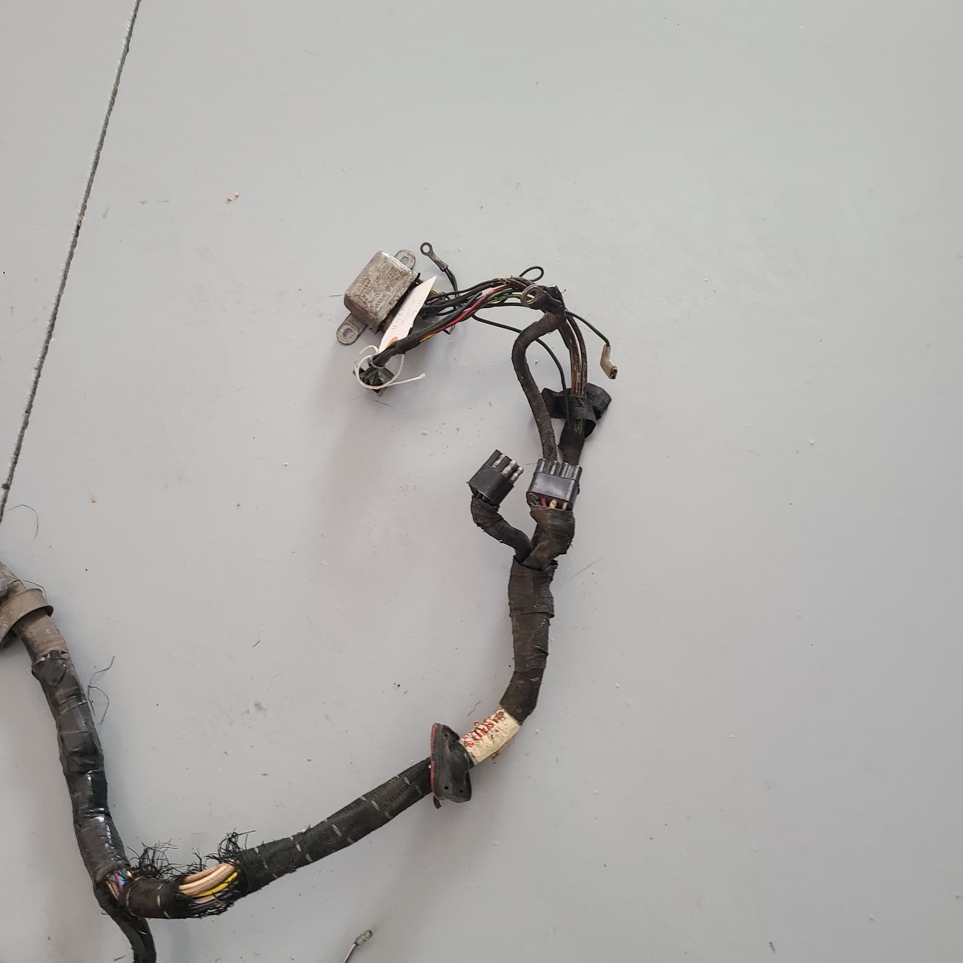

This next bit is probably unnecessary detail, but I was stymied for weeks getting comments and recommendations for the Jaguar Forum how to get this grommet onto the wiring harness. Lots o' detail follows:
One recommendation was to work the grommet onto the harness by starting at the opposite side. I had forgotten how thick the harness got in its middle. There are four 8-connector plugs that connect this harness (the Bulkhead Harness) into the Dash Harness (powers the gauges and light in the center of the dash).
Also, that thick harness that is draped over the dash into the engine bay also must thread through the grommet. There is a second slightly thinner branch that is under the grey panel the feeds the far left side of the dash.
C - All these branches are not gonna fit thru that rubber piece1920×1920 379 KB
and then there is a fair-sized branch about 2 feet further down the line with a small tape-wrapped branch. The harness in the upper righthand corner actually ducks under the dash and then is the harness that passes thru the firewall and needs the grommet placed on it
D - Plus this brnch1920×1920 370 KB
I judge this approach as a no go:
Some others said to use a small screwdriver or pick to detach each wire from the block connector. As this slightly pixilated photo shows, the blocks are molded plastic with each wire embedded in the rubber as opposed to to old(er) fashioned hard plastic block with built-in wire terminals:
Another option was to carefully cut the block connector in half and them glue them back together after passing them thru the grommet.
I don’t trust myself the divide each block connector with a blade and then pass the halves through the grommet individually.
Here are two photos of the original grommet in place on the original harness. It must have been added to the harness before any terminals were installed
A - Original Harness with original grommet in place1920×1920 95.9 KB
B - Close up of Original Harness with original grommet1920×1920 121 KB
This close up also shows the size of the hole in the grommet compared to the 2c connector blocks
You can see in my previous efforts to paint the engine bay, I didn’t remove this harness (red paint around fringe of grommet). I taped the harness and draped it over the windshield. I did the same with other harnesses, choke cables, A/C hoses. etc. ALL those items are now stripped off my Jag.

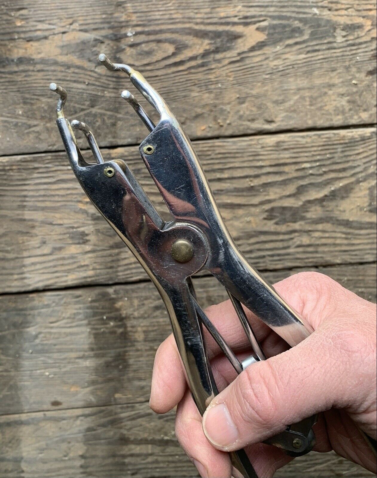

03APR22 - this was posted by a retired US Army aviator:
I’ve never tried to install a replacement on to an existing harness. If I were to do so it MAY be accomplished using a tool I found in my Military days - for Oxygen Masks. Again, I’ve never attempted to install one.
The tool is called an Elastrator. Widely used in the farming industry and numerous examples available on eBait! It was used to expand rubber components (EDIT: to apply a very small rubber ring on male farm animals to make a male into an it), allowing installation of wiring, etc. It works great with rubber grommets, etc. too.
Elastorator3856×1600 364 KB
Elastorator
Elastrator11261×1600 348 KB
Elastrator - Expanded
Once the component (grommet, etc.) in fitted over the four prongs gently squeeze the handles which expands the prongs/grommet.
If I were to attempt to install a new Bulkhead Harness Grommet (C30670) I would first soften up the rubber by use of hot water. Next I’d apply a generous amount of lubricant (KY jelly) to the multi-pin wiring connector. When the grommet rubber is softened install on the Elastrator. Gently, very gently begin spreading the opening, just enough to force the grommet over the side of the connector. From there it’s just a matter of keep heating (in water) the grommet and continuing to slide it over the connector.
Hope this give some insight on how it MAY be accomplished but, as I mentioned, I’ve never replaced one. The main consideration would be keeping the rubber pliable by heating in water (boiling). Just proceed R E A L S L O W…

I am stripping the front of the block in preparation for extraction of the crankshaft and pistons: I have removed the timing cover, all timing chain dampers, timing chain tensioner, the cam gears/cams.
Next step: “withdraw” spacer and crankshaft sprocket". Yeah – – right.
How the ****** hell do you do that?? I even removed the 4x bolts securing the oil pump (see second photo) and gingerly used a dead blow hammer in an effort to use the oil pump to persuade the sprocket off the shaft. No Joy.
11 - Oil Pump in Situ with Timing Chain1920×1920 414 KB
12 - Close oy of Oil Pump in Situ1920×1920 603 KB
13 - Slot for Woodruff Key1920×1920 197 KB
This is a pretty ****** shot – I didn’t realize the camera pulled focus behind the spacer that is bane of my current existence; it was supposed to show the slot for an already-removed Woodruff key. But it does show the bevel on the spacer precluding use of a gear puller – nothing to grab on to.
I believe once the dreaded spacer is removed that the sprocket will follow. Or is that another “withdraw” action??
Reminder - the pistons and rings and crankshaft are frozen and I am unable to rotate that assembly
TIA
Craig

12JAN22 - Just came in from hobby shop. The spacer slid off the snout of the crankshaft as if I had installed it yesterday – I credit PB Blaster.
I tried the chisel trick on the sprocket – didn’t budge.
I tried a pry bars and various sizes of screwdrivers trying to walk the sprocket forward. No Joy.
Part of the challenge in removing the sprocket is a ridge of aluminum on the timing chain cover around the lower half of the sprocket (a guide of sorts to keep the chain from jumping track) – it is just visible in the photo so I can only put pressure on the top half of the sprocket.
So far I have been successful in getting only a 1/16" gap between the rear face of the sprocket and the forward face of the timing chain cover,
It is soaking in PB Blaster but I am not expecting a significant change tomorrow .
It is ~on~ there.

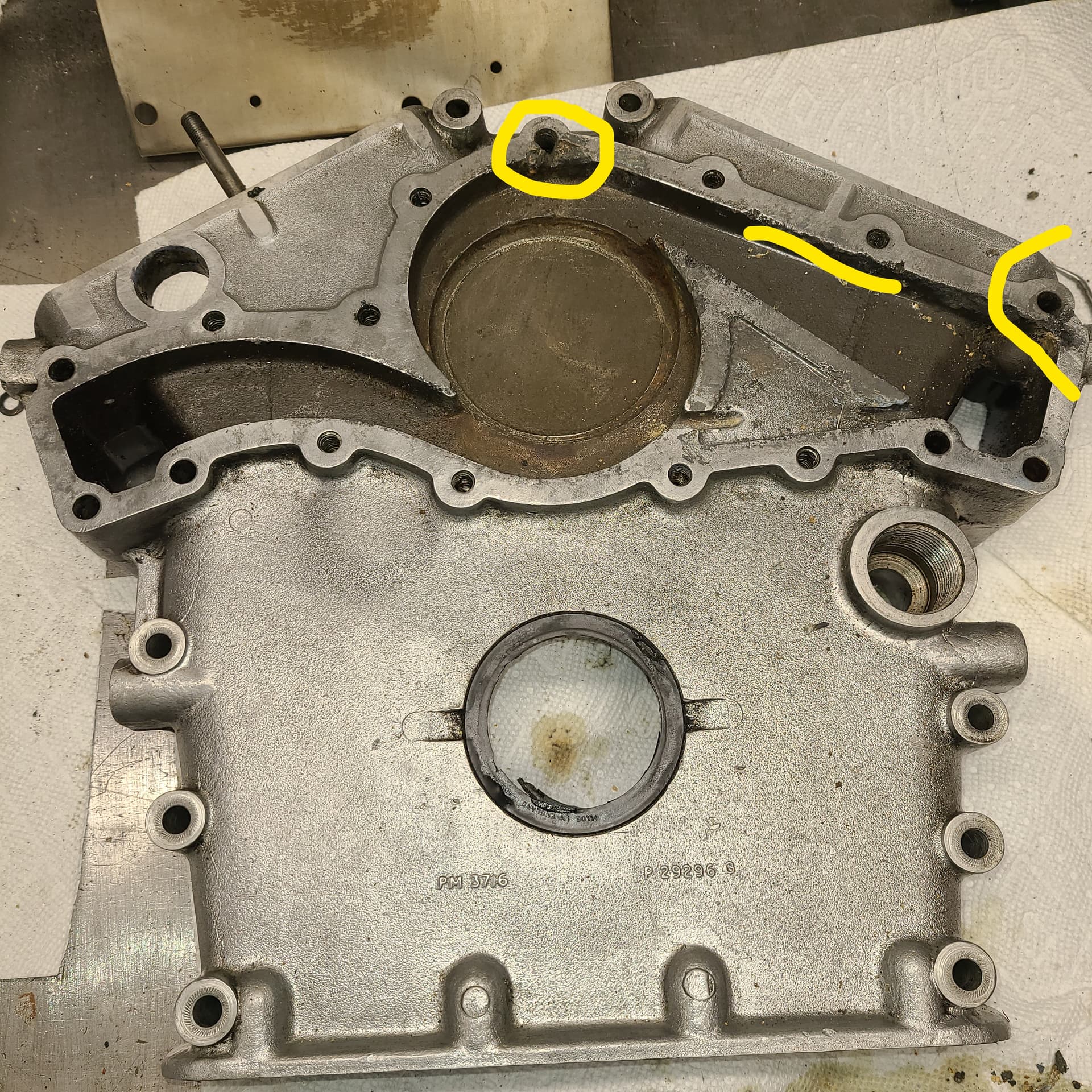

12JAN22 -- I set aside my efforts to extract the sprocket and looked at:

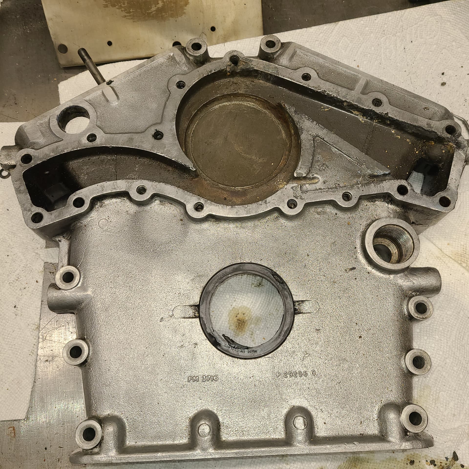

Today I cleaned up and closely examined the Timing Chain Cover – among other actions.
So this cover is really in very good shape – EXCEPT – for 2-3 places. Overview and close up photos follow (check captions as usual).
QUESTION
  1. Clean it up a little better and install it - most of the corrosion is on the inside of the rail
  2. Have the 2-3 locations that are corroded welded up (aluminum) and machined (who does that? Coventry West?). I highlighted the worst of them – if the answer is weld/repair, there are some smaller issues to be addressed
  3. Purchase new (or used in better condition) – Barratt says “Not available online” - Hmmm, is that Jag-speak for ****** expensive?
1- Timing Cover - Overview1920×1920 749 KB
Inked1- Timing Cover - Overview Marked Up1920×1920 749 KB
4 - Timing Cover - Center1920×1920 630 KB
6 - Timing Cover - Upper Inside Right1920×1920 478 KB
7 - Timing Cover - Upper Right1920×1920 276 KB

17JAN22 - With regard to removing the crankshaft sprocket, I previously said this to my retired Jaguar-Mechanic friend Paul:
71768_2.jpg Craig_Balzer:
OK Obi Wan.
I did spend the better part of 2 hours working on it today.
May need another 2 tomorrow.
Well - it’s not what ya know, but who ya know. Paul made yet another trip from NE Denver to NE C Springs and brought a fellow gear-head along who wanted to check out the Jag and my shop. Paul also brought brought a slide hammer thingie.
Now all the slide hammers I have seen – both of them – had a threaded tip that screwed into a hole drilled in the center of a dent in a body panel which was then slide-hammered outward, mostly removing the dent. Paul’s slide hammer had three small fingers identical to a gear puller. The fingers weren’t long enough to allow all 3 to engage the pesky sprocket; the crankshaft snout was too long – he fussed for about 10 seconds to get good purchase of 2 of the fingers.
It happened too fast to count the number of strokes Paul applied to the slide, but my best guess is the sprocket was off the snout in less time than it took to finesse the fingers into place. The oil pump housing slid off the snout with no fanfare whatsoever.
I can now – finally – move forward in extracting the piston/sleeve assemblies and ultimately the crankshaft. Paul – you area Godsend. thanks so much. I treated Paul and his buddy to lunch.

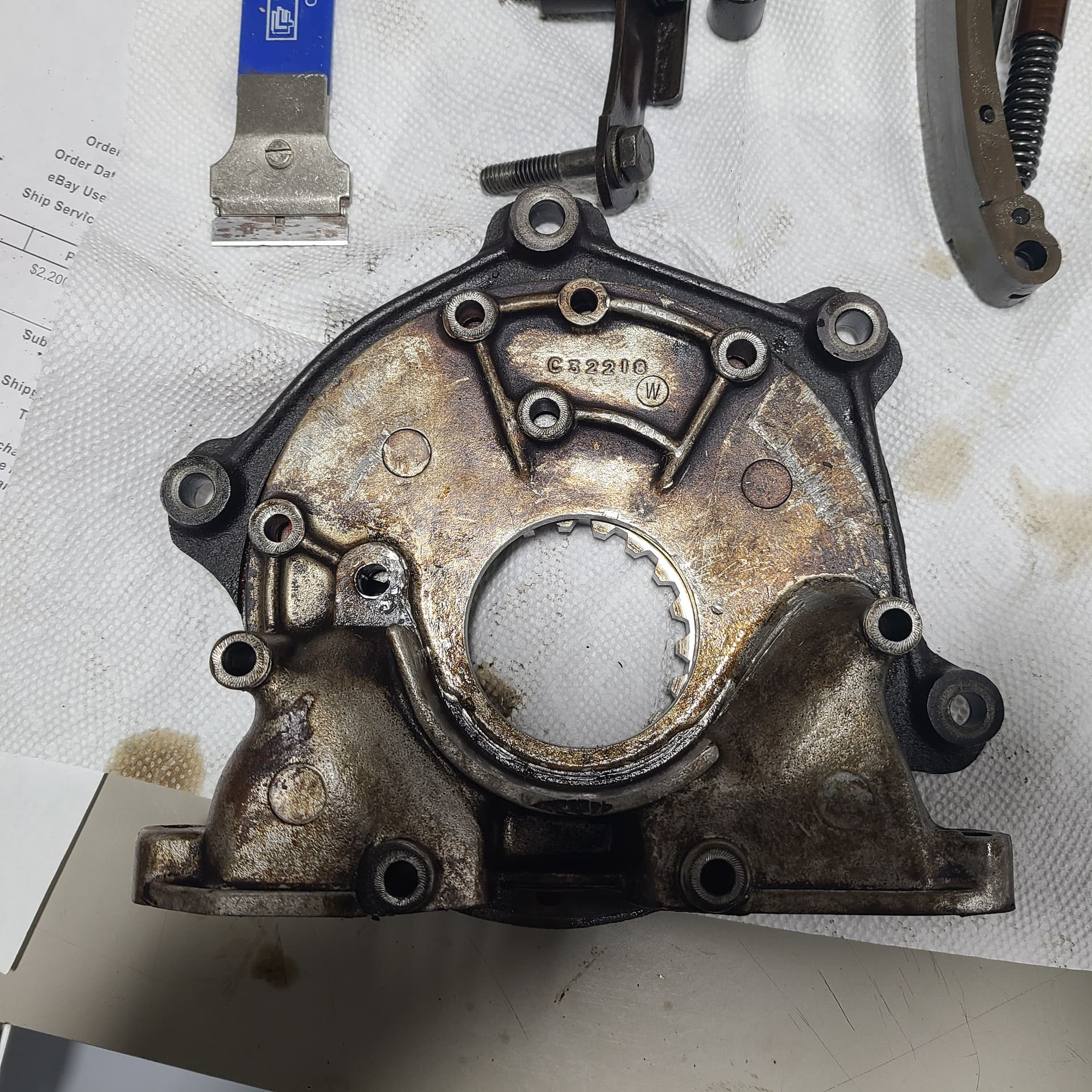

18JAN22 - It was only a matter of time before I bumped into an unexpected expensive “find”. I was prepared to replace all 12 pistons and sleeves so that eventuality wasn’t really a surprise.

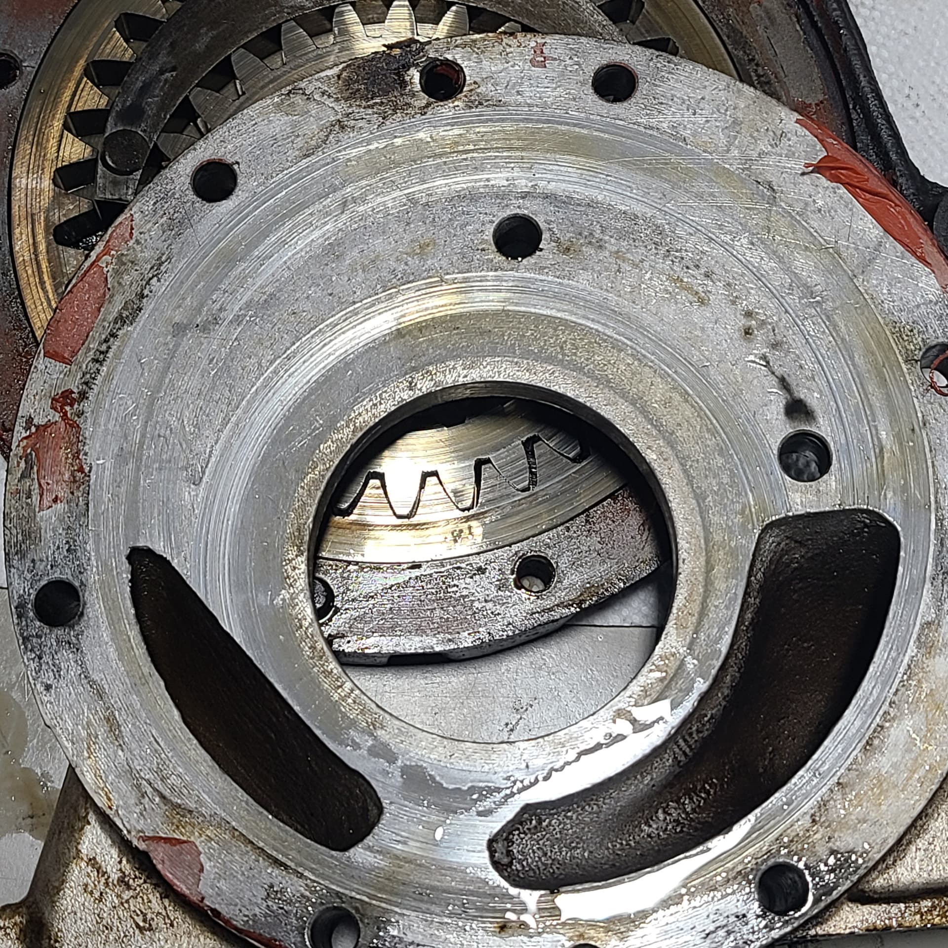

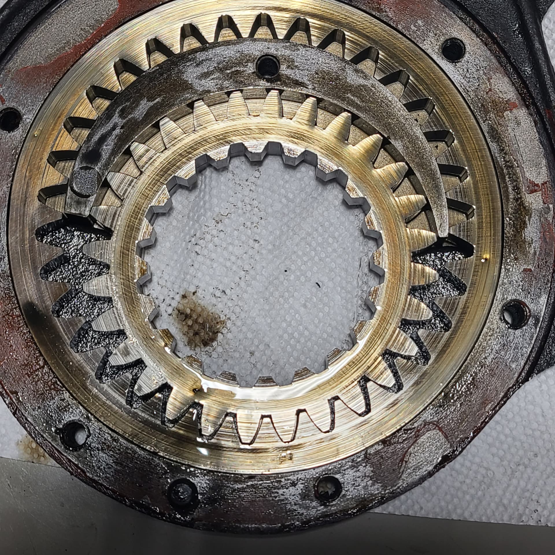

Today I dissected the oil pump – as mentioned above it slid off the crankshaft snout easily. Opening it was very straight forward – only needed to unbolt half a dozen 7/16" bolts and 4x 1/2". That’s where the fun ended.
I am not a mechanic but even I can recognize scratches that catch a thumb nail and gaps that are mostly out of spec. Please tell me some of this is salvageable but I suspect a $2,100 new high-capacity oil pressure oil pump is in my future. This proved to be the case.
The sad evidence follows (details in captions):
Nothing scary here:
1 - Overview of Oil Pump1920×1920 506 KB
These scratches on the under side of the cover easily catch my thumb nail
2 - Underside of Oil Pump Cover - Thumb Nail Scrathces1920×1920 578 KB
Two gears in situ – more scratches that catch thumb nail
3 - Two Gears and A Crescent - Thumbnail DOES grab on wear marks1920×1920 567 KB
Prolly don’t need a close up but the scratches/gouges are quite evident
4 - Two Gears and A Crescent - Close Up1920×1920 333 KB

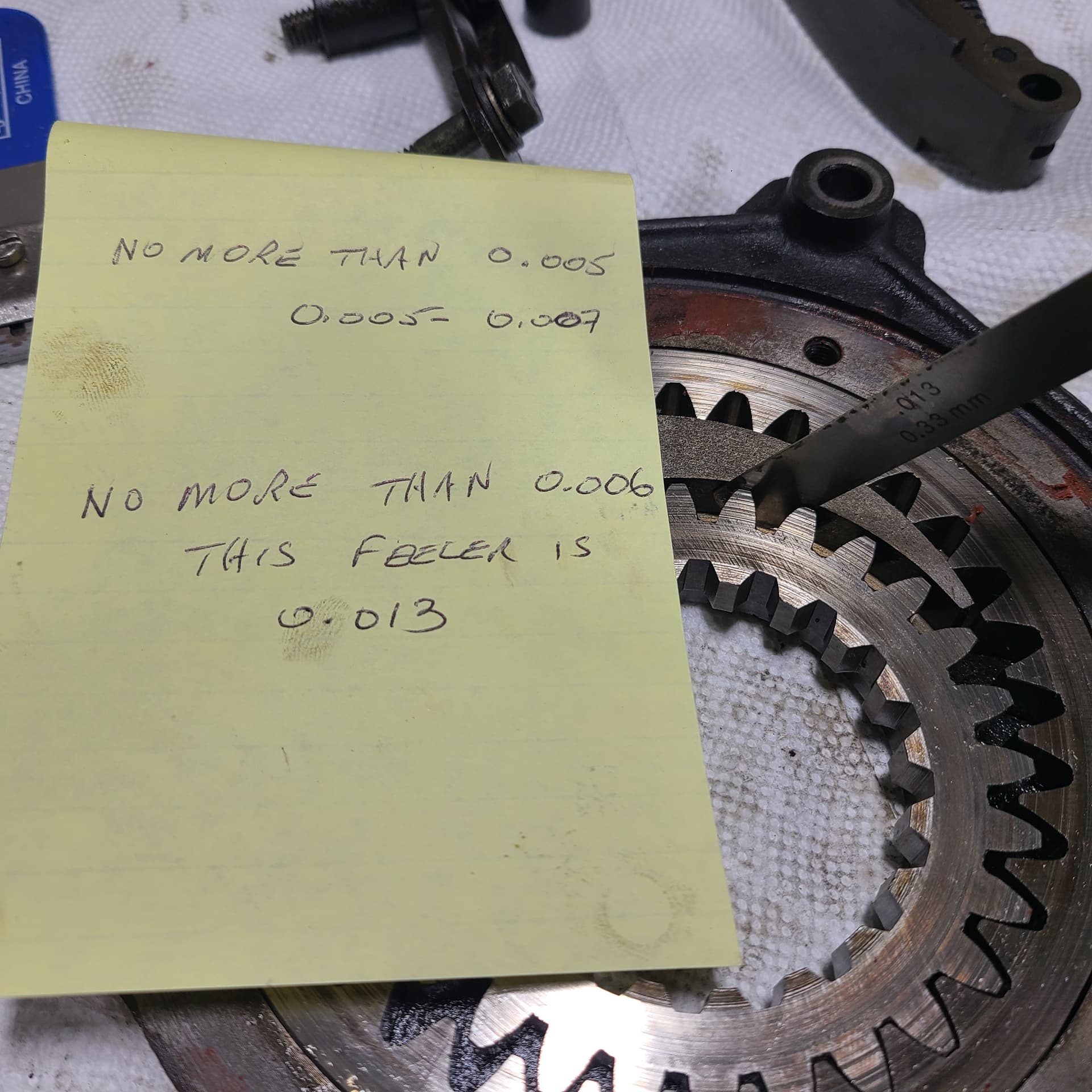

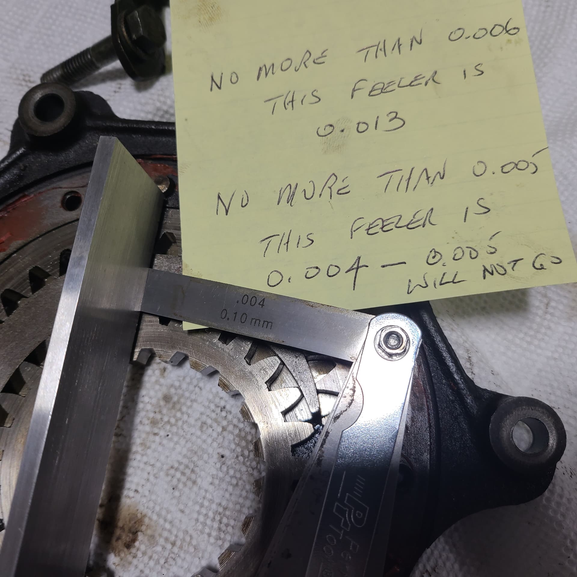

Some measurements - the top note is for between the large gear and outer edge of the casing. The photo shows the gap between the small gear and crescent
6 - Measurements - gap between Inner Gear and Creasent1920×1920 255 KB
Finally some good news-- but not good enough to over balance the bad news
7 - End Gap - This is Good1920×1920 241 KB
So – my budget just took a hit. This Jaguar stuff is not for the weak of heart or thin of wallet

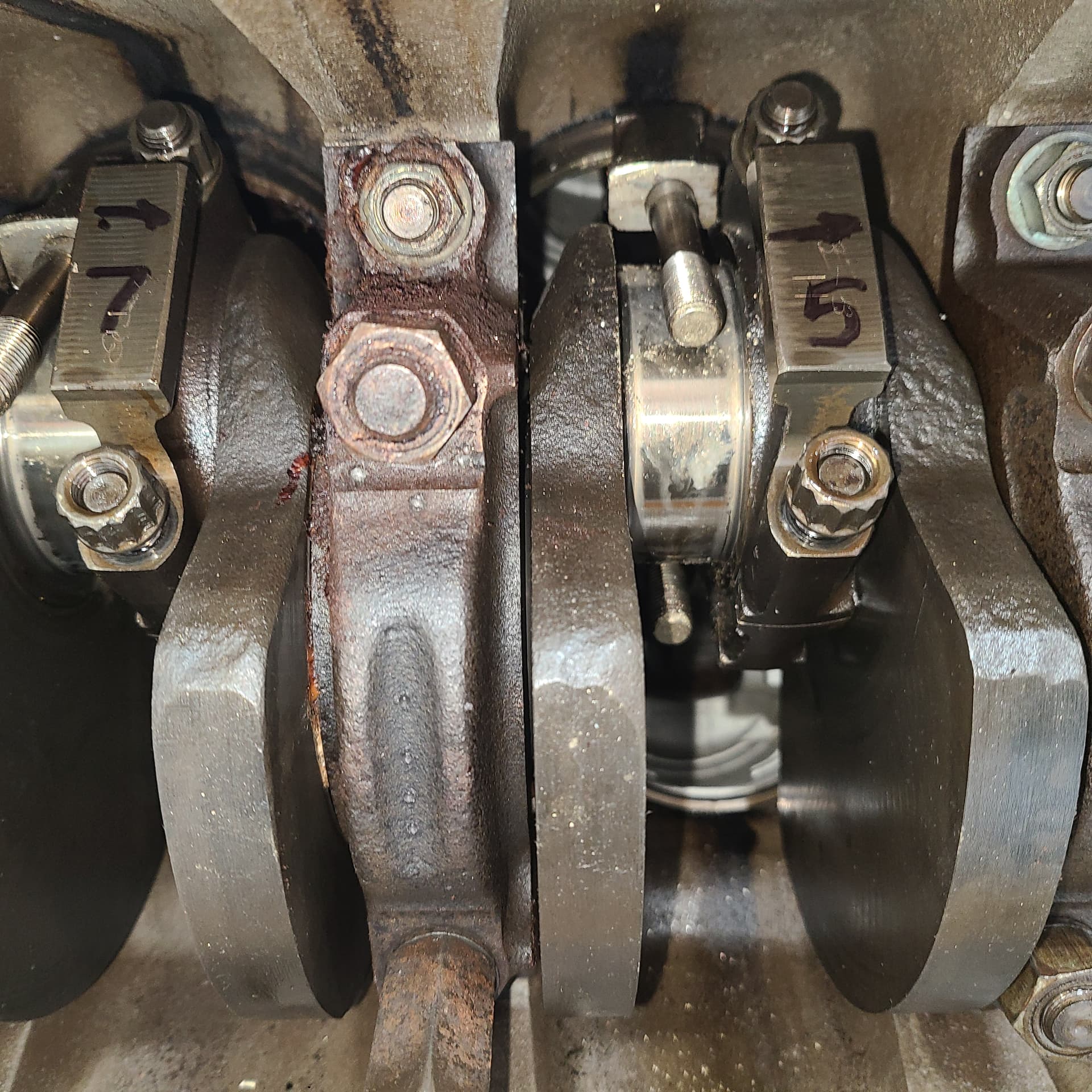

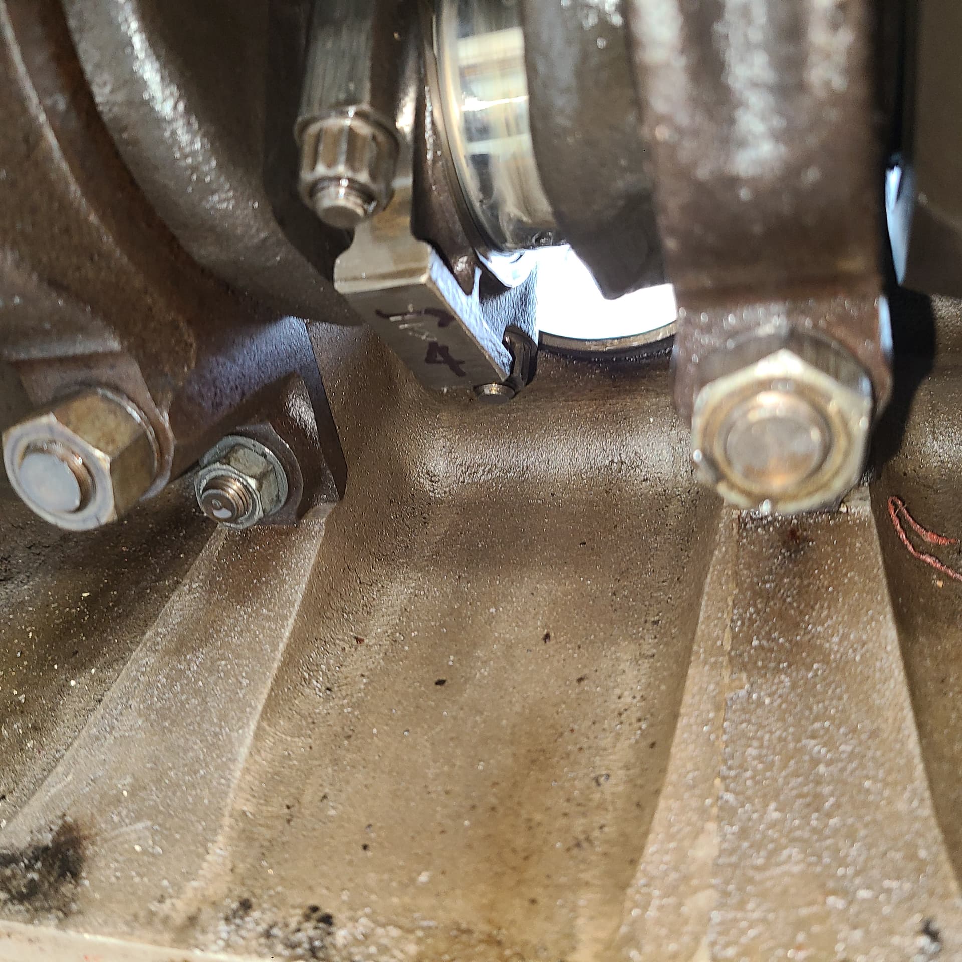

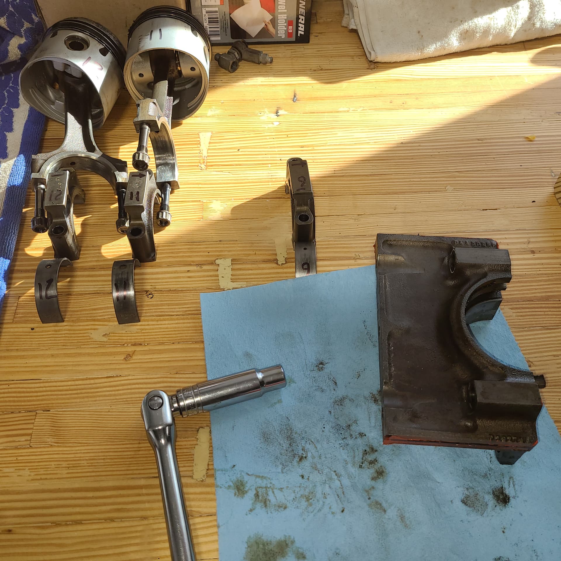

24JAN22 - I turned my attention back to removing the crankshaft, pistons and liners.
The crankshaft in my original engine is not coming free nearly as easily as the one I extracted from the spare short block I purchased. (and used as a practice procedure). While the spare crank came out easy enough, at least three and perhaps 4 - 5 pistons are trash. I’m not sure about the sleeves.
The process to remove the crankshaft was familiar and started with numbering each piston’s bearing saddle 1 thru 12 from the front of the engine block (I coulda used the 1A and 3B designations formulated by Jaguar but I confess I have a hard time remembering which is the A bank and which the B. Then, looking at the block upside down I know I would get it backward). Then I extracted the crankshaft bearing housing. After I remembered to remove all 6 of the nuts on the studs (the two small ones on the inside of the fitting were well hidden and easily forgotten) it slipped out with a small bit of tapping with a brass drift and dead-blow hammer.
1 - Removing the Crankshaft Bearing Housing1920×1920 371 KB
While the pistons looked absolutely terrible on the crowns, once I got them out, they looked very clean and nearly new. See below. I didn’t take any shots of the underside of the crowns but they were virtually pristine.
2 - After 2 Hours, removed 3 Pistons and the Crankshaft Bearing Housing1920×1920 407 KB

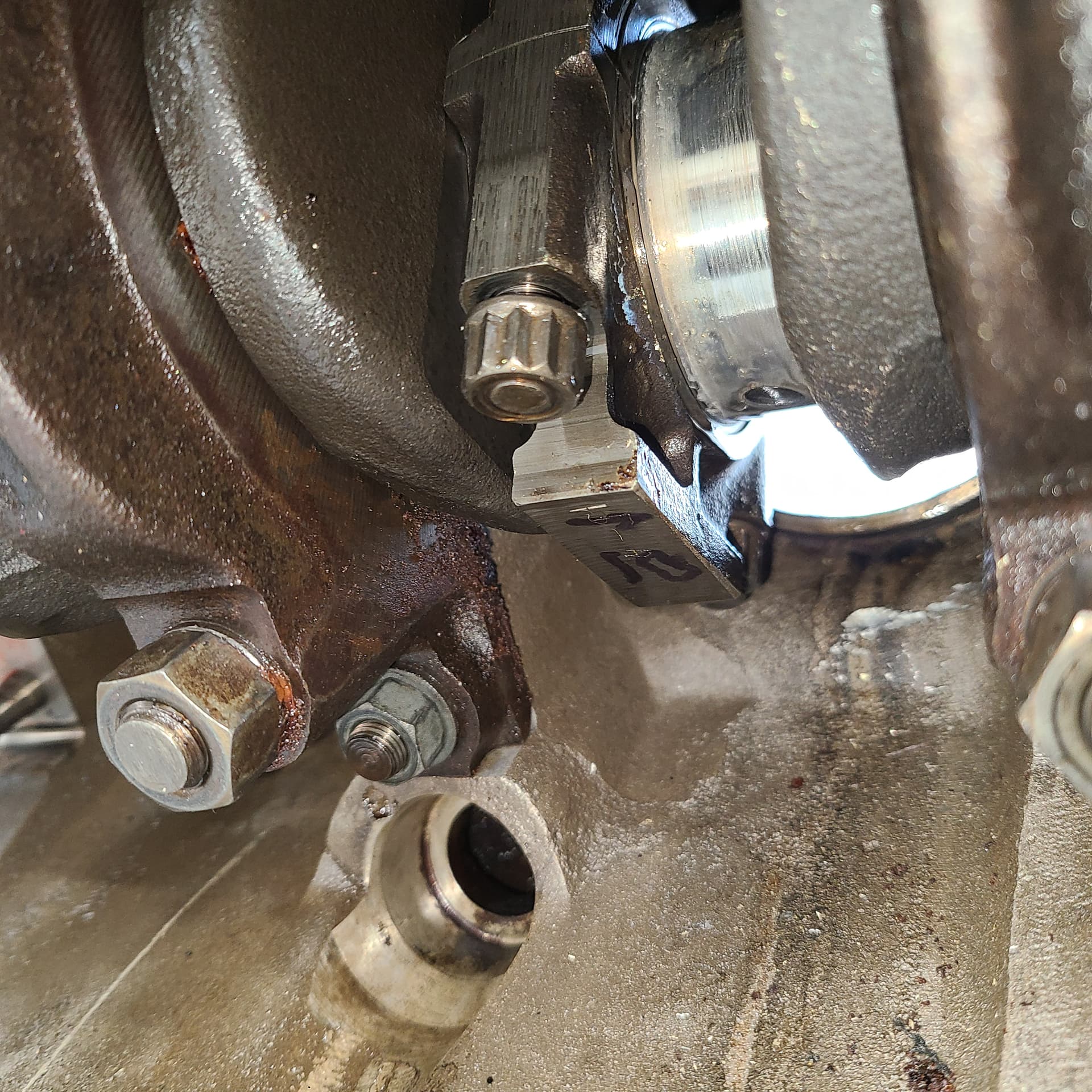

The efforts of day two was a mixture or success and failure. The success was the relatively easy extraction of 3 more piston bringing the total to 6. Failure: The remaining 6 pistons fall into three categories and are clustered together: the center 4 on one bank and the center two on the other bank. These were the pistons that had the biggest accumulation of crud on them.
Category 1: two pistons (# 4 and #10) whose position make access to the inside of the two ConRod nuts impossible.
5 - The rod labeled 4 also has ConRod bolts that are impossible to access1920×1920 372 KB
6 - The rod labeled 10 also has ConRod bolts that are impossible to access -- appears to be in the same position as piston 41920×1920 490 KB
Category 2: two pistons (number 5 and 7) whose position make access to the outside of the two ConRod nuts impossible (really the same problem as above, just that the ConRod nut is “pinned” to a different wall of the block.
These four pistons will likely be straight forward to be extracted IF I can resolve the issues surrounding the two pistons in category 3 (see next). I am assuming that once (if) I can extract the pistons in category 3, I’ll be able to rotate the crank and gain access to the last 4x ConRod nuts. But I’m getting ahead of myself.
4 - These four are not cooperating - the ones labeled 5 and 7 ConRod bolts that are impossible to access - the opther 2 are not budging1920×1920 434 KB
Category 3: two pistons that are defying all my efforts to extract. They are 6 and 8 and appear in the above photo.
Piston 6 shows the best chance of finally being extracted. The saddle is removed as are both halves of the bearing. The ConRod pivots on the Gideon Pin but not by much. This piston protrudes 0.2760” out of its sleeve. See last photo.
I’m not sure if the resistance is from the rings on the piston against the sleeve or the angle of the ConRod to the bottom of the piston not providing a good angle of attack for my brass drift and hammer. At least when I apply the brass drift to the ConRods and whack it – is has a hollow sound.
QUESTION: any ideas as to how to proceed? Patience and more thumping? (My lower back and shoulders are hurting after) Heat? if so, where is the heat applied? today’s efforts
Piston 8 is shown with a better view on the next photo:
7 - the poston to the left is locked solid - no movement whatsoever. Black streak very evident1920×1920 404 KB
You can see that my thumping has punched out the one ConRod bolt. A close examination also shows half the bearing is still in place. This piston is 2.7240” deep in the sleeve. This piston is locked in the sleeve solidly – when I apply the brass drift to the ConRods and whack it – is has a solid sound, as if it a part of the block.
So – when all was said and done, this is the state of affairs at the end of day 2 of the crankshaft extraction:
8 - Progress at the end of day 2. Six pistons extracted, two refusing to budge, and four with inaccessible ConRod bolts ANNOTATED1920×1920 404 KB

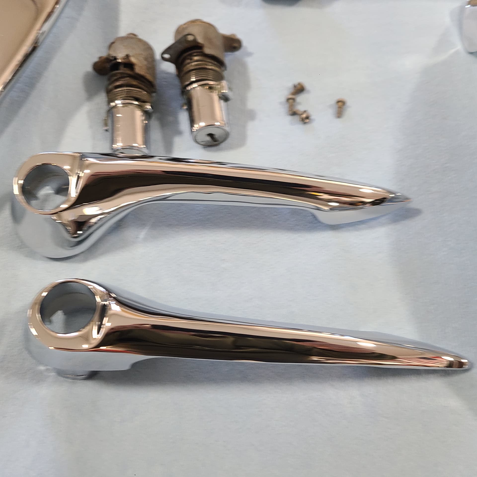

So, on 31JAN22) took my block to a machinist who was able to extract 2 of the pistons in 24 hours. He is still working on the other 4 as well as repairing the one stud hole that I damaged. Also he is hot tanking the block.
I also took my Timing Chain Cover to a welder who specializes in aluminum.
Then Colorado got hit with an arctic blast that dumped a bunch of snow and provided daytime high’s in the teens and 20’s – over night temps as cold as -15°F. The better news is that the chromer I opted to use made their next annual trip to an auto show in Colorado bringing my newer chromed pieces with them.
1 - Returned Chrome Pieces - Overview I1920×1920 243 KB
1A - Returned Chrome Pieces - Overview II1920×1920 370 KB
I rejected 5 pieces and they agreed to re-chome them:
  • the left eyebrow was scratched during storage/transport
  • the center rear bumper was scratched during storage/transport
  • several dimples in the top windshield chrome strip were missed prior to chroming
  • the chromers assumed a face of the L/R A-Pillar dress pieces were covered by upholstery
They removed the push buttons from the exterior door handles for chroming. Looks like they ground off the attaching bracket from one of them.
3 - Returned Chrome Pieces - Door Handles and push buttons1920×1920 186 KB
The left tumbler housing is pretty beat up. I have found replacements and now have both tumbler housing waiting ot be fitted
4 - Returned Chrome Pieces - Close-up for tumbler casings1920×1920 311 KB
Some more happy snaps
8 - Returned Chrome Pieces - Long Trim pieces - side door spears, long and short door casing trim, window1920×1920 275 KB
5 - Returned Chrome Pieces - Interior Door Handles, Window Winder Escrutcheons1920×1920 428 KB

I had plans for wrenching today (08FEB220 in my hobby shop but 2 calls derailed those plans – in a good way

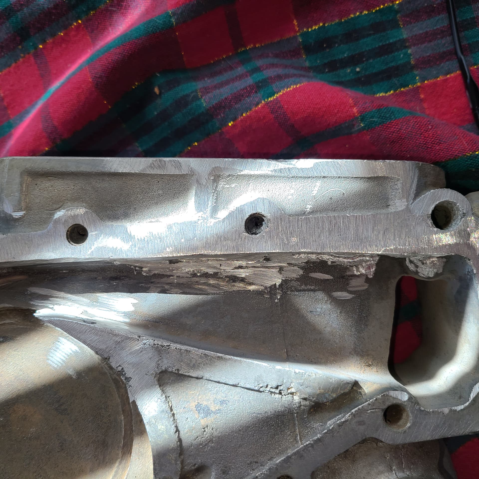

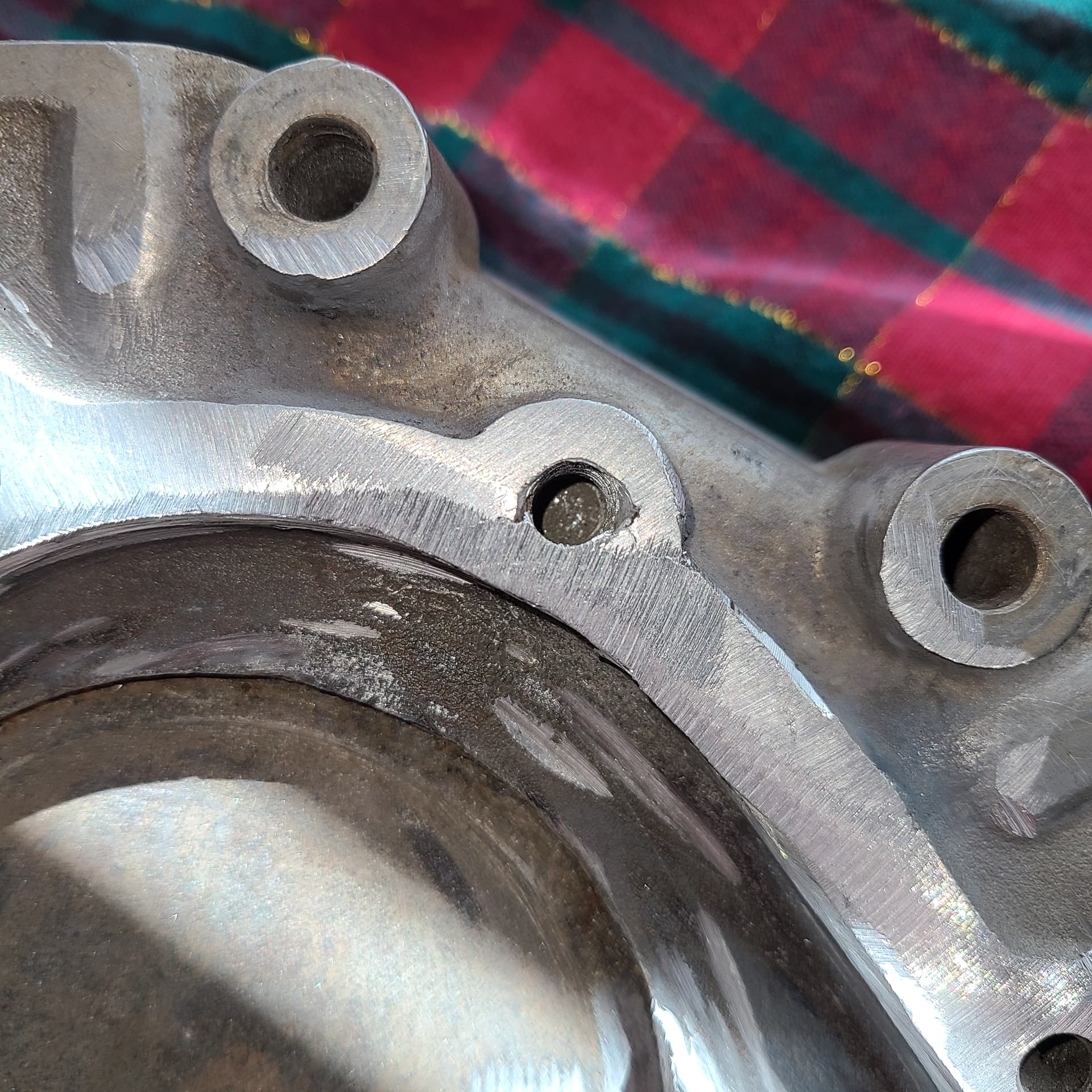

Call 1 – the aluminum welding repairs were done on the water pump cavity of the timing chain cover.
As a reminder, this is what needed attention.
BEFORE
AFTER
5 - Overview1920×1920 542 KB
6 - Upper Left Bolt Hole1920×1920 444 KB
7 - Straight Away Repair1920×1920 451 KB
8 - Upper right bolt hole repair1920×1920 453 KB

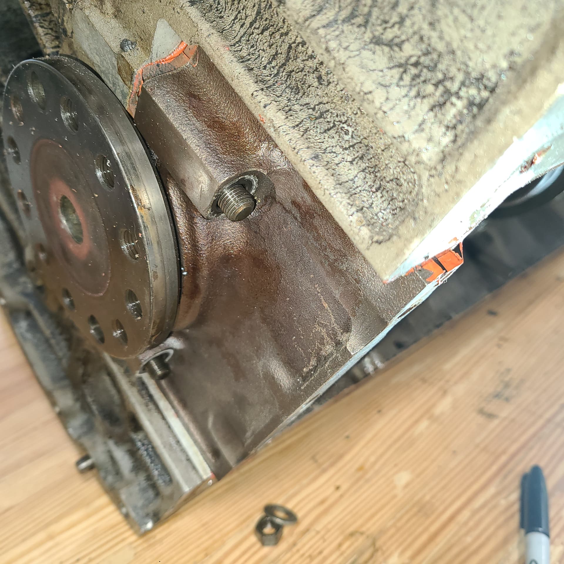

The second call was from the machine shop where I took my block cuz
  1. Hot Tank
  2. Six Stuck Pistons/Sleeves
  3. Buggered stud hole
The Hot Tanking was straight forward – but I was expecting a cleaner outcome. I’ll be spending some time scrubbing the block – inside and out.
Repairing the stud was also a walk in the park for a machinist.
Now – unsticking the pistons/sleeves was a horse of an entirely different color. One piston/sleeve came out with a significant struggle and he had to use a band saw to slice the sleeve in two to extract the piston. I need to reuse the connecting rods as the are NLA. With the eBay-purchased short bock I have another 24 to choose from.
Another 2 of the 6 pistons/sleeves required some creative machinist-ology. Martin needed to build what was essentially a four-foot long slide hammer. I neglected to ask the weight of the slide.
Martin needed to make two holes 180° apart in the top of the sleeve so the “hooks” he added to the slide had a place to gain purchase. Two of the sleeves were so stuck that the force of the slide broke out a somewhat hemispherical chunk of material from the top of the sleeve requiring a new pair of holes to be made. It is no wonder I was TOTALLY unsuccessful in my combined efforts to turn the crank using the crankshaft bolt in the snout.
A close look at this first photo shows the repairs stud hole - 3rd from the right on the leading edge of the block (a darker hole (steel) than the others in the aluminum block):\
Passenger Side1920×1920 456 KB
Driver&#39;s side1920×1920 439 KB
Driver&#39;s Side from Above II1920×1920 445 KB
Custom Made Tool to Slie Hammer (1)1920×1920 458 KB
/\ The big green end was machined to fix precisely into the sleeve once the piston was extracted or pushed down into the hole. The slide part of the hammer was at least 3.5’ long. It turns out someone somewhere along the way used an adhesive to glue the sleeves into the block. No bueno. They are held in place when the head is torqued onto the block
The machinist originally estimated $700 - $100 per stuck piston and then $50 to fix the buggered hole and $50 for hot tanking.
Due to the extreme efforts to remove the pistons/sleeves and having to fabricate/machine the special slide hammer, it came to $1,000

Finally got off my **** and back in my Hobby Shop. On top of arthritis and gout, I threw out my back by – get ready – standing upright after bending over engine bay of my 62 Thunderbird for nearly three minutes. Ouch. Damn – how pathetic. Another week on the couch.
I did use my “down” time to ship out some parts:
  • 40 pounds of bits to Van Nuys Plating for cadmium plating
  • all the gauges to West Valley for rebuilding/refurbishment except for . . .
  • the clock to a Jaguar forum member who is expert
  • dropped off my 3 header tanks to a radiator shop to have the best of the lot rebuilt
  • took my 65 Riviera to a shop for some upholstery work
In between of all of that, when my knee, ankle, and back worked simultaneously, I started laying the wiring harnesses.
  • threaded the bulkhead harness around the internal dashboard structure
  • threaded the left side harness through body structures from the trunk to the steering wheel
  • threaded the right side harness through body structures from the trunk to the glove box
  • started connecting them together
I got the passenger side bulkhead harness clamped in place
PASSEN~21920×1920 279 KB
BELOW: the purple wire with white trace (at about 11 o’clock in the photo) took me two hours to install. It is the wire for the plunger on the a-pillar shut face for the map light. Just behind the bracket for the glove box at 9 o’clock is a body grommet the wire threads through – the plunger is just above the door check strap. The distance between the two is ~4-5 inches and involves the wire making a 90° turn to join with the plunger. To use the only aperture in the body structure would have involved having two more wrists on my left arm if it were the size of a 9 year old girl.
Passenger Side - Join of Bulkhead Harness with right Side Harness1920×1920 343 KB
I also connected the bulkhead harness to the driver’s side harness . . .
DRIVER~21920×1920 315 KB
. . . and discovered a bullet terminal missing off the orange wire. I reckon I’ll snip of the existing terminal and join the orange with a basic **** connector. I have the tool to snug the terminal to the wire, but don’t have a spare bullet connector; and the ones on the old harnesses have been crimped.
Tomorrow, I continue securing the bulkhead harness to the dashboard structure in the middle of the car and progress to securing the harness to the structure behind where the tacho and speedo will reside.

Attacked several areas on my Jag on 11MAY22
3 - I nearly finished installing the bulkhead harness.
Overview of progress at end of 11MAY22--1920×1920 418 KB
It took 2-3 hours to get this far. I had a few false starts
I ended up installing the harness clamp that is centered on the glove box space 3 or 4 times. I needed to uninstall several times to get enough slack in the harness to install other clamps. For any other Series III-ers installing a new harnesses - I needed to change tge orientation of the clamp to the left of the glove box opening. The way I initially installed the clamp (on the underside of the center panel) pulled harness downward – the clamp needed to pull the harness upward. This to clear room to install the cardboard-y ventilation hoses
The other backward step was mixing up attaching orientation the smaller limbs of the harness directly behind the steering wheel.
Driver Side Bulkhead Harness in place and labeled1920×1920 489 KB
Both these clamps are clearly visible and didn’t require contortions to bolt down. It was simply irritating to have to swamp over this two lengths of the harness.
What I should have months ago took me a coupla hours today. I labeled all the terminals on the harness – not just 20-30% of them figuring the unlabeled ones would be obvious. Still need to address the wiring in the center of the dash. These should go pretty quickly cuz groups of attached by bunch to the fuse boxes. Yeah – right; we’ll see how that goes.
On the passenger side, just need to connect two cans/flashers/somethings to the footwell and attach a total of 5 wires.
Passenger side justs needs two cans attached to the unpainted ve1920×1920 445 KB

Th afternoon of 12MAY22, I just about completed all the connections in the center of the dashboard – at least from the bulkhead harness. I installed the hardura (?) element which is held in place by the top two fuse blocks; also installed the other two fuse blocks.
I was gonna start labeling all the wires when it dawned on me that the old harness was laying right there and was a perfect template. Since I was installing 4x new fuse blocks, even the old fuse blocks were intact on the old harness. So – I laid the old harness across the scuttle and followed started attaching new wires.
1 - Its easier to use the old harness as a guide1920×1920 521 KB
Just about got it – just need to chase down a few issues.
2 - Just about got the Center Panel rewired1920×1920 556 KB
The first issue I need to resolve in the new harness has 5 relatively short purple wires implying they all connect to lower left fuse block
3 - New harness has 5 purple wires . . .1920×1920 307 KB
The old harness has the 5 purple wires but only 4 go to the fuse box; one is much longer and has black ring on it. Other wires have this colored ring on it so I know it is significant. Just haven’t figured out that significance yet.
4 - Old harness has 5 purples but 1 is long and has black ring1920×1920 391 KB
The second issue is less daunting and Jaguar forum members who have replaced their harness may be able to answer it. The new harness has two long brown wires leading to one fuse box
5 New harness has 2 long brown wires . . .1920×1920 350 KB
Whereas the old harness has two equally long pair of wires leading to the same fuse box, but are whitish or a grey color. Are they the same pair if wires? Logic says yes, but . . .
6 - Old harness has the cloth wrapped whitish wires1920×1920 346 KB
Also cleaned up some wires attaching to various cans and flashers in the passenger footwell;
7 - Finished up attaching 2 flashers in passenger footwell1920×1920 214 KB
And I have 1 oops to trace down. This red wire is attached to the same fuse box with the other red wires on the upper right fuse box. I didn’t note where this red wire with a small bulb on the end goes. After 48 hours of exchanging messages with Jaguar forum members (and checking my photo archives), I discovered this wire/bulb drop down from the fuse box, curves outboard and behind the glove box to plug into the choke becoming the choke indicator lamp. It is NOT on any of the Jaguar or after market wiring diagrams -- of whohc I have several.
20220512_1605471920×1920 273 KB

Wow that looks incredibly confusing! Sending you best wishes on getting that straightened out and installed correctly.
Jay
C
Craig Balzer
Sep 21, 2005
876
Colorado Springs
Thanks Jay -- I am not moving quickly and I double check (and sometimes triple check) the connections on the old harness before moving on to the next wire. My goal is for the car to start on the first crank and all gauges, accessories and things to work right out of the gate.
We'll see
