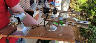

Well I take that back. I guess they are just polished to high heaven.
