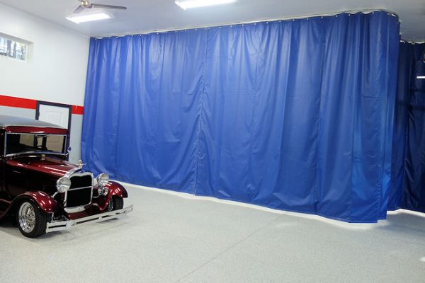

where are the workbenches, storage cabinets, toolbox spaces. You need to leave / make some room for them.
And likely inside the Lift space or immediately adjacent.
Maybe a curtain wall that will hold the conditioned air, but can be opened otherwise. Seems odd to have such a large space and wind up effectively working inside a single-stall garage.
Curtain? Novel Idea! Quick google search led me to this...
https://www.curtain-and-divider.com/industrial-insulated-curtains/insulated-curtain-walls/
