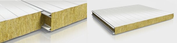

Pardon my terminology, I am not used to discuss buildings in English.
The idea is to use wood beams (gluelam) for the frame/trusses and rockwool sandwich panels for walls and roof. Also for the walls separating the shop/garage and garage/apartment.
Here is example of roof panel;
Wall section:
The inside of the garage or shop could look something like this:
While these materials are rather expensive, the upside is - once the frame and walls are up - the shop/garage are "done" on the inside as well, saving considerable labor cost.

In North America your insulated panel example is usually referred to as SIPs - Structural Insulated Panels
That acronym might help you find a lot more resources and design ideas.
Likewise, the sort of large structure combining living quarters with workshop or storage space is often called a 'barndominium' and often an offshoot of pole-barn building designs.
There's a YouTube channel named RR Buildings that specializes in those sorts of buildings, but they are mostly about construction methods and materials and not so much about design.
In American Residential building codes there is usually a requirement for continuous wall / vapor / fire barrier between the residence and attached garages or similar space, both to extend the time for a fire to burn through and protection against carbon monoxide. This barrier extends thru the attic space, dividing the garage attic space from the house attic space. But there it is typically no more than the simple roof decking plywood. And even then that is penetrated for water and power and ventilation ducting and not fully sealed. So the fire protection is notional at best.
I've been researching and dabbling with similar shop / living quarters ideas for a couple years and got far enough in one design to dabble with drawing it up in SketchUp, but haven't done anything further along those lines in the last couple years since the COVID nonsense hit.
Thanks for the info.
Using rockwool SIP's as firewalls (4-5") thick is up to code separating living quarters from garages over here. The alternative would be a wall 4" thick, filled with rockwool, held in place with wire mesh and covered with double 3/8" sheetrock on both sides. Then we have codes for structural integrity -- 1 meter of snow on the roof. Hurricane wind speeds and earthquakes up to 8 on the Richter scale. All living quarters have large enough operable windows to allow a person to escape fire. I don't know but I suspect our codes are as strict as they get. It follows building cost over here is rather high.
