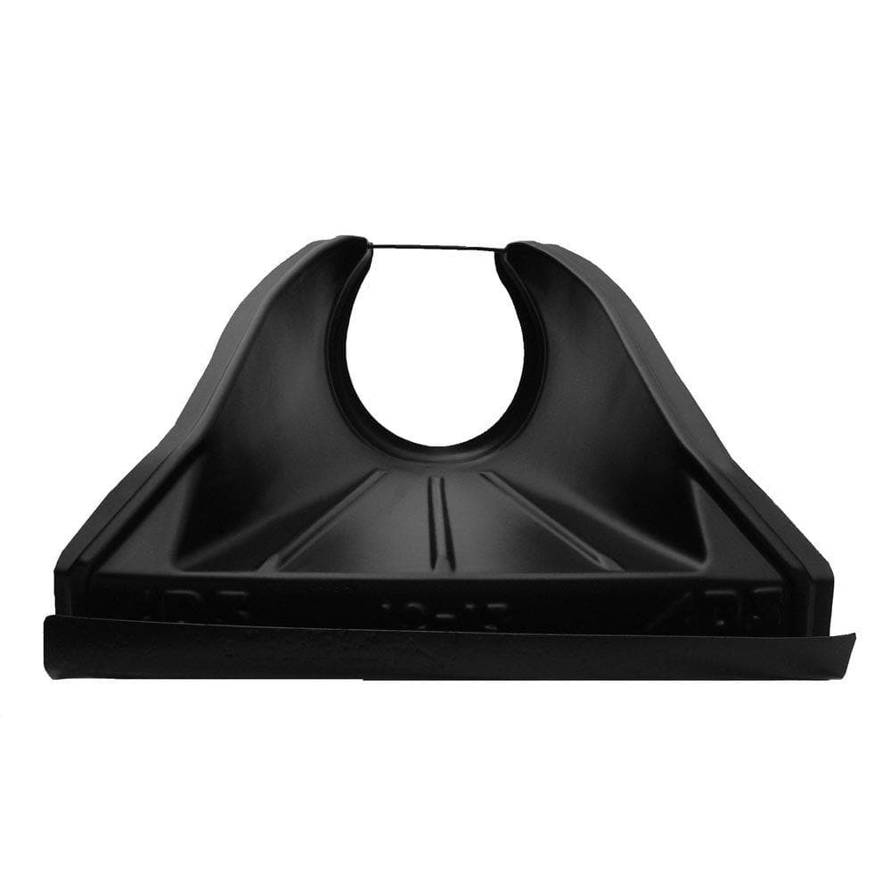

Nothing wrong with the HDPE pipe. What’s important is the grade it’s set at. The outlet end of one property needs to be higher than the inlet side of the next property downstream and continue that grade down the ”block”. Usually (around here anyway) the county owns an easement and they dictate the elevations these need to be set at and they maintain the ditches. In my particular “neighborhood“ that’s not the case. We own the streets too and there‘s little oversight on civil drainage. Often someone buys a lot(s) and will haphazardly throw a culvert in so they can cross a ditch to access their lot. If it’s too high or low, it screws up the drainage for the whole block. Then they are asked to pull it out and reset it to the proper elevation. Hopefully before they’ve laid a concrete or asphalt driveway over it.

The main issue I have seen with plastic culverts is lazy installers either not trimming the pipe or not burying it to the end.
Now there is a 4’ section that starts to float which then blocks water from getting into the opening and then the flow pushes it up more.
One idiot around the corner when it’s wet and really flowing will have the pipe bent nearly vertical and water going over his drive.
This is the single wall pipe that’s not as stiff as the double wall pipe

The Double Wall Culvert can actually float out of the ground in heavy rains.
If you drill holes in the lands, not grooves, this will allow water to go in and push the air out helping to prevent it from floating out. And plenty of dirt and or rock wouldn’t hurt either.

All we use for culverts and irrigation is ADS pipe, usually double wall. Most culvert failures we see is either bad bedding, poor head walls or both.
