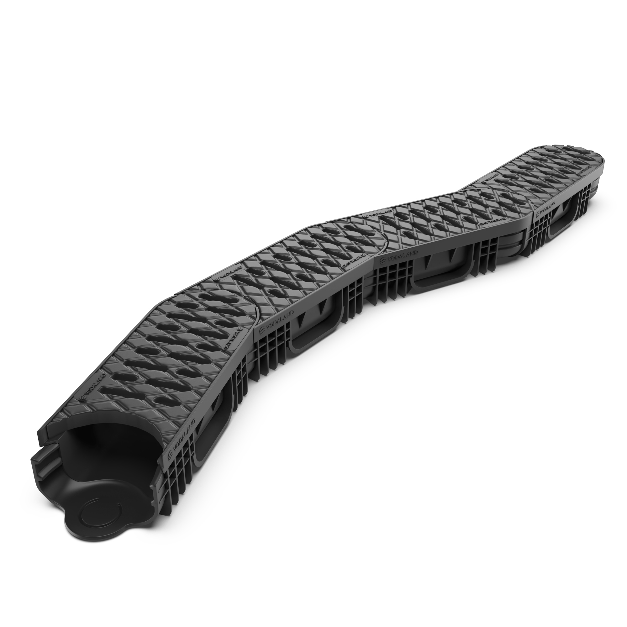

Thinking something like this against/near the wall...?

I had a similar situation and I just tapered the last foot on the edge near the wall so that it was a shallow swale that the water could collect in and run off down the hill. Easy to clean with a broom or the pressure washer. I also had drain pipe behind the retaining wall so that any water coming down the hill would be caught and moved away before putting pressure behind the wall.

This is what I did along the sides of my boat shed where it meets the slab for my 'parking' area around my workshop. Only a very slight slope but it drains well.

That is not a bad idea, I guess I could put an actual drain where it will go under the slab and out the other side....

A nice thing about the drain is that dirt falls down in there instead of collecting on the floor. Out of sight. Other than that it’s a lot more work to build a drain. That pool drain you pictured has short straight grates. If you pick the grate, the rat you can do by hand. My preference is to have it big enough to run a trenching shovel through once a year, but a tiny gardening trowel would be okay too.
Alternative would be plastic pool drain. They make a reasonably large curvable version.
