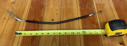

I have a 1980's Honda riding mower that I still use at home. It's a fantastic machine but Honda is starting to phase out some of the parts. One of the clutch cables frayed out recently and there's no replacement.
Can one of you fine folks advise me on how to seek out a custom replacement? Unfortunately repairing the frayed end is not longer an option as one of the mounting studs also sheared.
Thanks!

Atlanta Powertrain did not want to talk to me once they heard it was a lawnmower application. Fine.
Got a call in to Steinjager to see what they can do.
Would love to fix myself but the sleeve is broken too, not just the end.

Hey JZ, I've had very good service with www.cccables.com. They made some shifter control cables for my sand cars and they did an outstanding job...the cables were perfect and they were very reasonable on pricing. :thumbup:
Thank you! I found those guys today too and they actually called and asked for details. They're my best bet so far!

Push-pull.com in Chico CA came through for me. They were super helpful and were able to repair my original cable since it had some custom Honda parts. Reasonable pricing as well.
