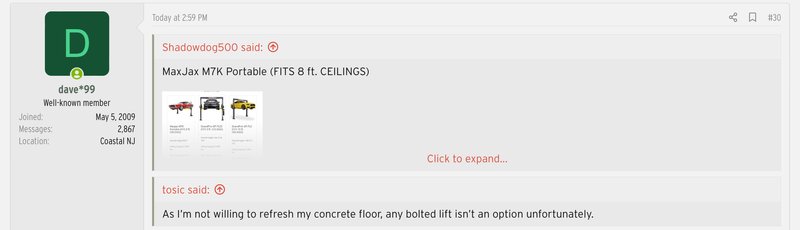

Well I said those scissor mid rise lifts block quite a bit. And I’m really not sure about my concrete and for my peace do mind I’d have to do a whole new floor for a 2 post or a max jax.
That’s why I initially stated 4 post vs 1 post.
So seemingly most of you guys would favor a 4 post out of these :)

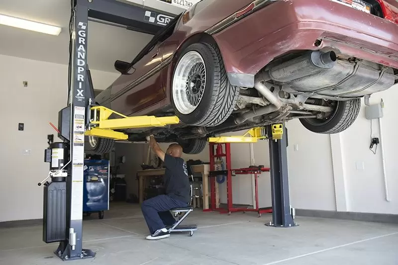

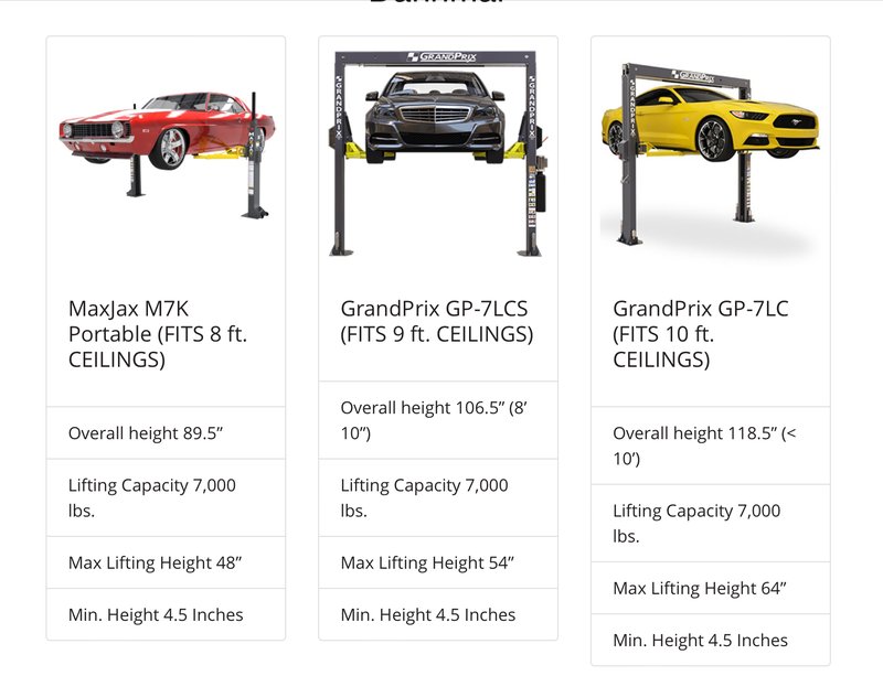

Why not get a low rise 2 post lift that is made exactly for your situation.
Here is the one that BendPack makes but there are others that make them.
I know there is someone on this forum with a low rise lift that really likes it. He has a reclining chair on wheels that looks very comfortable to work while sitting in. It almost looks like a comfortable office chair would work great.

Did you post a picture? It doesn’t show unfortunately 😅
Seems like a Max Jax or a low ceiling 2 post might actually be an option but I would definetely want to have my floor checked by some specialist before.
That’s the advantage of single or four post - set up an go.
This says its for 9 foot ceilings.
I would not buy the Grand Prix because you lose 6 inches of your limited height due to the massive crossbar. A max Jax would be better if the lift height is 48” or less. If over 56” then maybe the Grand Prix is better.
