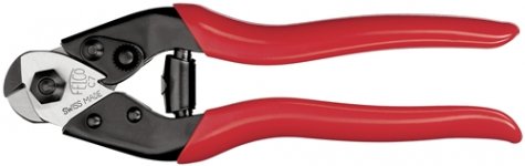

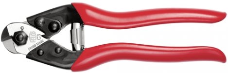

Felco C3 or C7 hard cable cutters. The C7 model is what your more likely to find. The C3 are designed to have a smaller jaw opening, but the steel is slightly harder.
The jaw capacity of the C3 cutters is 3mm/0.12".
http://www.felcousa.com/felco/pages/product.page?name=FELCO C3
The capacity of the C7 cutters is 7mm/0.28"
http://www.felcousa.com/felco/pages/product.page?name=FELCO C7
The felco cable cutter design is the one a number of companies have tried to copy. None of the copies I've tried has worked as well as the actuall Felco cutters. The bolt, nut, and spring on the Felco can be purchased separately in case you need to replace the part for some reason. If new ones are too expensive you should be able to find some used ones on Ebay for a lower cost, such as these.
http://www.ebay.com/itm/Used-Swiss-...823?pt=LH_DefaultDomain_0&hash=item5659b4a6a7
http://www.ebay.com/itm/Felco-C7-Ca...176?pt=LH_DefaultDomain_0&hash=item1c343b2b18
