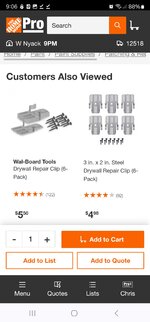

They sell drywall repair clips at most big box stores that will make short work of putting cut piece back in place. A piece of pine 1x2 or other scrap wood also works fine. The clips leave a small piece of metal on outside that has to be taped afterwards.
