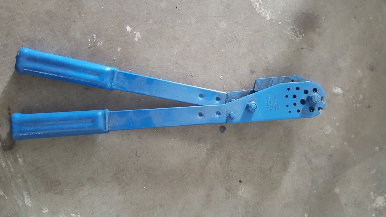

I use a rod shear most of the time, but they're kinda pricey new. Makes a pretty nice, clean cut with minimal futzing around, but you sometimes need to soften the lead in on the belt sander or deburr wheel.
