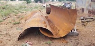

Cutting up large tanks!
PCustoms
Jul 23, 2011
22,221
VT
Cut up an old oil tank with a carbide recipe blade, like warm butter with a hot knife.
Cut up another one with metal cutting recipe blades, still like warmish butter. Save money and get a 10pk of standard metal cutting blades.

What if one had gas in it?
You would have to also have oxygen in the tank at the right level for there to be any combustion. And old gas has long since lost its volatiles (meaning you can hold a match to it and it may not even light) unless it was in a completely sealed container. It's not that big of a danger as people make it out to be.
As stated in another post - fill it with water to displace any vapor, and bonus, the water will also keep the cutting blade cooler.

To avoid spark issues, Nibblers and strip shears are routinely used for cutting up old fuel tanks.
The only major issue is cost.
The Nibblers and shears you might want to use, can easily cost $1000-$2000.
A reciprocating Saw or decent jigsaw would be the next best option, but there’s more of a chance of sparks.
An Angle Grinder with cutting blades, whether bonded abrasive or “permanent” diamond, would be the next option, but there would be a lot of sparks.

Friend of mine was killed cutting up "old, empty" oil tanks.
I filled a 500-gallon fuel-oil tank with water. Hadn't been used in at least a decade by that point, and had been stored with the bungs open. As I was cutting it, the gunk floating on the water caught fire several times.
Be careful.

I know this is post problem as OP got it done but what about shooting fire extinguisher foam into a questionable tank, coating the inside walls before cutting? That would seem way easier than filling 500 gallons of water?

I have done that, works good.... You can use any internal combustion engine... Lawn mower or whatever you have handy....

If you have a Kegerator, you can use CO2, too. I did that once to TIG up a car gas tank. (Emptied, rinsed, blown dry, left to sit a week inside with an open cap, dumped a ton of CO2 from a 20-pound tank in there, left a small regulated hose running while I rand the bead. No issues.)
On the other hand, I know a guy that was literally blown through the wall of his shop welding up an aluminum fuel tank- he survived. Pic of the tank showed it peeled open like a banana.

FYI you can inert the tank with dry ice. Tape over any holes except one at the top. Once a visible "Fog" is coming out the top hole you left open, all the air (oxygen) has been pushed out. CO2 is denser than air, and will push the air out the top. A little water with the dry ice speeds the inerting process.
