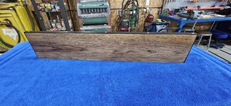

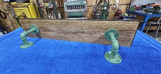

I had to put the drill press on hold today, I have a really nice lady that I have worked with for the past 18 years and she is retiring on March 27th, so I decided to make her a shelf for her retirement party gift 🎁
I got to work in my wood shop today :ROFLMAO:
I cut a piece of hickory 30" x 6" that I had on hand and then added some flat stock steel to it on three sides and attached it with some #8 brass wood screws.
I got the mounts finished too, I used some 1/2" floor flanges with some 1/2" black pipe ******* and elbows, I soaked them in degreaser and got them primed.
I will paint the steel on the shelf flat black and the shelf mounts a moss green and I will give the hickory a couple coats of stain to finish it off.

Nothing too exciting in DaBarn this week, I did finish up the shelf in time for a retirement party for a special friend next week 🎁
I painted the two mounting brackets moss green, and the steel around the edge flat black, I put two coats of dark walnut stain on the hickory wood followed by two coats of polyurethan, I used 0000 steel wool in between coats. I hope she likes it :thumbup:

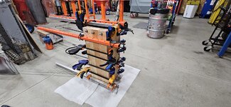

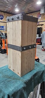

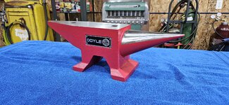

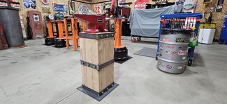

Oh look squirrel 🐿️ I got distracted and set the drill press parts aside for now. I purchased an anvil back in December and I wanted to get a stand built for it ever since, so I started one last weekend.

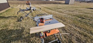

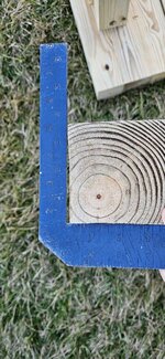

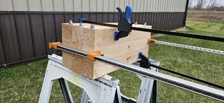

I bought some treated 4x4's and cut them down to 26" long, when I went to test fit them up I realized how out of square they were.
I had to scrap these :rolleyes:
I went back to the big box store and found some Douglas Fir 4x4's that were finished square on all four sides, Douglas Fir is a little softer then what I wanted, but I'm not planning on doing any real Blacksmithing on it, I will just be using it for light duty work.

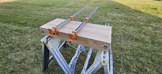

I made a cardboard template to locate the holes for the 1/2" threaded rods, so they all end up in the same spot :unsure:
I drilled and glued three rows of three together and let them dry over night 🗜️
I drilled 1/2" holes through the center for three more threaded rods and did a test fit.
I sanded the three sections where they will mate up to give them a tight fit before the final glue up :thumbup:
A QUICK RIDDLE: how many clamps does it take to clamp up an anvil stand after gluing it?
Answer: ALL OF THEM :ROFLMAO:
Or at least sixteen, because that's all I had :ROFLMAO:
Now to let it sit for a couple of days to cure :thumbup:

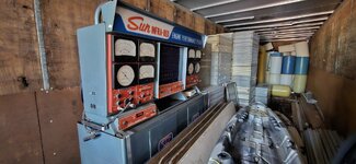

I came across this Sun Automotive tester this week in a storage container here locally, I don't think I have ever seen one of these so complete and in such good shape and it still works, I can get it for a good price, but I think I'm going to pass just because of the shear size, I really don't have the room! :unsure: :(
