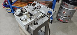

I recently acquired from a very special friend, maybe one of the coolest additions to DaBarn ever!!! it inspired me to get back out in "The Little Party Garage" this week and play :)
Its a Champion spark plug cleaner/tester, as you can see in the photo the legs were bent over, it being sheet metal they required some special attention.
After a complete tear down, I cleaned all the pieces with Zep industrial purple cleaner and degreaser, then I used a body hammer and dolly to straighten all the years of abuse.
After several attempts to stiffen up the base with angle iron, I ended up scrapping that idea as it really didn't look that appealing to me, so I went in a different direction with some sheet metal.
This is the backside, it ended up working out really well, it is super strong now and it looks period correct and I only had to add two extra holes to the base on each side.
Here's the front side completed too, I added all new 10-32 bolts to the entire piece.
Here's some miscellaneous pieces that I cleaned and polished :cool:
This is the media canister, from the online pictures that I found it looks like it was covered with a canvas or some other sort of soft material :unsure:
It measured exactly 6" across so I picked up a piece of 6" stove pipe and cut it to the proper length.
I cleaned the canister up and wire wheel the clamps and sprayed them black, then I installed the cover, PERFECT FIT (y)
I polished the rest of the canister parts to complete the assembly, I'm missing the threaded cap for the canister.
Its ready to install.
I reassembled the entire cleaner, here's a shot of the top. I'm only missing one of the brass blow off fittings and I believe there were some different size threaded inserts for different size spark plugs that are missing.
Front photo.
The right side.
The left side.
And the back side, now I need to send it out to "The Big Party Garage" for one of those kick *** paint jobs :giggle:

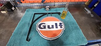

I found these two Gulf signs priced half off....so what the hell, they came home with me :thumbup:

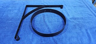

I used some strips of 16 gauge sheet metal that was left over from a different project and got to bending.
I drilled some holes in the l-bracket and welded the two pieces together for the hanger, then I rolled another piece of 16 gauge for the sign frame to make it double sided.
I picked up some small black chain and i-bolts to hang the frame from the bracket, I even enjoyed one of my favorite adult beverages Landshark 😋
I just need to drill a couple of mounting holes in the bracket to hang it and paint it black :thumbup:

To mount the two signs together on the frame, I just drilled two holes all the way through the two signs and connected them with two 10-32 x 2" bolts. It worked out pretty good :thumbup:
Tony, you could also use binding posts for the attachment. You get the same fastener head style on both sides of the sign that way. This assortment has a slotted/phillips head on one side.

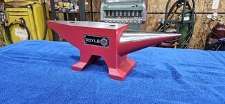

I took the Harbor Freight gift card to my local store today and picked up their 65 pound anvil, I have always wanted a anvil, but I could never find a vintage anvil in good shape that didn't cost a fortune, this anvil has pretty good reviews and its very affordable, but you have to inspect them pretty close before taking them out of the store, the top face of these can be very pitted and its where they have welded up bad spots in the casting and ground them back down, the first one I opened up at the store had a lot of pitting on the face and it looked like they ground it with a flap disc and did a horrible job of it! it looked really bad! the one they had on display was in perfect shape and the top was surfaced ground and looked awesome! so the store associate kindly gave me the display model. I'm going to build a stand for it and I will post that when I start it :thumbup::thumbup:
I'm not going to be doing any blacksmithing stuff, so this anvil will be awesome for what I want to use it for.

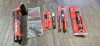

Here's a few new tools that the family got me for Christmas 🎅
Do you think they know I like Milwaukee 🤣

I finally painted the frame and hung the Gulf sign up :beer:

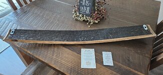

My wife bought me a pretty cool birthday present last week, she ordered it online from Holtz Leather Company, its made from old authentic used white oak bourbon barrels.
Hung in DaBarn :thumbup:

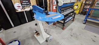

I also Decided to buy myself a birthday present 🎂 A Baileigh BR-18E-24 power bead roller :cool:

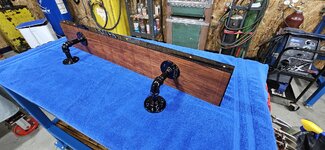

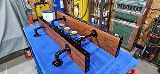

I decided to pull a couple of shelves off the wall that I made quite some time back, I painted the steel parts and put a few coats of boiled linseed oil on the cherry wood 🪵 and hung them back up :)

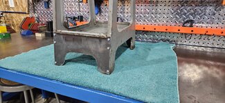

I bought this 1942 Craftsman drill press about 15 years ago and made this stand for it, it was about time that I tore it down and finish it after sitting in the barn for ever.
I picked up this really awesome Craftsman light in perfect shape with original paint, I just had to give it a good cleaning :thumbup:
I drilled and tapped a couple of 1/4-20 bolts to mount it on the stand.

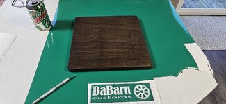

I made a shelf for the base, I stained it, then painted DaBarn logo on it and gave it three coats of spray poly to top it off.
I have all the pieces ready for the stand now.

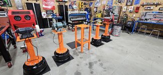

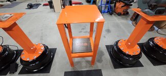

I decided to take the drill press stand and the other four pedestal's I made to the powder coater for a coat of safety orange 🟠

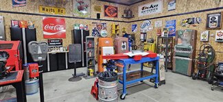

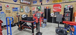

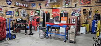

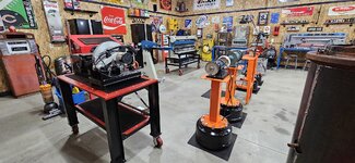

With so many new things going on in DaBarn I decided to reorganize the back half of the shop to make it a little more user friendly.
The first four pictures are before I started playing garage tetris.
And this is what it looks like now after playing garage tetris, I really like the new layout, I just created a circle in the center, the only issue is that I need to use a power cord to run stuff now.
I can rest peacefully now that I have satisfied my OCD. :oops: :unsure: :cool:

Tony, I hope you oriented everything off a datum line and then squared everything up with a laser.
Scott
I just went old school, a tape measure and a chalk line :unsure: :ROFLMAO:
Tony, That looks great, wish I could get back to my shop, it seems like the harder I try the farther away I get! can you put a recoil reel above your tool row?
Jim
I feel your pain, I think we all need more QST :cool:
That is a good idea on the power real from above, the only wiring that I do have in the ceiling is the lights, but I don't think it would overload the circuit if I added that to it. I have the lights wired on two separate circuits each one only has six lights on it. 💡
