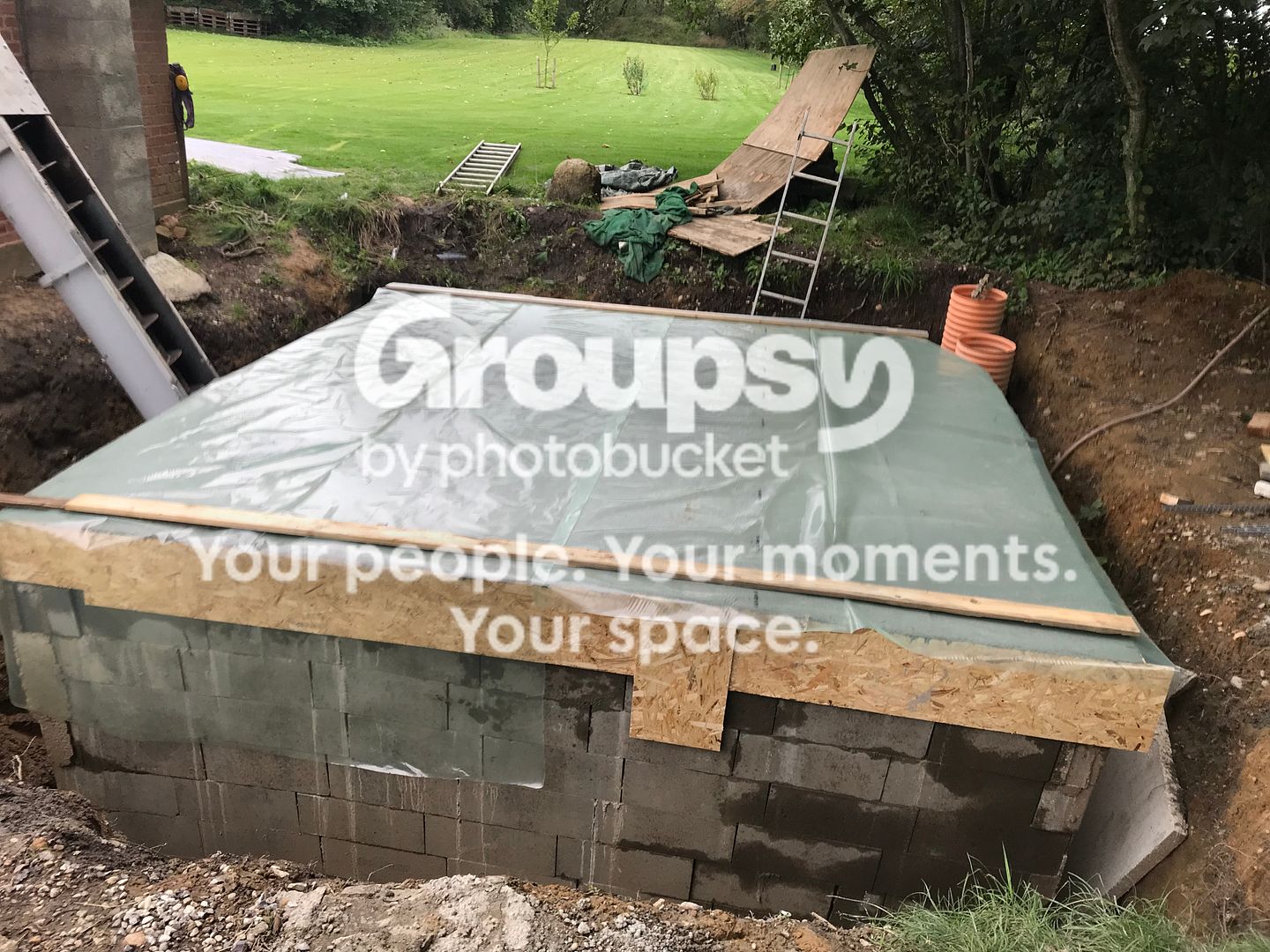

We decided to dig down 40-50cm. Maybe a bit overkill.
Last part. Only payment needed was a nice supper :)
Time to fill up the hole.
Not shown on picture: We put in between 10-15cm of stabile gravel. After this sand for the rest.
For every 5 cm(2inch), we stabilized it. Should have rented a ******** 2 times larger!
My father in law helped me out here. Not the first time :)
So stoked over the result. First time we ever tried it, and the result was great!

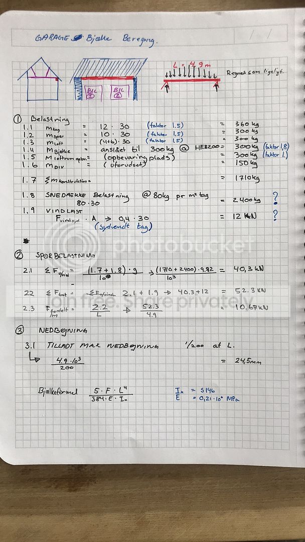

The plan with the 2car garage was to have more space when entering. This resulted in the pole in the middle of the garage had to go.

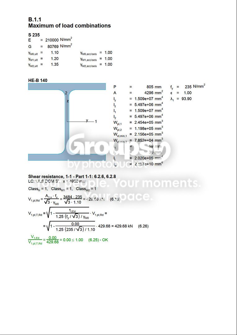

The beam have been swapped with a 140HEB. Calculations on this below.
I had to look up in some of my old books to start on the calculating again :bounce:

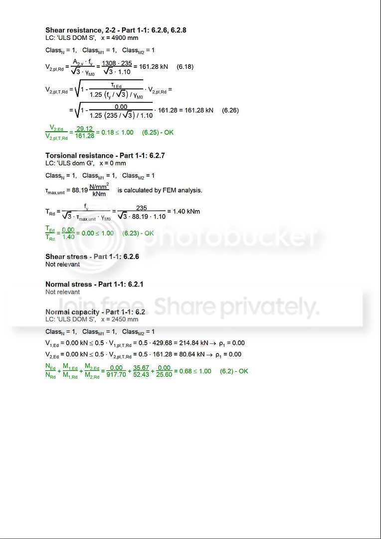

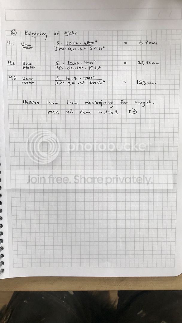

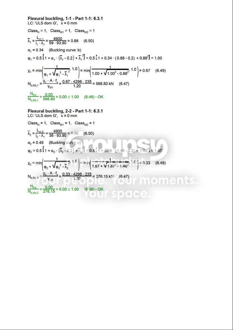

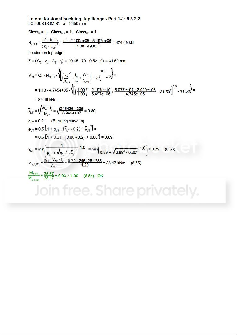

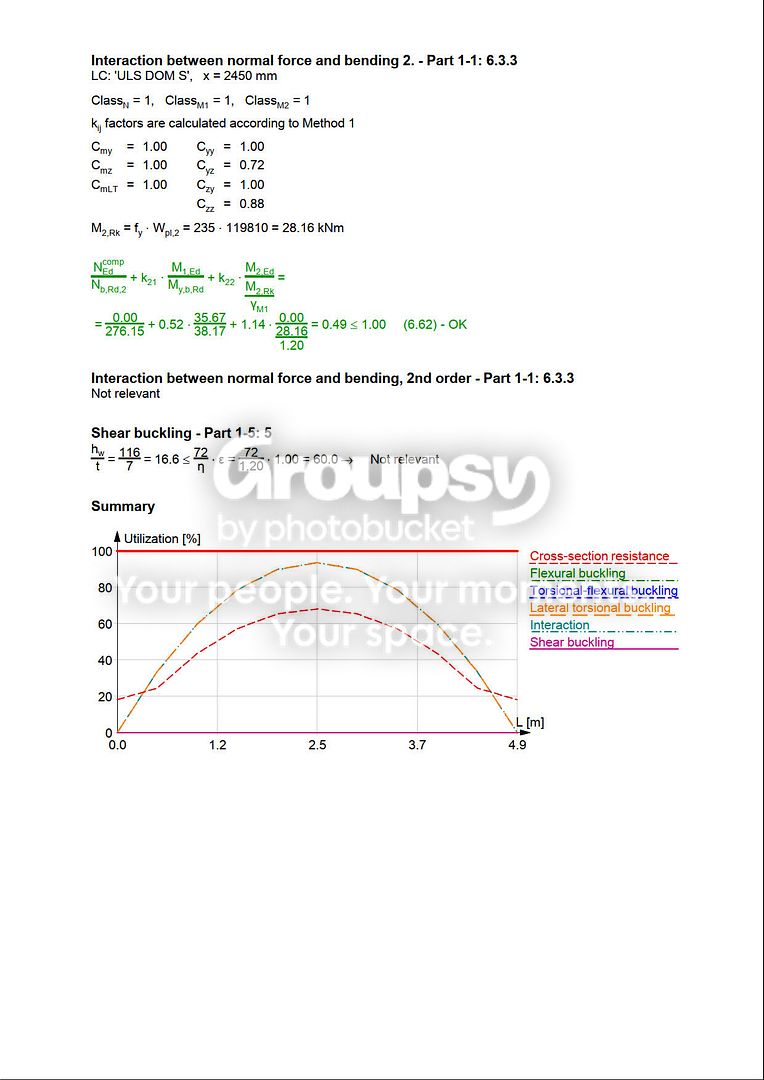

Woops. Forgot the calculations for the iron beam.
Here goes. Own calculations in Danish.
Sorry.
Same calculations made on computer
Buttomline is. It will never break.
I calculated with the standard snow pressure on roofing+wind at the same time (worst case)
+ a storage room with 300kg storage capacity.
Everything with a factor 1,5
With all these numbers, my calculations ended up at 25mm bend of the iron beam. Witch will never effect the structure of it.

Since last update, most sparetime have been consentrated on the woodpellet project.
Todo list:
  • Brickbuilding of walls (done)
  • Lots of reinforcement (Have not done calculations) (done and done)
  • Make the screw convoyer ready for "reverse" transportation (done, hope it works)
  • Fight the weather :) (Ohh,,,, yes,,, not done yet)
  • Build the top of the hole (done)
  • Install slanted walls inside the chamber (October)
  • Protect agains water from outside with plastic/asphalt (please feel free to come with ideas) (Maybe this year)
  • Test with woodpellets (November)
  • Fully commissioned (Year 2025?)
Most of the images, is taken by my wife, so will most likely come in an later update.
Finally a day without rain, time for brickbuilding :) 4. august
Getting there. 25. August
I know... It's messy when i'm working
Installing the scre convoyer. What a challange...
The tractor could not lift it high enough to get over the edge. Then when we got it in place, it was 3cm too long. The electro motor was hitting the roof. I had to disassembly the motor while stading on the roof. Good that I have handled over my HSE title on this project :)
The wood rafts is for carrying the plywood for doing the concrete slab on. These were supported many places underneath. I will see if I can get some images from the inside.
Note: Tractor on the edge :headscrat
Allready some water in the hole. 2. September
Not in the correct spot yet. Have to be lowered 20cm, and then I need to make a slide the pellets can slide into the 1150liter storage on the stove.
:dunno:
:dunno::dunno::dunno::dunno::dunno::dunno::dunno::dunno::dunno:
The concrete slab have now been made.
It is made in 2 layers of 10x10 reinforcement mesh (10cmx10cm) 8mm thick.
On top of this, there is 8 rows of 12mm reinforcement steel .
The concrete is between 8-10cm thick. and will be supported 2 places on the middel underneath.
I don't have any plans for how to "decorate" the top yet. Might make some Epoxy paint for a chessboard or similar.
